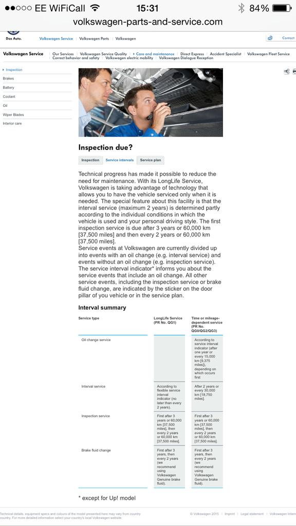

Offline bbfb10
  • Posts: 535
Re: What is a inspection service
« Reply #3 on: September 02, 2015, 03:32:18 pm »
@Chris92
Screenshot of the page. Hope that helps.
