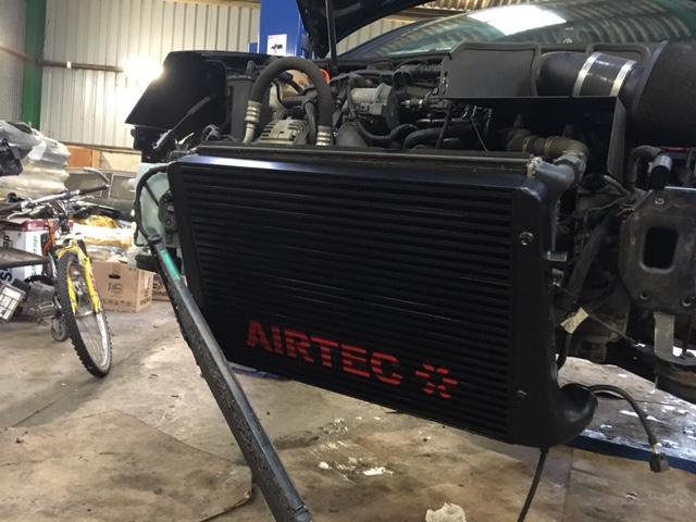

« Reply #24 on: January 12, 2016, 06:29:01 pm »
So this happened today  :pomppomp: :wink:

« Reply #26 on: January 13, 2016, 12:18:30 am »
Quick update on the air tec intercooler. Took the car for a long drive tonight and on my boost gauge once I hit 20 and above psi the car starts holding back and juddering  :confused: it start making an almost popping sound too as it hits 20psi with the boost gauge needle going all over the place.
Any ideas?? Over boost?? Boost leak??
I have scanned with VAG com before and after install and no faults appeared. I think it's a boost leak even thought we made sure the new hoses fitted tight.
Any help would be much appreciated.

« Reply #27 on: January 13, 2016, 07:34:48 am »
Impossible to say without data. A fault code scan won't help before you've been out and run the car
Sounds like either a misfire or perhaps fuel cut. Try logging boost and fuelling, check for misfires under load etc.

Again, need new logs whilst the issue is occurring to understand what the cause is. Logs taken when there was no fault/issue won't help
What map do you currently have? it sounds like a misfire to me - get the misfire counter open on VCDS and log it whilst replicating the issue. Have you changed both the plugs and coilpacks?
