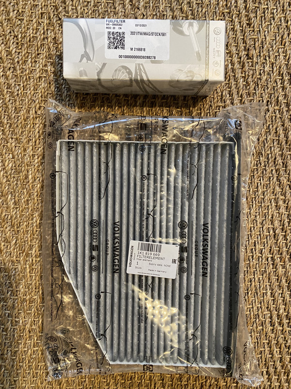

« Reply #139 on: December 24, 2021, 02:05:56 pm »
Fuel & cabinfilter also arrived

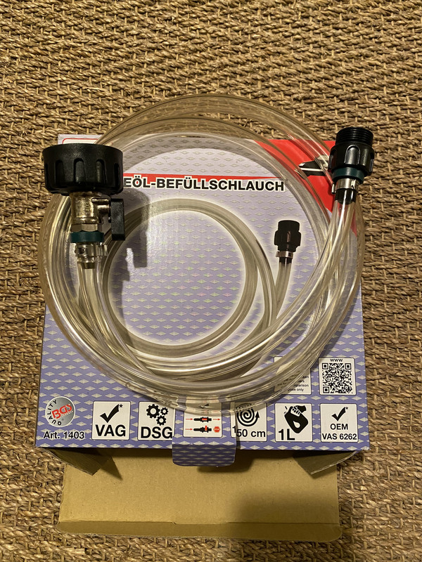

« Reply #140 on: December 27, 2021, 03:55:10 pm »
Also ordered a new DSG filling tube as I could not find my old one :thinking:
It will probably pop up when I’ve finished everything as usual… :doh:

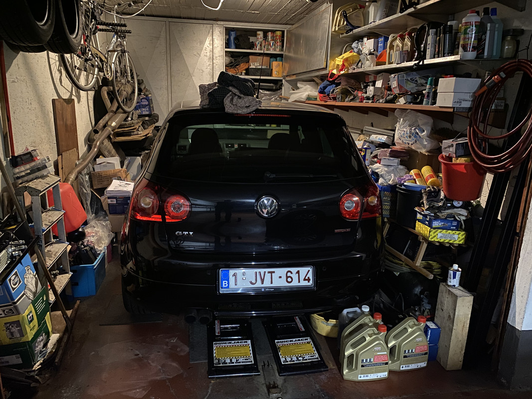

I think it’s time to get into action :confused:
Parts are almost taking over the garage :doh:
I hope I can remember everything…

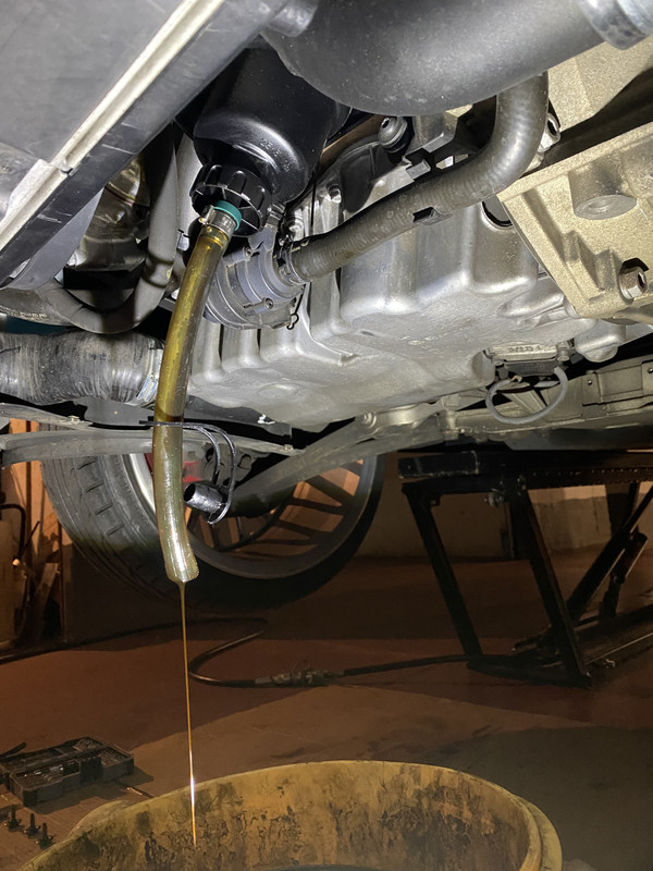

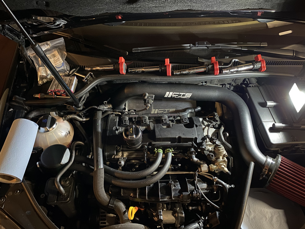

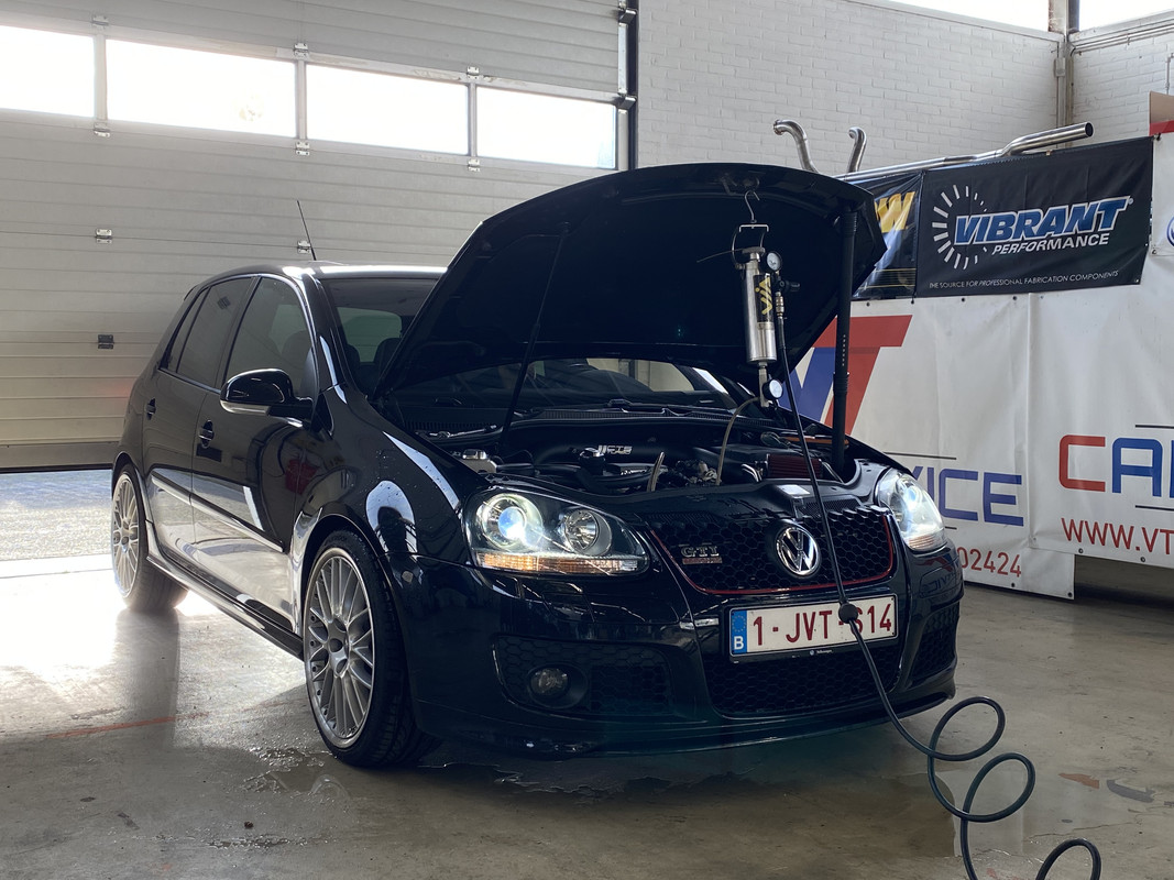

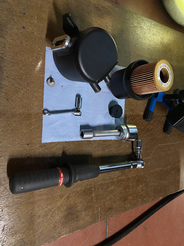

« Reply #142 on: January 20, 2022, 08:22:25 pm »

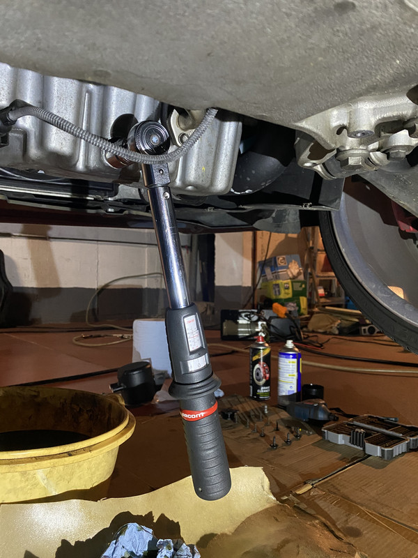

Went to clean the inlet manifold, inlet valves and injectors today…
Tomorrow… new oil & filter, new spark plugs & DSG oil & filter service :smiley:

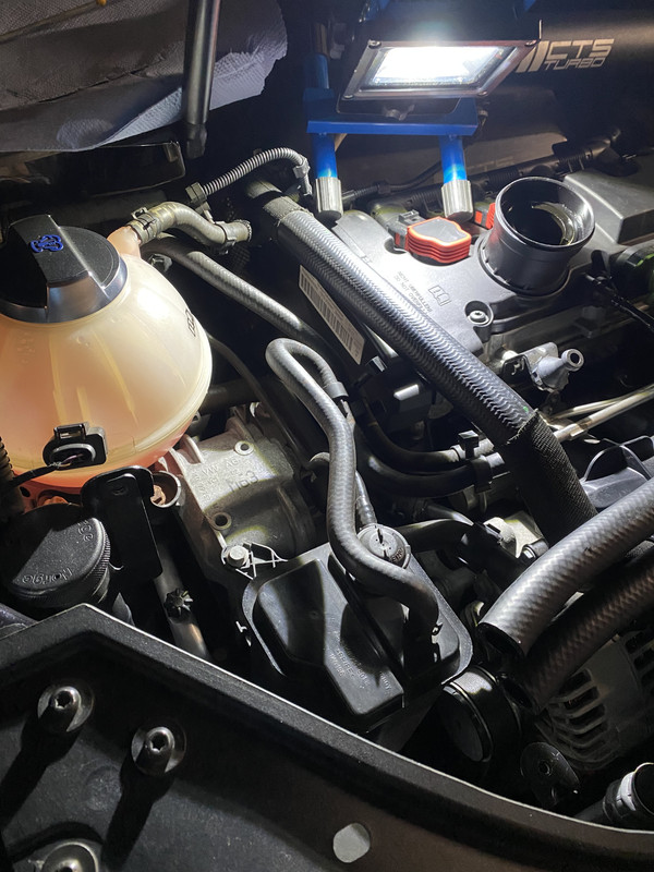

As promised…
Next up today… new spark plugs and cam follower check…. :happy2:

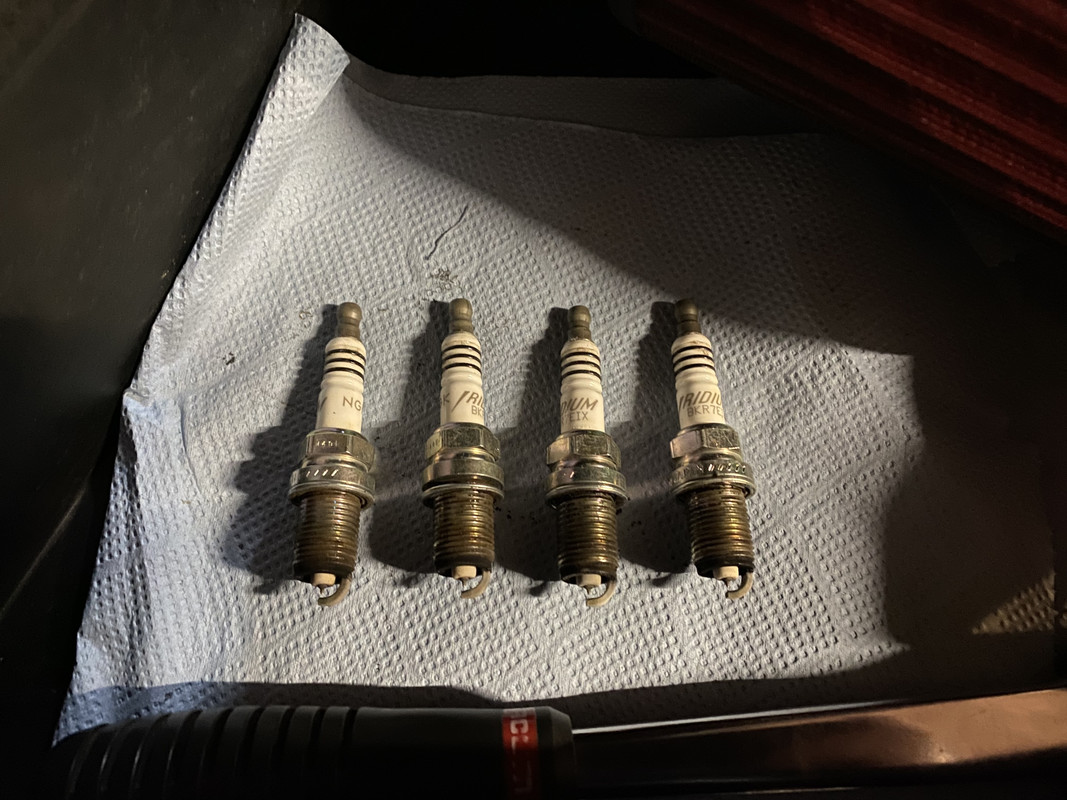

« Reply #146 on: January 23, 2022, 08:54:30 pm »
Spark plugs changed…
Old ones still looked good  :happy2:
Camfolower is next…
But family comes first  :drinking:😁
Will do it next weekend👍🏻

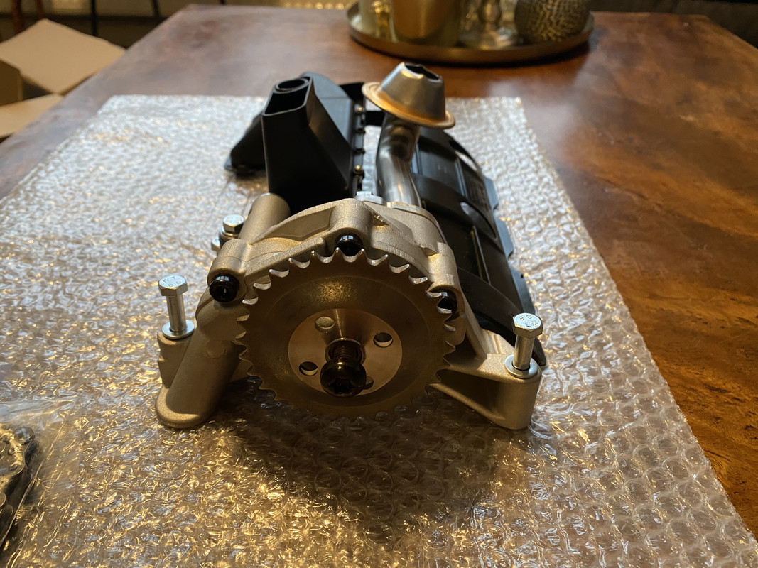

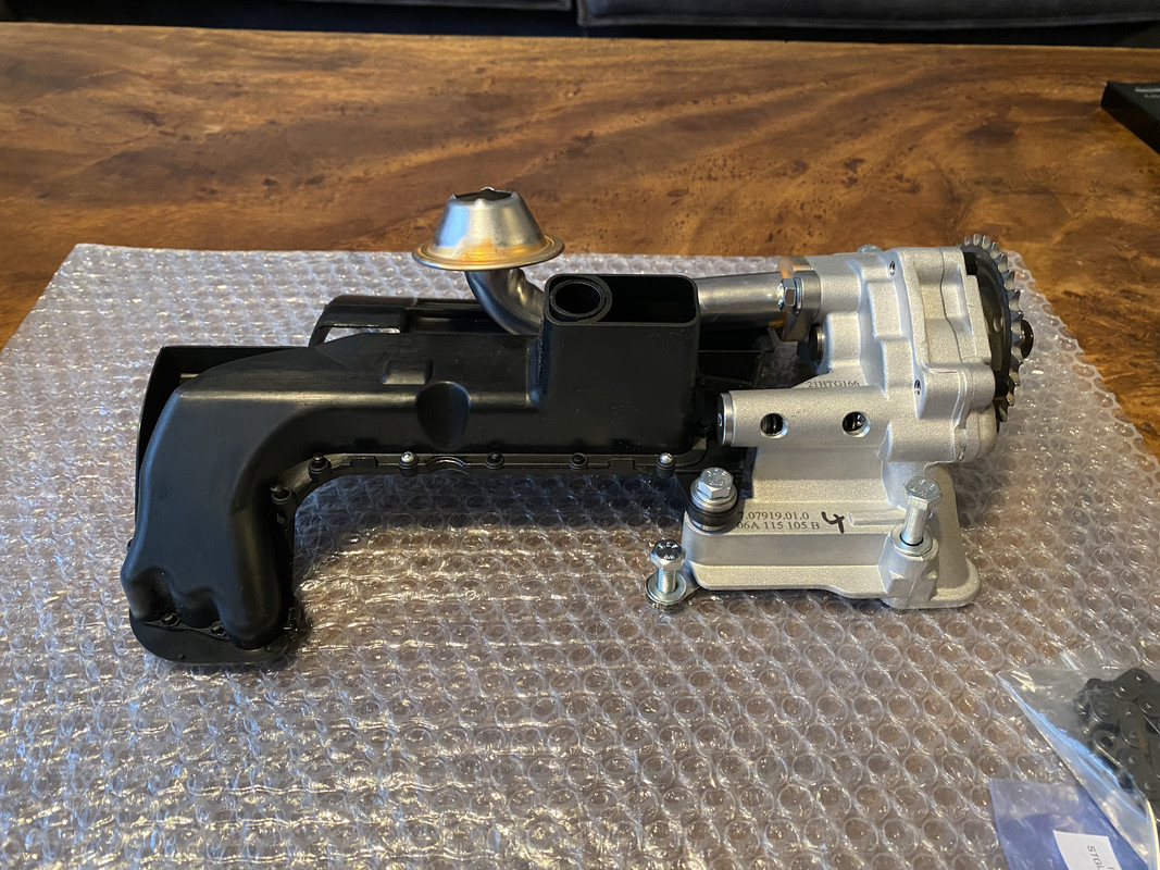

« Reply #147 on: January 27, 2022, 03:38:25 pm »
Allright  :jumpmove:
Got this delivered today….
All the parts…
Should look something like this when it’s installed…
I’ll keep you guys up to date when I’m installing this oilpump set up…
Next up will be the timingbelt change and the 2 thermostats….

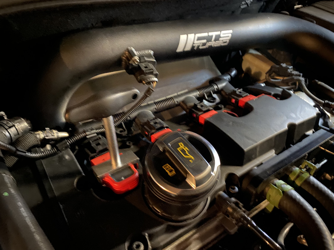

Also, the tube your oil cap mounts on is able to be removed... to reveal a lower oil cap thread - this is mine ripped off:
Looks so much better.
