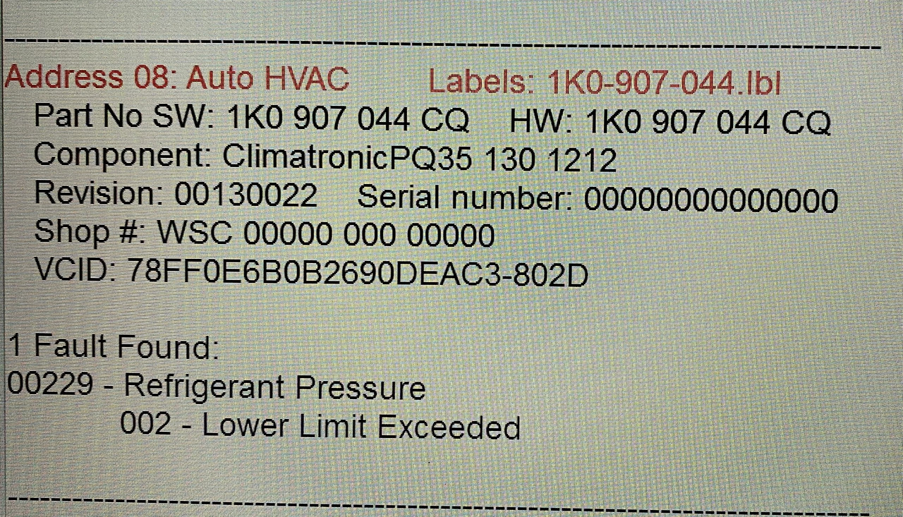

Also got a new A/C pressure switch with o ring, will install it hopefully friday. Got some troubles with my A/C.
Bagus helped me out with it :happy2: Went to get the system recharged but my compressor would not engage / turn on :surprised:
So friday after instaling the new switch, it's take 2 for the A/C...

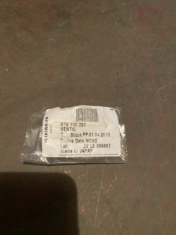

Also got a closer look on the pressure relieve valve under the intake manifold, to remove it for a RS4 one.
That's also going to be a pain to switch :thinking:

Here’s what VCDS shows for the A/C. Everything is ok and
system should be recharged

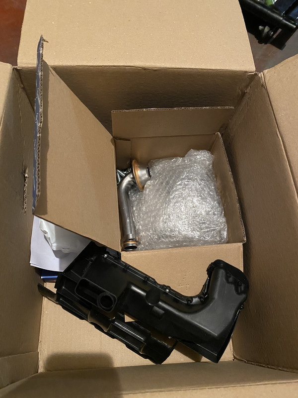

As for the oil pump I searched more info about it and after a good chat with an engine "doctor" , he told me that it was not nessecery but it couldn't do any harm to install it. Especialy with the TFSI engine! The balance shafts are known to fail... My first option was also the VIS balance shaft delete sproket  (I bought one) but then I got in contact with MIK Motoren and they got a whole oil pump conversion kit without having to drill in the oil shaft and the pump is set to 6.8 bar.

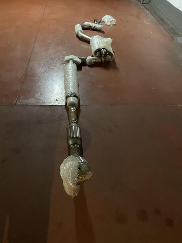

Now I’m having a dilema :
what size are the exhaust nuts which bolt on to the turbo?? Are they M8x1,25 or M10x1,25?
I got these N 102 861 08 I think they are M10?
After some research I think I need these N 911 308 01 (M8)??
I think my exhaust plans have been postponed… :sad1:

« Reply #171 on: April 01, 2022, 12:42:31 am »

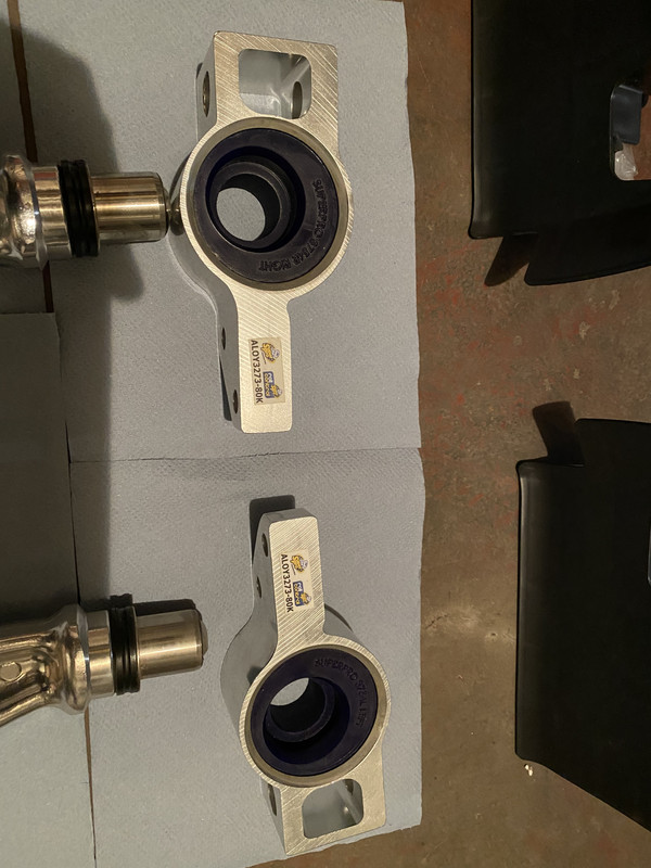

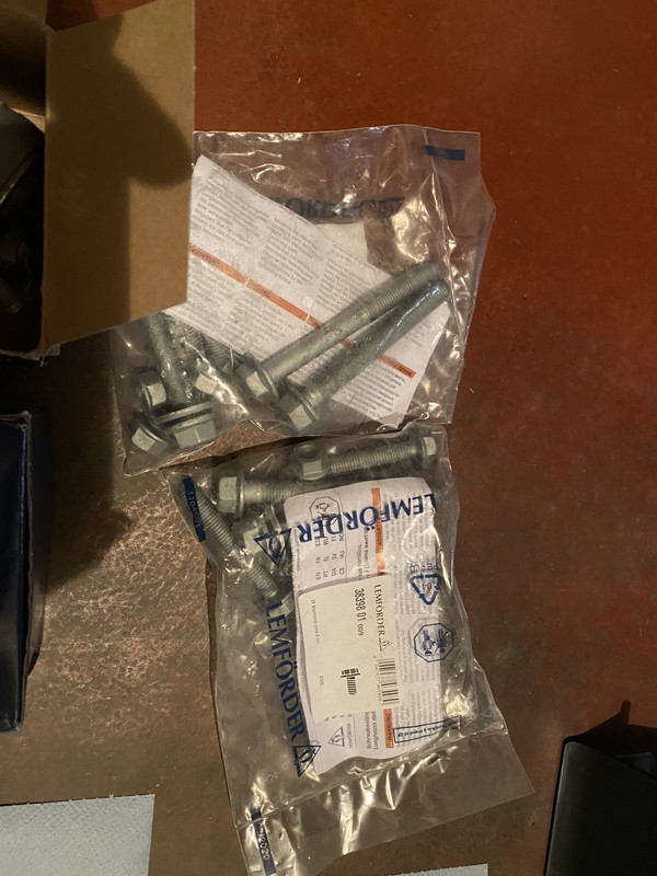

Also got these deliverd today…

« Reply #172 on: April 01, 2022, 01:51:51 am »
Thanks :happy2: will do my best! :love:
I think you need these for the turbo’s exhaust manifold: 5x N90894601. They’re M8.  :smiley:
Also this exhaust manifold gasket: 06F253039F.

« Reply #173 on: April 01, 2022, 02:07:09 am »
Thanks :happy2: Got the gasket already.  These nuts are from the manifold to the block?
I need the 4 from the turbo to the exhaust/cat direction. I think they are also M8?

« Reply #174 on: April 01, 2022, 08:12:53 am »
For the downpipe you need 4x N10286108. They’re M10. You have the correct ones. You can also fit new studs: 4x N0445203.  :smiley:

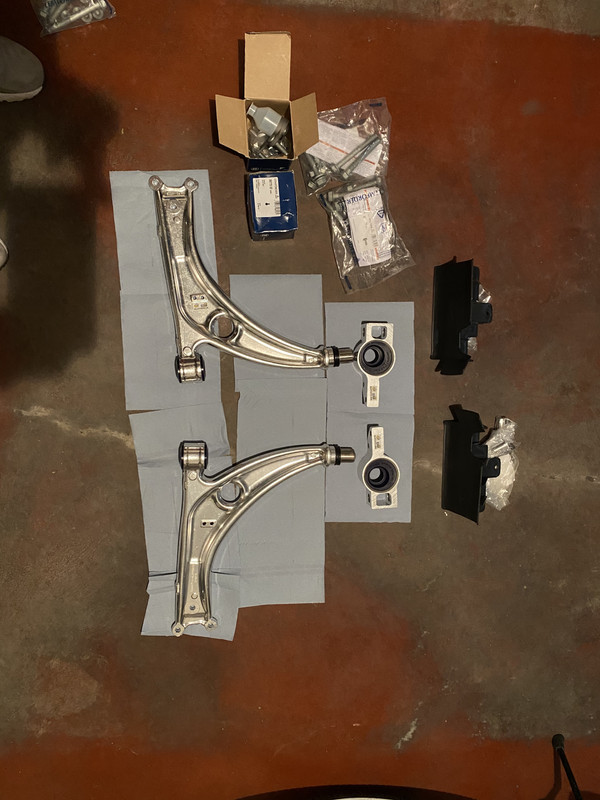

Now … I was in for a surprize yesterday evening when I came home…  :grin: wife & kiddo said they wanted to go on holiday to Valencia Spain for a week  :surprised: :stupid: so all of my plans for the weekend… in tha bin :confused: guess I’ll post some Valencia pics the next couple of days… :signLOL:
Offline RBS
  • -Receive: 49
  • Posts: 529
Re: Edition 30 powered by RBS

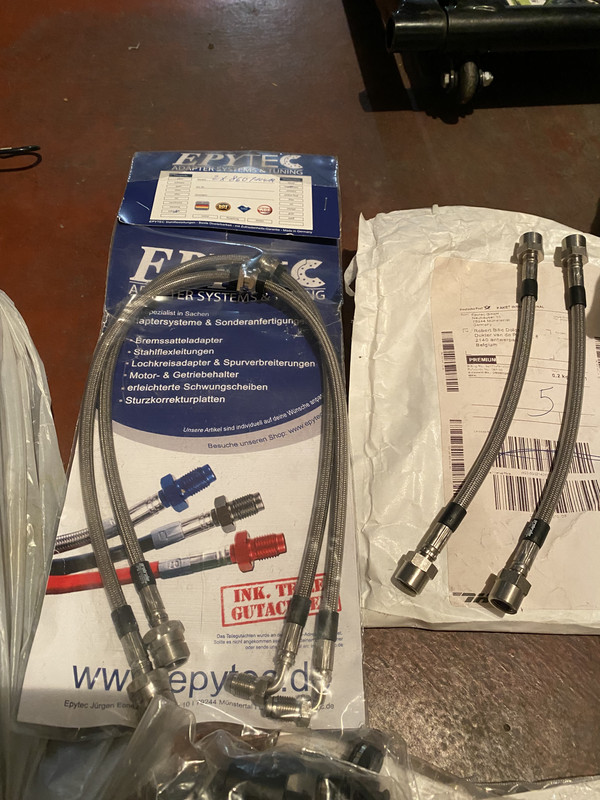

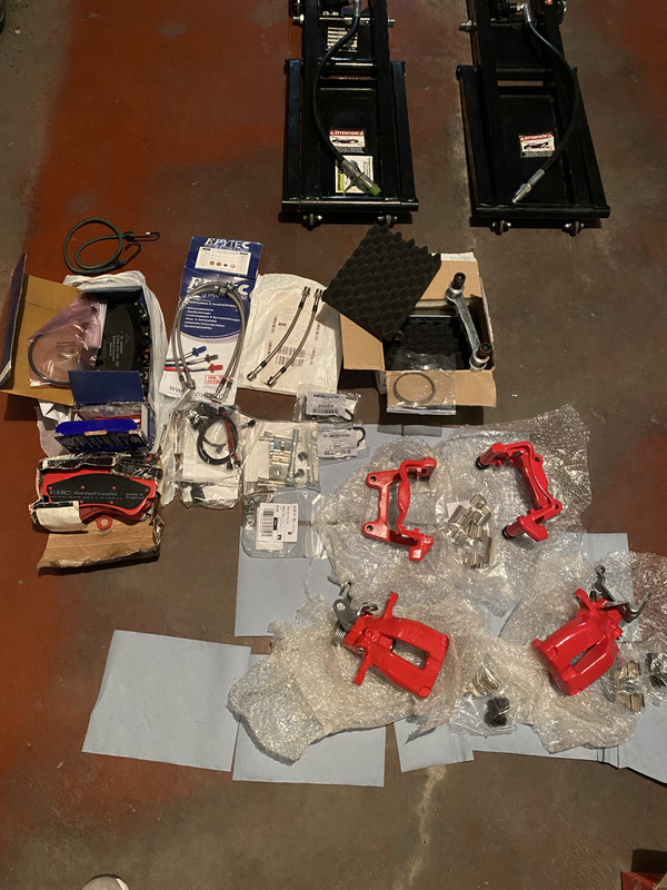

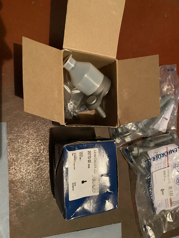

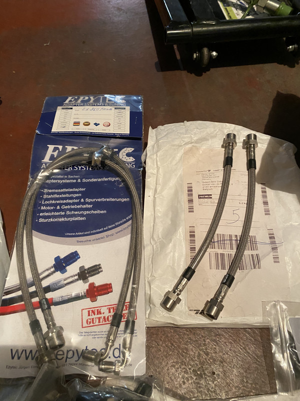

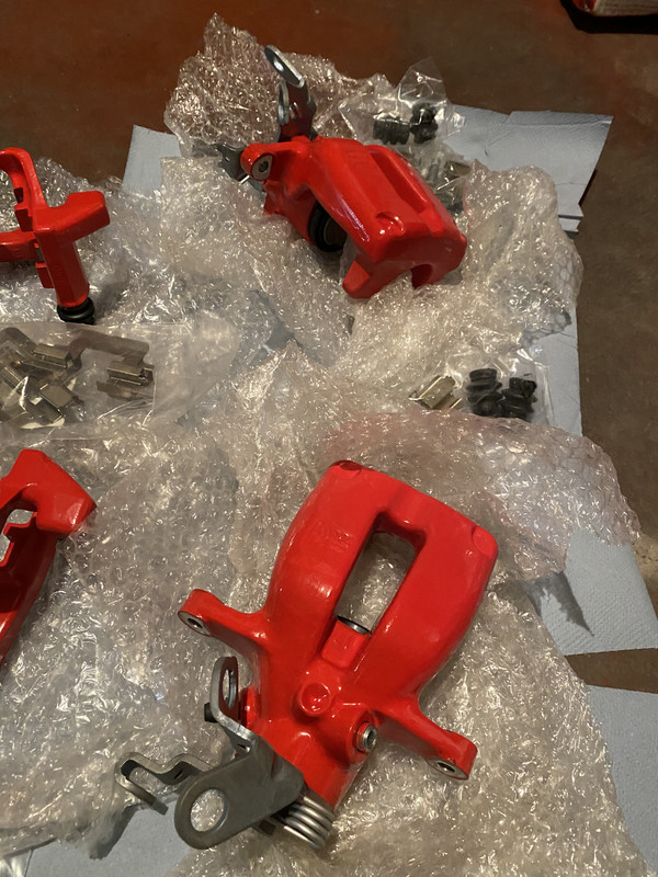

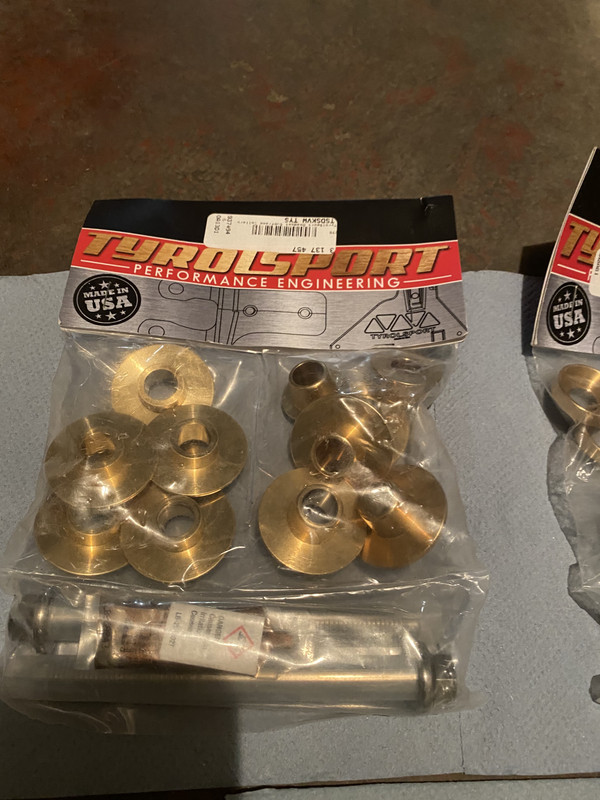

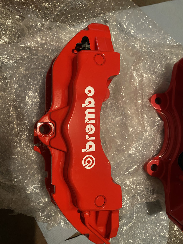

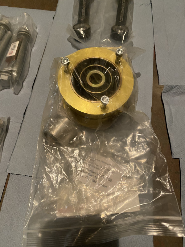

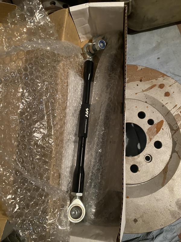

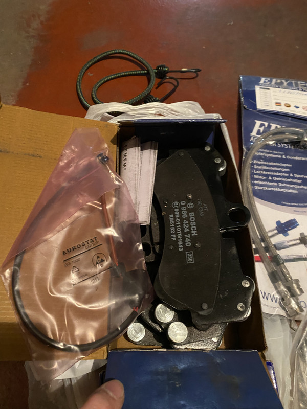

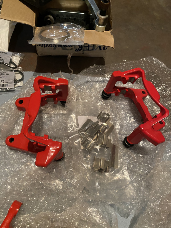

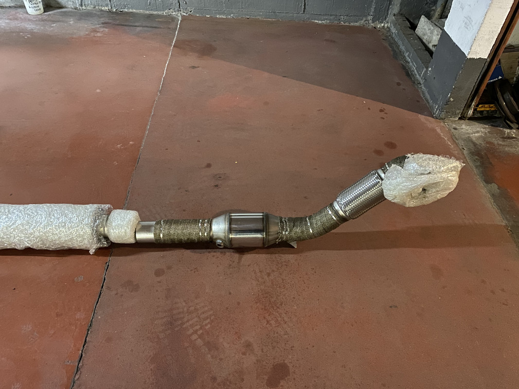

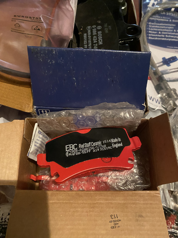

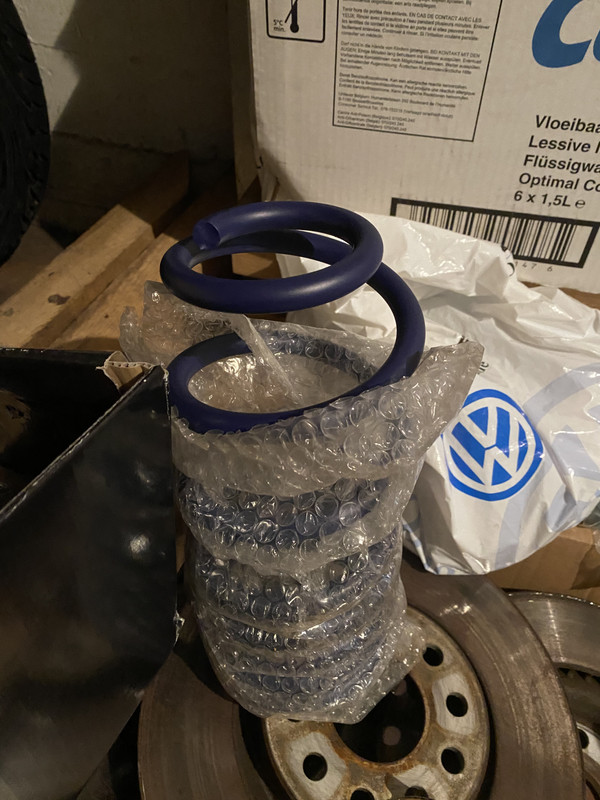

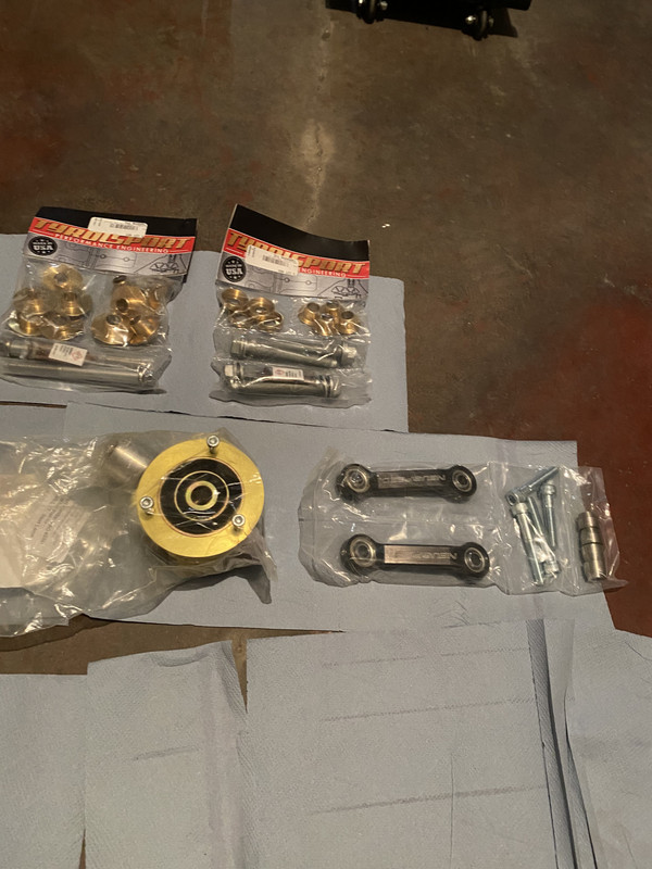

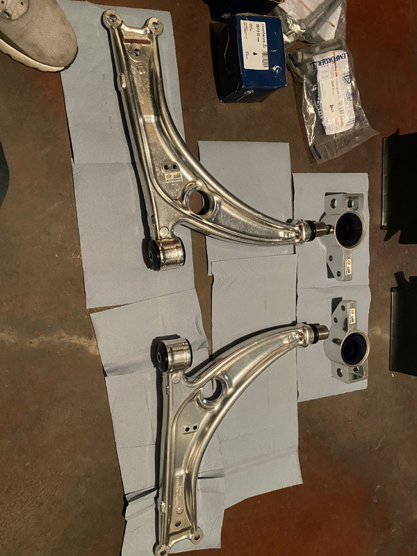

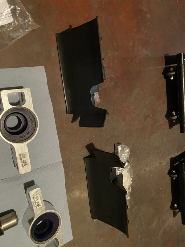

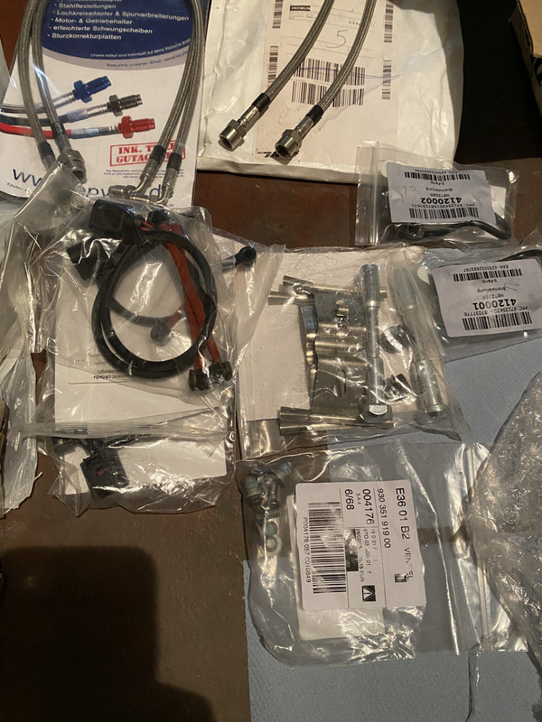

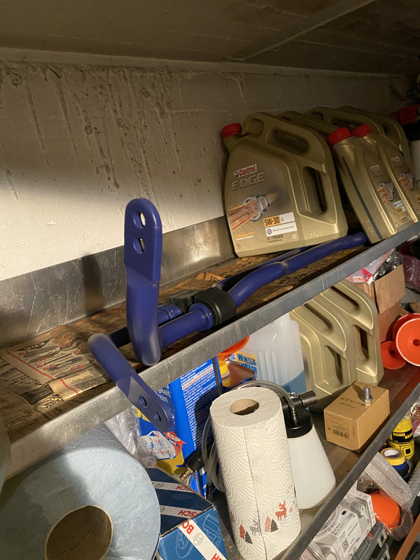

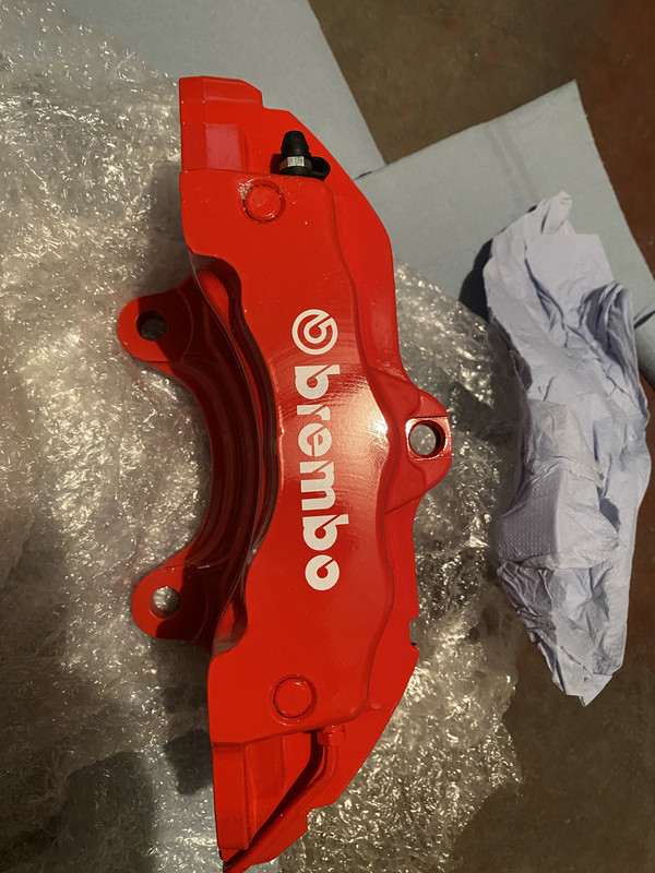

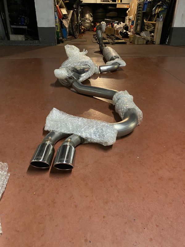

« Reply #179 on: April 02, 2022, 06:23:38 pm »
Went in the garage to give you all an insight of things to come in the next couple of weeks :wink:… ENJOY  :wink:
