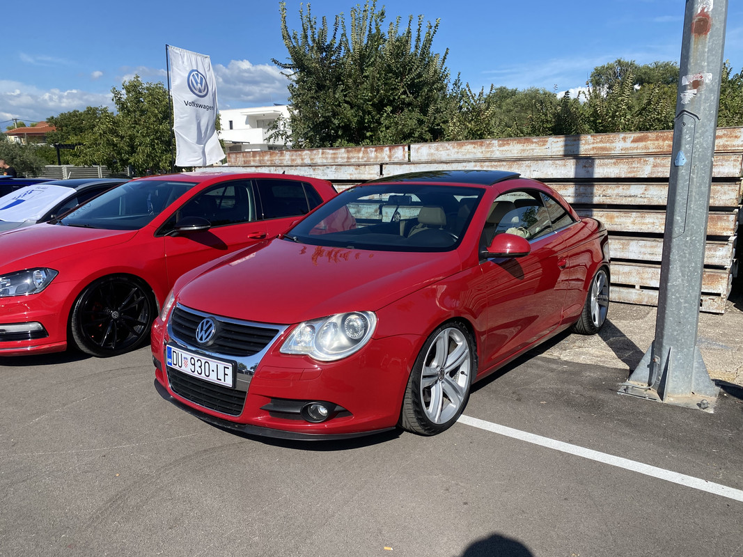

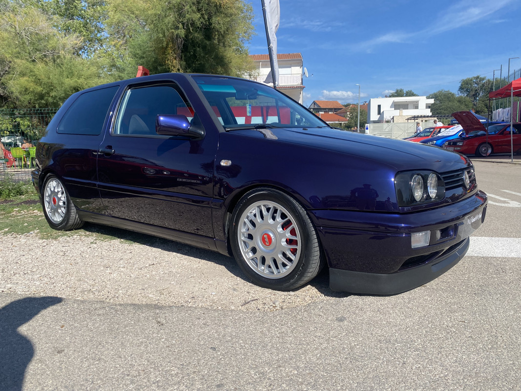

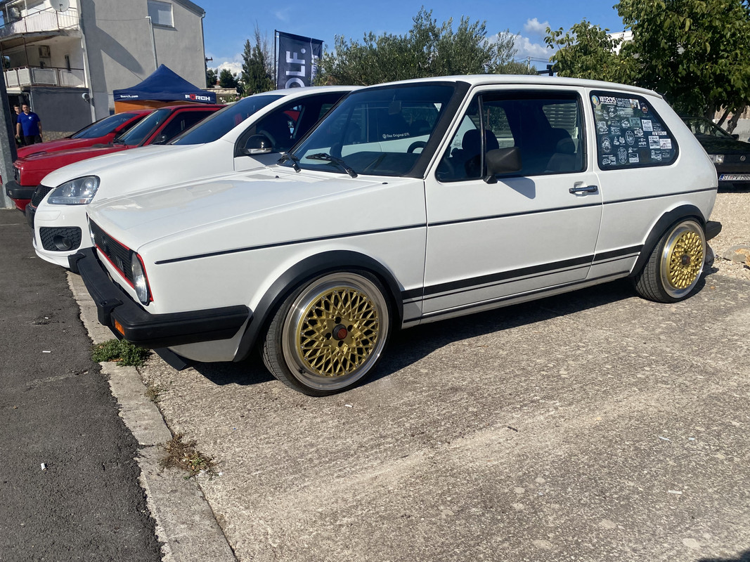

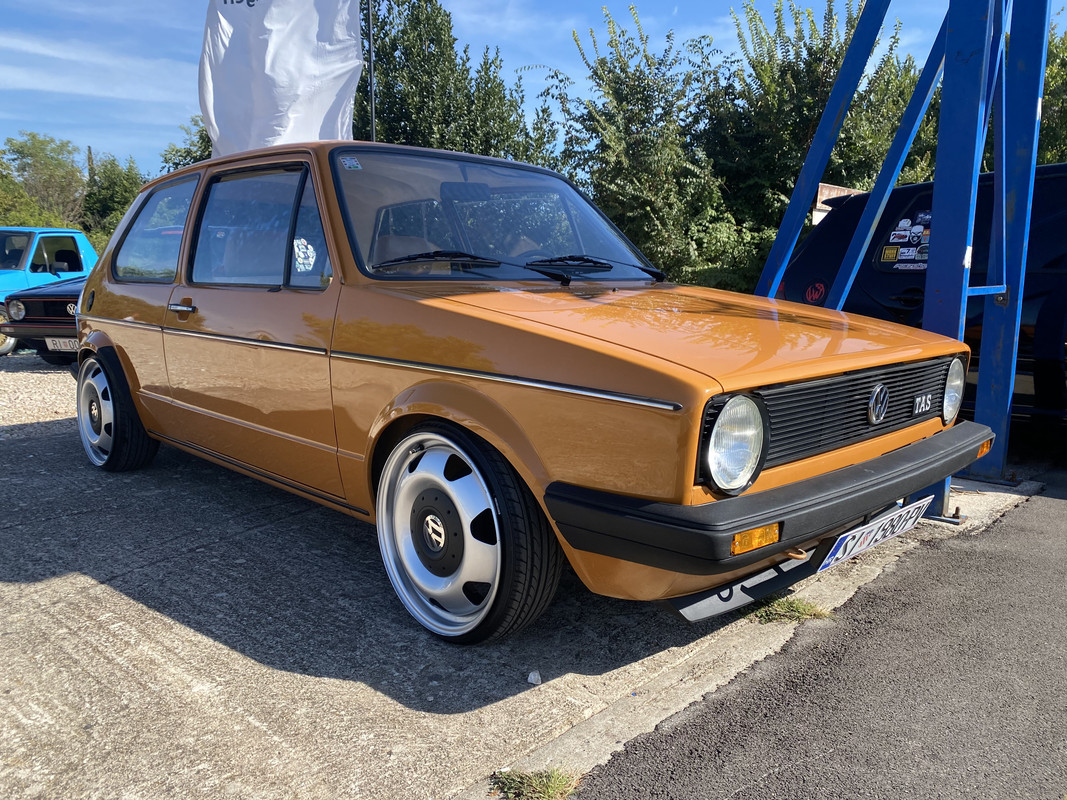

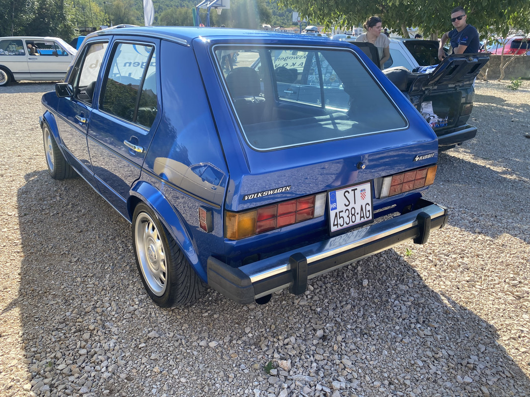

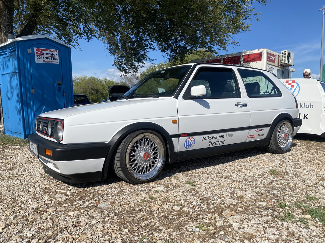

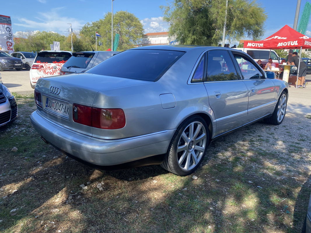

« Reply #299 on: September 13, 2025, 08:04:01 pm »
It was a nice day 😍…
