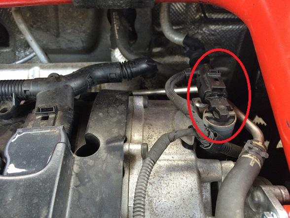

Can someone help me in identifying what this part is please and how much to replace as the connector has snapped as shown in the picture

camshaft adjustment valve N205
think this is the part number 06F109257C
http://www.partscats.info/volkswagen/en/?i=cat_vag_models&brand=vw&number=1714&set=1725&ein=2005&f=420&hauptgr=1234567890&hg=1&grf=010355420&bf=10355&hgug=103&ug=03&parent_id=2007824&detail_id=2007887
Nice one, cheers
Do you know what problems it would cause if this was not working as apart from the snapped connector which I glued back on I have not noticed any issues with the car

It's item 30 http://www.partscats.info/volkswagen/en/?i=cat_vag_models&brand=vw&number=1714&set=1728&ein=2007&f=474&hauptgr=1234567890&hg=9&grf=091940249&bf=91940&hgug=919&ug=19&parent_id=2361269&detail_id=2361295
Used to alter the camshaft timing!
You need the part number off the contractor/connection which you'll be able to buy just that bit!

Cheers so you think I could just replace the snapped connector which is fitted on the top of the valve and not have to replace the whole part. From my VCDS scan it seem it is not causing an issue at the moment maybe but by the state of the connector it will eventually go

Cheers but it is the connector attached to the actual valve that had snapped and I glued back on

Look here it's know as the N205 valve price one on eBay this is the how to http://workshop-manuals.com/volkswagen/golf-mk5/power_unit/4-cylinder_injection_engine_(2.0_l_engine_direct_injection)/engine_cylinder_head_valve_gear/valve_gear/removing_and_installing__inlet_camshaft_control_valve_1_n205/
Price for one I found https://jhmotorsports.com/shop/catalog/valve-or-solenoid-for-camshaft-adjustment-n205-oem-for-20t-fsi-b7-a4-gti-more-p-2471.html
Before I glued it back together I was getting the error the above link suggest as in
000010 - Camshaft Positioner (Bank 1 Intake) P000A - 008 - Slow Response
But after I glued it and re-scanned it went so will probably last until I can get a replacement
