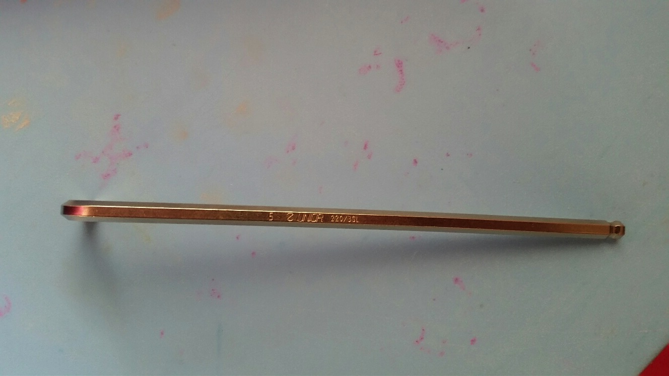

Will do mate, did you struggle to undo the two awkard bolts or where they reasonable?
No mate i bought this to get the awkward bolts out.

Er I had it done a month ago. Oil and filter. I asked them to check and he said it only needed a minor sevrice this year.
Ive bought some allen keys with a ball head on it and its quite long, probably 130mm long. Should be ok

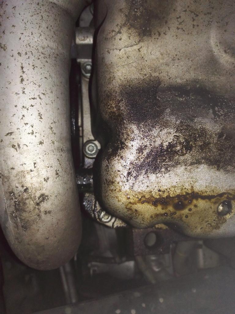

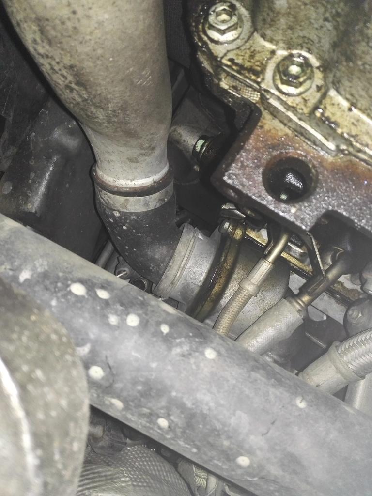

« Reply #52 on: February 28, 2016, 01:44:31 pm »
Bith photos looking up, first mainly of sump, with oil on it. Second looking at pipe (?) Above sump which looka like its dripping onto sump.
Could just be from where it was last changed but I doubt it. Oh well

« Reply #53 on: February 28, 2016, 02:52:42 pm »
Looks like oil just blowing from the boost pipes to me

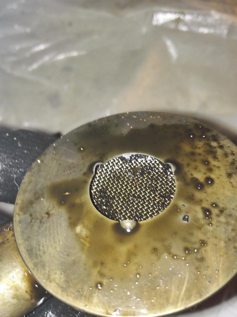

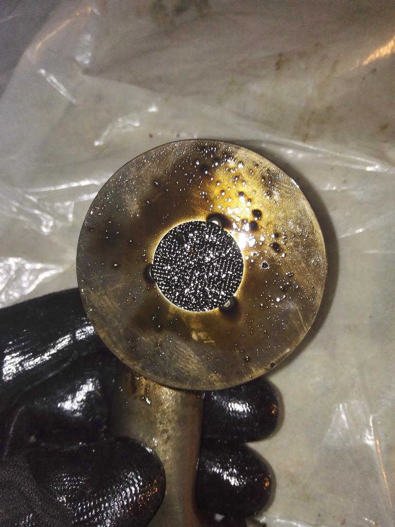

« Reply #56 on: February 28, 2016, 06:36:40 pm »
update
Have taken off sump and pick up pipe. The pick up pipe gauze doesnt actually look to blocked to me, but it may be.
I need to hand crank the crankshaft to see if the engine has seized. If the pick up pipe isnt blocked enough to starve the engine, im thinking it nay be one of the cams has skipped a tooth on the chain or something. Heres pics if the pick up pipe

That still doesn't look good as some of the crap has possibly dripped off the strainer?.
I think it's a 19mm spline socket to crank nut and try turn the engine.
