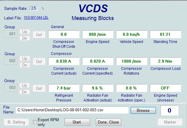

Offline lukemk5gti
  • -Given: 28
  • -Receive: 118
  • Posts: 1845
Re: How to fit G65 sensor?
« Reply #23 on: May 31, 2016, 08:13:50 pm »
Turned the engine on and scanned measuring blocks again and it shows compressor now running?
Screenshot:
Offline r5gtt
  • -Given: 342
  • -Receive: 334
  • Posts: 5586
« Reply #24 on: May 31, 2016, 08:18:30 pm »
Easiest way to check if it's working is pop the hood and check if the centre of the compressor rotating?, if yes compressor working. Then turn off ac and check and now it should not be rotating.
Offline lukemk5gti
  • -Given: 28
  • -Receive: 118
  • Posts: 1845
« Reply #25 on: May 31, 2016, 08:34:41 pm »
Very rookie question. Where is the compressor located? I thought it was half hidden under the passenger side cowling

Offline r5gtt
  • -Given: 342
  • -Receive: 334
  • Posts: 5586
« Reply #28 on: May 31, 2016, 08:47:52 pm »
Engine has to be running in order for ac to work. It's opposite the sensor you replaced  :signLOL:
Offline lukemk5gti
  • -Given: 28
  • -Receive: 118
  • Posts: 1845
« Reply #29 on: May 31, 2016, 08:52:16 pm »
Does engine have to be running though? Turned ignition over and fans were blowing.
Anyway. The engine is making so much noise that I can't hear the compressor rocking over! How else can I hear it?
Is changing the compressor a big job?
