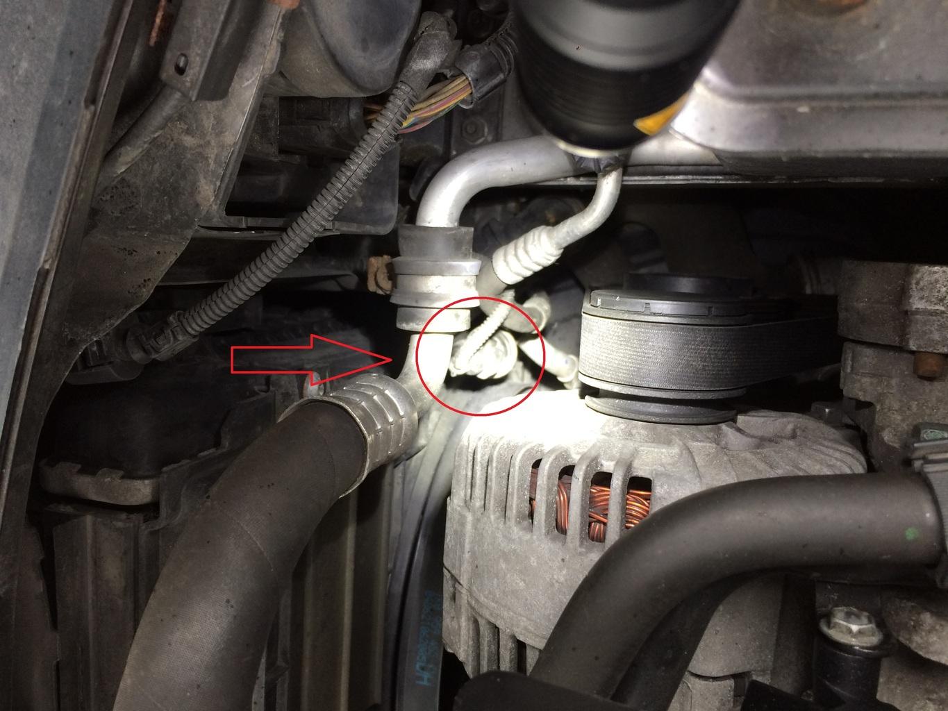

@rich83 could you tell me, is this the G65 sensor highlighted by the red circle I've put in?
That doesn't look too difficult to change, just twist counterclockwise?

That is the G65 @lukemk5gti
You will require a 17mm crows foot or something you can get down there with enough room to lever it. It's very tight down there let me tell you so better to buy the right tool for the job with a long 3/8 drive extension bar and rachet.
Hope that helps.

Re: How to fit G65 sensor?
« Reply #10 on: May 11, 2016, 05:47:13 pm »
Thats the f*cker
