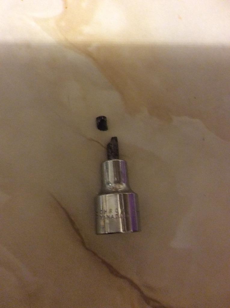

Thanks for your assistance, was even easier than expected! When undoing the top nut it backed against the driveshaft / cv joint and popped the ball joint down in the process  :pomppomp:
Have now successfully fitted this after sitting around for a year
Only casualty was my M6 triple square
