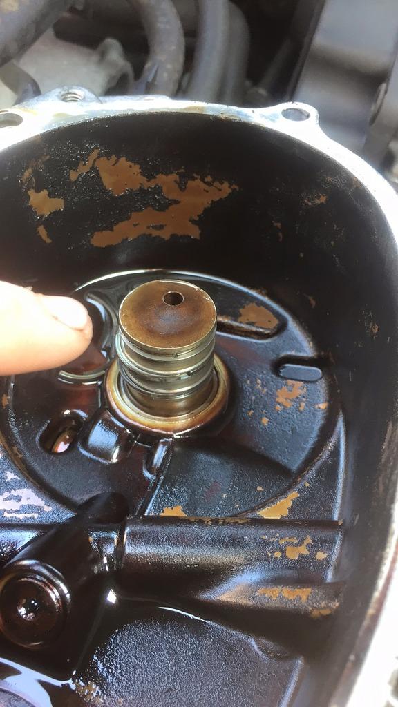

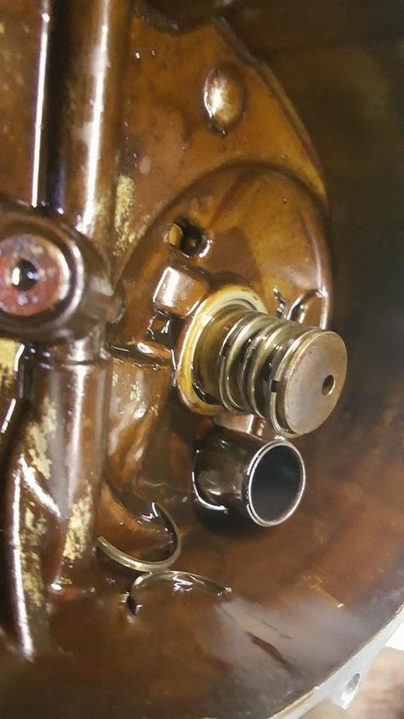

more problems today  :sad1: got the chain cover off to find the variable valve timing part that is in the cover had a shattered ring
rang tps and they want £360 for a new cover and say the part cant be bought separate  :stupid: after some internet research I found a vw part number 06f-198-107-a which I will be getting tomorrow hopefully these will fit, can anyone shed any light on this mine has the metal rings already not the plastic

It's from a golf, same as yours the cam follower is in the bottom of the casing which might be distracting you.
Interested to see how you get on. With regards to the new cover, vw do sell it separate but is only about £50 cheaper, but still included the n205 but not the cam adjuster which is worth a lot more than the £50 they knock off  :fighting:

That will be what that extra bit I can see is  :doh: yeah I was looking at buying it separate didn't no they done a kit and at 360+vat just for the end casing I'm not keen hence I'm trying just these new rings and hoping for the best as the cam adjuster doesn't have any ridges or anything so fingers crossed

Got then new rings today all the same apart from the ones on the car were metal and the new ones are plastic, I've fitted them and they all fitted fine so will get the rest of the car together tonight and fingers crossed it will be fine  :confused:

was this shattered ring the cause of the rattle ? or was it the chain then ?
Offline aaron92
  • Posts: 28
  • My Ride: http://www.mk5golfgti.co.uk/forum/index.php/topic,107138.0.html
Re: engine rattle chain
« Reply #13 on: June 11, 2016, 08:24:09 pm »
I would still say the chain was the rattle the rings are to small to even here I would suspect
