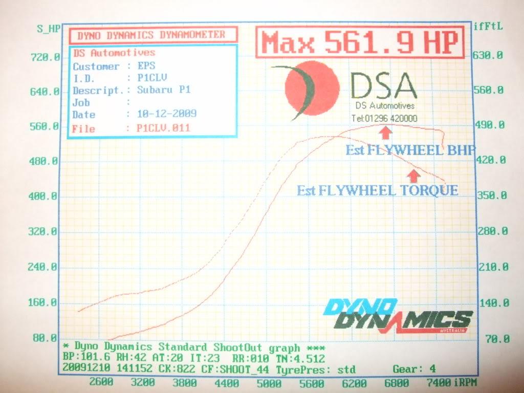

lower torque...but want power?
get a mismatched laggy as f'cuk turbo then!  :signLOL:
you should then get a plot like this..even though its a GT30 (0.82 housing) on a 2.0 Flat 4
or get a seperate boost controller to make it run lower boost at lower revs / gears...then get the fully monty higher revs / gears.
