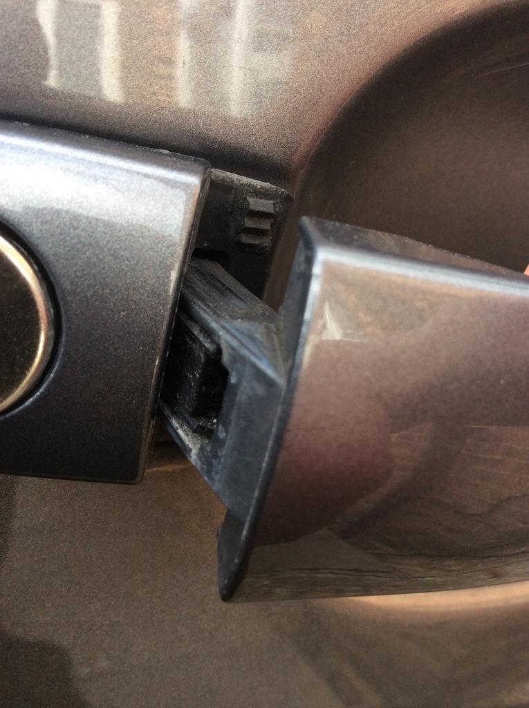

« Reply #3 on: July 11, 2016, 06:02:23 pm »
This bit in the pic.
Tricky but you will need to pull the outer handle about half way out roughly and use a small screwdriver to pop the cable / clip out and then open the door from inside then take out the lock cover out and re attach.

« Reply #5 on: July 11, 2016, 06:15:45 pm »
Many thanks mate
as soon as you mentioned the little cable
I opened the handle and released the cable so I could open the door and then readjusted the cable
sorted again many thanks :happy2:
