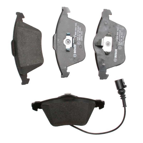

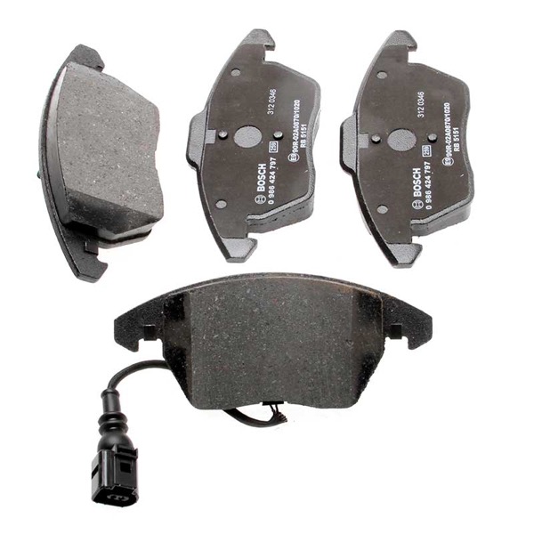

. Now I'm stuck. Have installed them, but the inner pad isn't sitting flush into the caliper at all. These pads also have a metal clip on outer pad, last set didn't.

Here are screens of the pads I have, and the other option available. Notice the difference in the ear shape.
Previous Shape:
What I've got:

Anyone have any ideas? Or does this just not matter? You'll notice the metal clip on the middle pad of the above photo. Could these be R32 pads, can't seem to find any information suggesting that there are two different pad options for a standard MK5 GTi caliper/brake setup. Bit stuck.
EDIT: On EuroCarParts when searching for R32 pads, there's extra information stating that pads are for disc diametter 345mm (R32 discs). However, when searching for the same part with a 2.0L GTi entered, it doesn't state it.

Looks like you ended up with R32 pads
+1

Thought so. Thanks for the confirmation. Will swap these out tomorrow.
