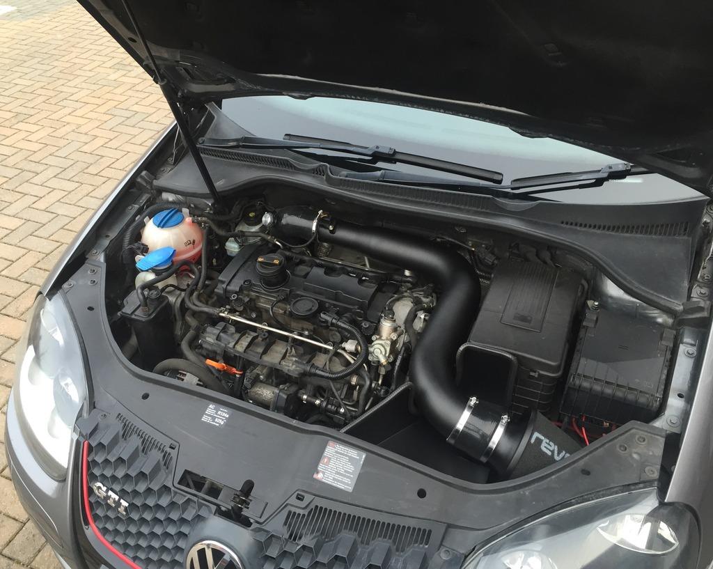

My Revo intake had arrived via TSR Bridgewater - Cheapest locally. (Nope, I do not use Lynx Africa.. yet  :signLOL:)
Fitted.

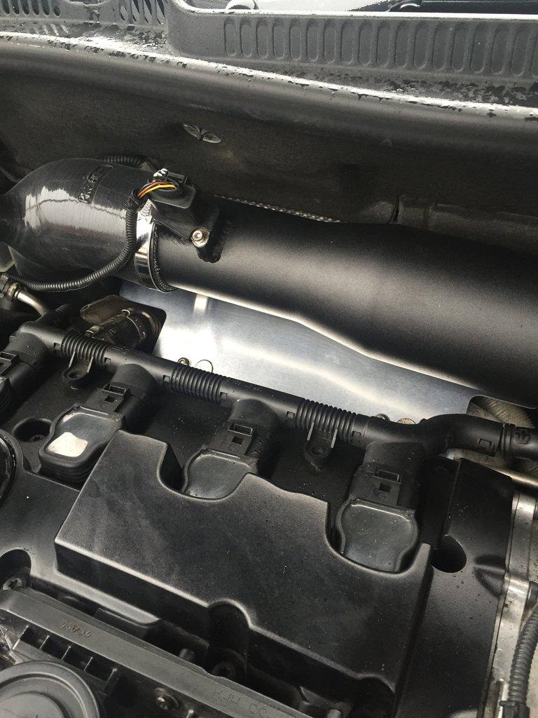

2) The heatshield required a nice polish up due to numerous marks, scratches and glue contaminates.
Fitted;
For what it is, I would definitely suggest one of these as an additional requirement of the Revo kit.

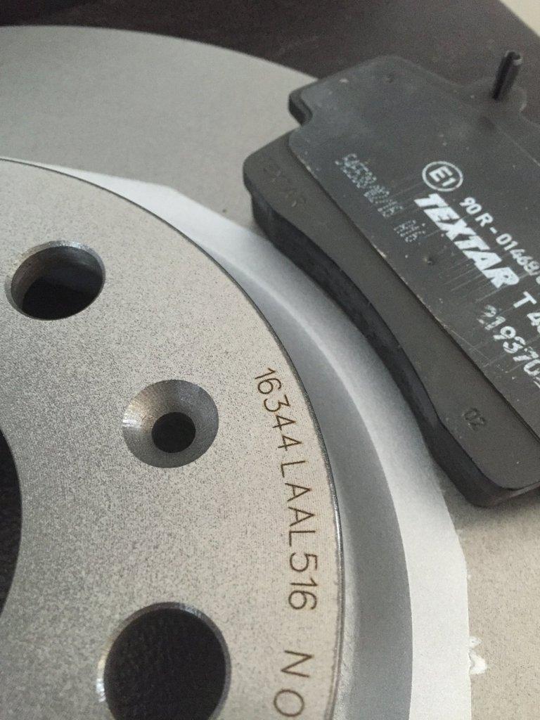

Sunday 31st July 2016 - Fitment of the NQSBBK, Superpro ALK, Superpro Wishbone Bushes and Revo Engine Mount Set  :smiley:
Prior to fitting, I'd applied some VHT paint to the centre of the discs (ideally, 7mm off centre) to help prevent getting a 'Rusty Ring'  :booty:
Kit all mocked up;
I'd opted for Brembo Discs and Textar pads - This being as I like the brands and being a road car, a harder setup isn't really required for me.
All fitted;
