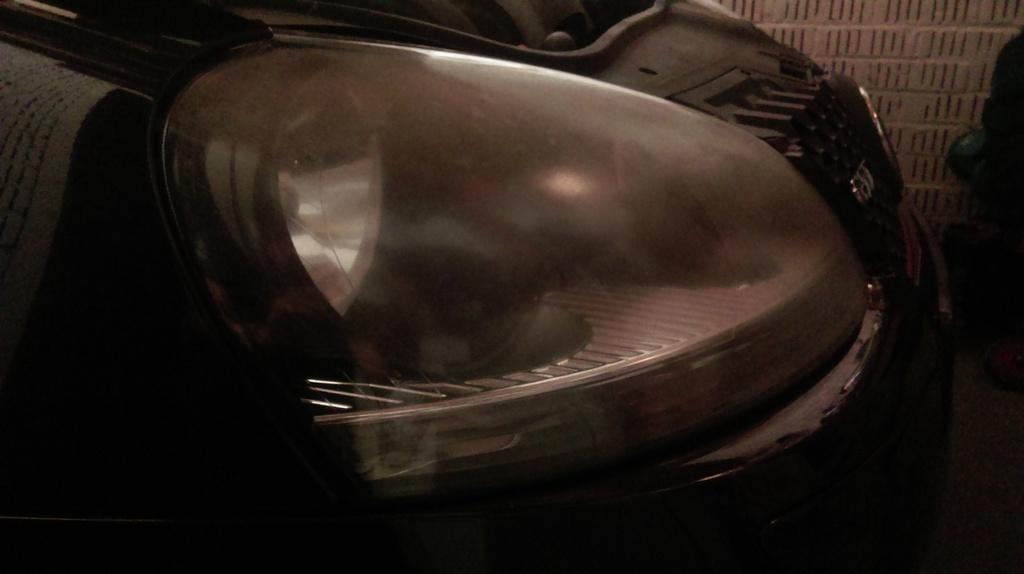

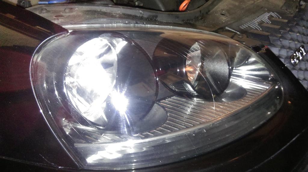

Gave the headlights a tidy up. 1000,1200,1500,2000,2500 grit then polish with the 3M compound. Came out good.
How they started:
During:
Done:

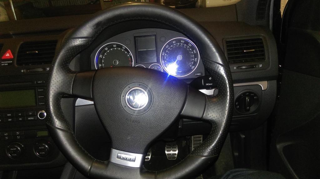

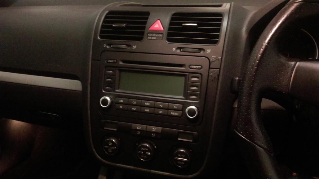

Plus few bits tidied up inside, dash had parrot kit fitted so removed that plus cleaned dash up and gave the steering wheel a clean with the magic eraser.
Before:
After:
Before:
After:
Taking kit out:
A lot of it, looks a well made kit, all fitted into headunit etc:
Cleaned sticky pads residue off:

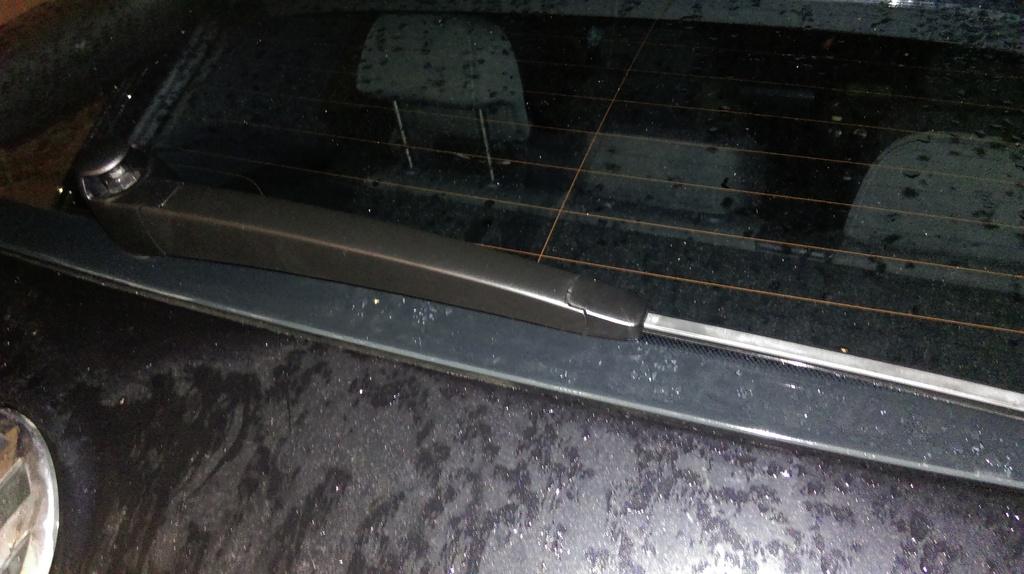

Rear wiper broke:
Ordered a new one up from TPS and fitted that night. Plus ordered new nut and cap too:
