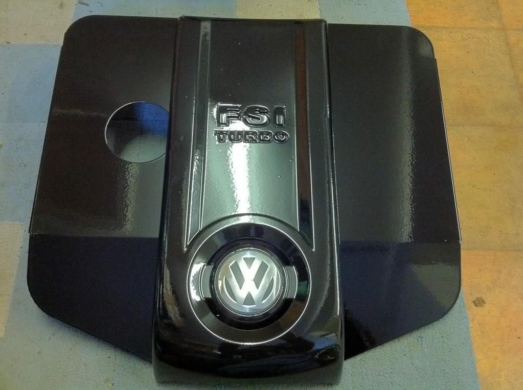

I decided to enlarge the 'U' so absolutely nothing touches rather than fiddle around with doctoring grommets. I've left VWR's cable conduit protection on as well but there's now at least 4mm clearance all around and no movement.
Job done!

A further cosmetic mod is happening to my engine cover and should be ready later this month  :party:

Making the centre strips interchangeable could be tricky but that's not saying it can't be done.
Basically the Evoms flat aluminium cover has to be cut/drilled to receive the 4 short 'legs' of the centre strip. On the plastic oem filter box cover it all spring slots together but here the materials are now different. If it's not a super tight fit, the centre strip will begin to rattle and so I've used rubbery black Tiger Seal quite generously. It'll be interesting to see how you solve it.

You'll probably notice this anyway, but the centre strip doesn't fit exactly central on the Evoms - It has to allow for the oil filler cap. If you look closely at mine you'll see it's off centre but my version of the Evoms has a front which places it for you, Nathan's doesn't but it shouldn't be a problem.
