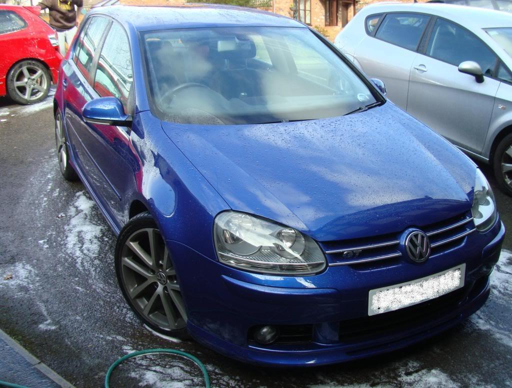

Front view:
Side view:

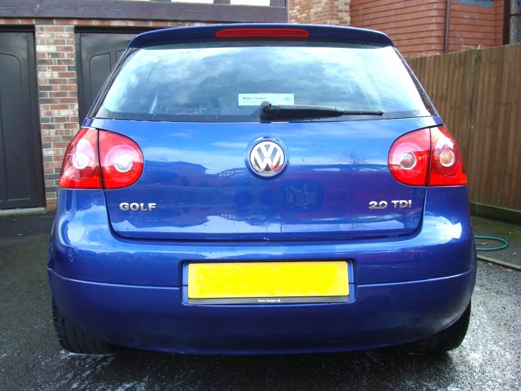

Rear view at the mo...
Will hopefully look better in a week or so!
