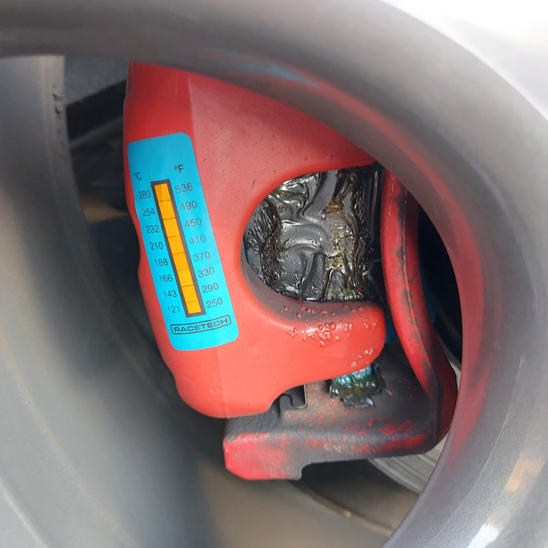

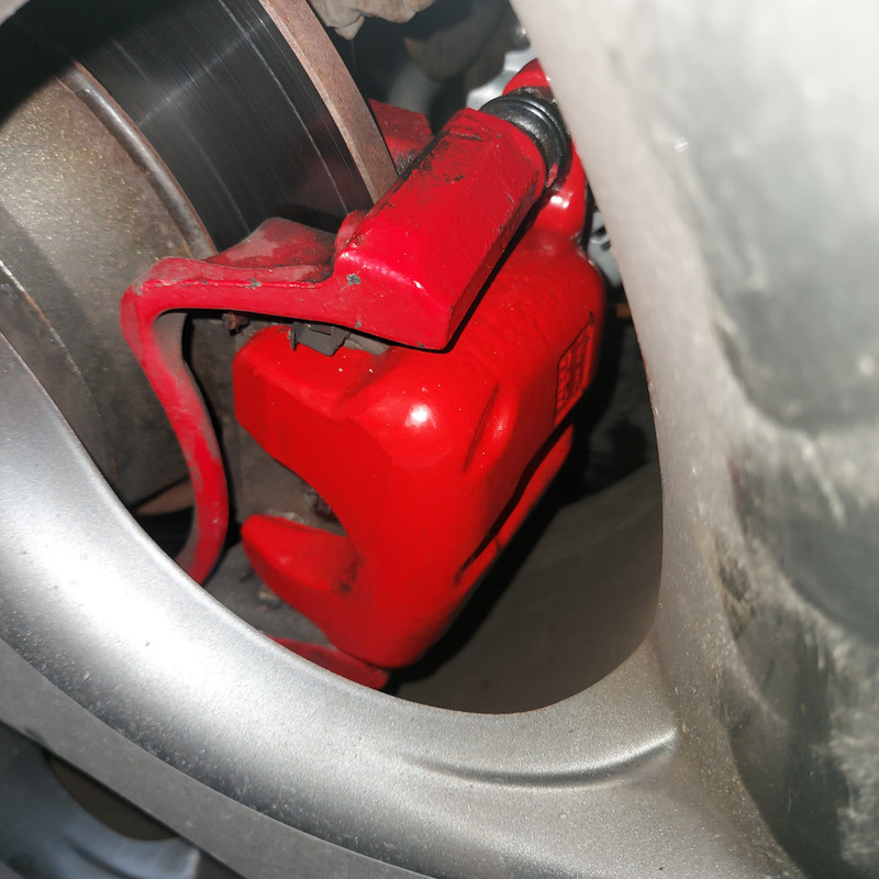

Just got them delivered today and just finished fitting. Got the bigger 41mm set up as well. Few little gripes like they painted over some threads making screwing in the hard line tricky and one of the handbrake levers is not quite in the right position so does not have as much pressure on the handbrake cable as it should but seems to work OK, tbh for 125 quid cannot complain and their customer service was spot on.
One of the guide pin boots did split while installing but I doubt it's a major issue in the next 200 miles that I need it for.
The sticky calipers do explain alot mind... why I've always felt this odd sensation in the rear of the car when under high lateral load on track, I always thought it was an over sensitive stability control scaring the life out of me but I bet it was these sticky calipers after all!

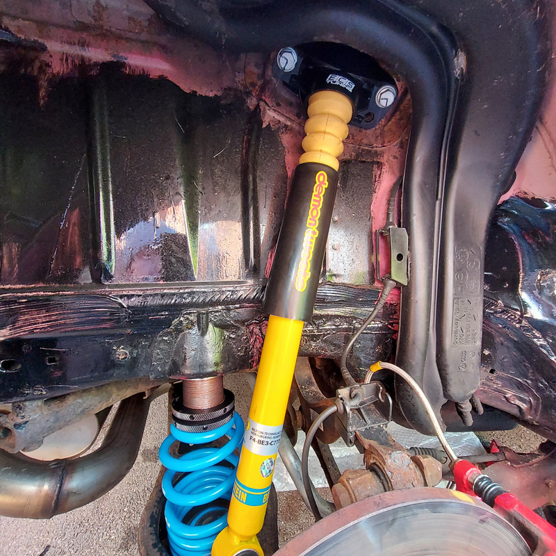

Been real busy lately so only managed one corner and as I forgot to tighten up the top mounts  effectively did the same corner twice :doh: Fronts been a pain and required a bit of angle grinding, another reason such slow progress.
NS2R's turned up this week also, aks tuning seem to be selling them at 95 quid each when everyone else is doing 115 each so thought I'd take advantage of what I guess is older cheaper stock before the price goes up like everyone else.

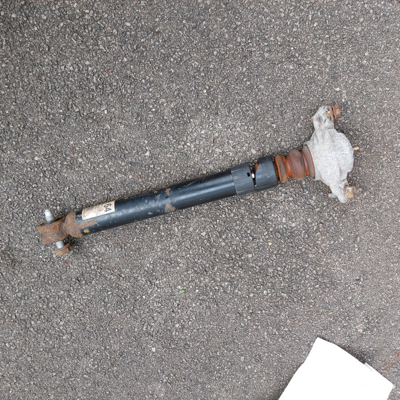

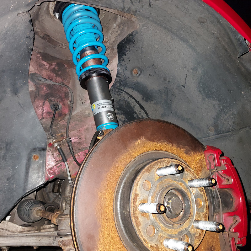

So coilovers now on. Not driven yet as brakes need a fluid flush, waiting on delivery of a few items (including a new 1 man brake bleeder).
Not sorted ride height out properly, it's super low right now but will just let the shop work it out when it goes in for corner weighting.

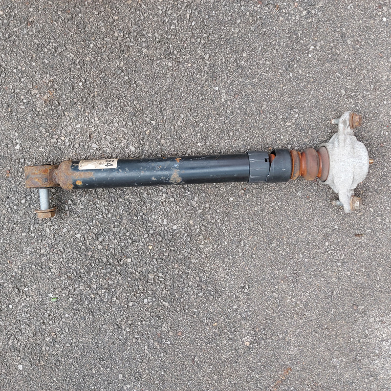

Here is the old rear dampers, fully compressed (without struggle by hand) and the 2nd picture is several hours later... it rebounded an inch. Shows how dead they really were! Fronts actually did rebound but still not much resistance at all.

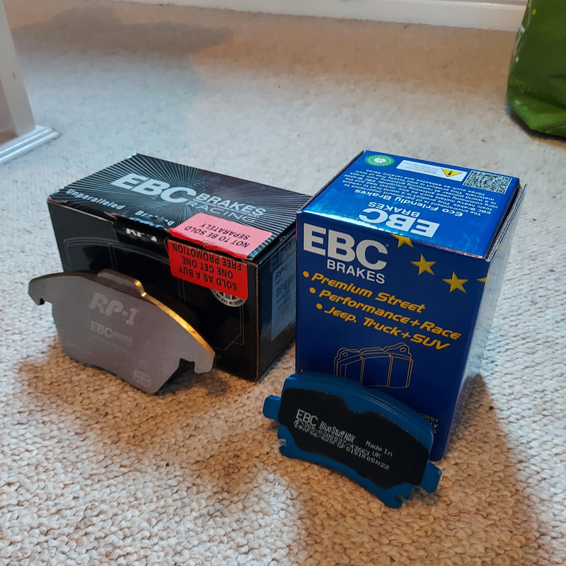

Couple new goodies.
Sunstrip applied, not the 1st attempt, a gust of wind took the first go :grin:
New front and rear pads ready to go on:
New race gloves and VP Racing fuel containers:
Did a brake flush other day (still not great pedal feel but safe for the roads for now) so could actually test drive. It is a night and day difference than the worn out oem setup, huge amount more grip.
