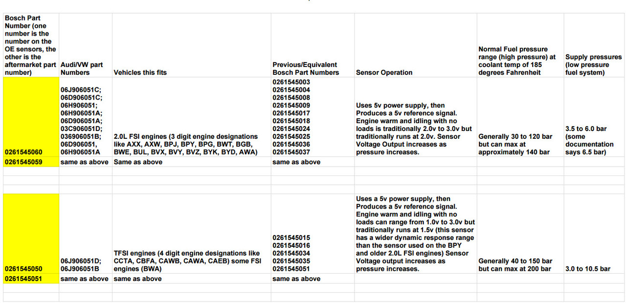

Does anyone have a part number for the 200bar Fuel Rail Pressure Sensor ?
High Pressure Sensors are here; https://www.ecstuning.com/Volkswagen-Golf_V--2.0T/Engine/Fuel/Sensor/
If 2007 or later...it may already have the correct G247 (high pressure sensor). Mine is early 2007 and did come with the higher pressure sensor and never required anything else. Forget the third column. This list is a Bosch cross-reference list and they did not accuratley know which VW were installing. And because you can see; mine is the BPY and my G247 was not those listed for it. My G247 was listed below with the higher limit sensors. Remember this is an old list and newer revisions may be available. Here is a list of Bosch G247 sensors and their pressure limits. I believe the latest G247 with higher limit is 06J 906 054 B...not on the list except for the ...051 B is now ...054 B. You can read the part number on the current sensor and check this list for its limits;
« Last Edit: February 21, 2021, 04:23:48 am by ROH ECHT »
