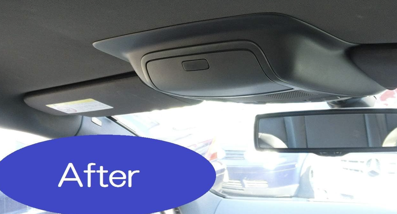

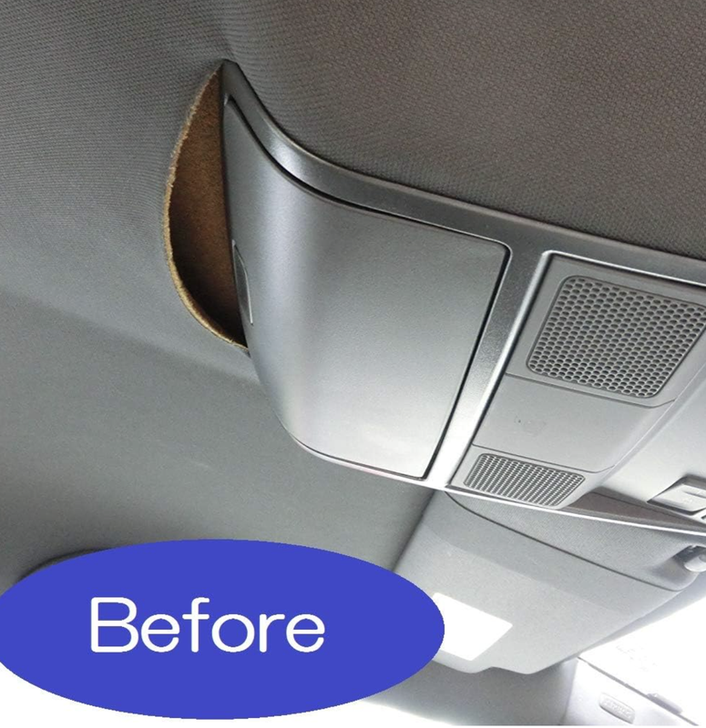

Looks like I've beaten @Jons1001 to it  :P
Overall quite easy to do...it would have probably only taken me an hour to do both BUT I couldn't get the sunglasses holder back in no matter how long I tried. Eventually I ended up breaking the tabs, but resolved that by adding in a couple of screws.
I think it looks good, and although expensive at £170 for two bits of plastic  :surprised:, it's still better than having to fork out £500+ for a retrim  :drinking:

Haha well played sir, looking good!
How easy was the rear?

Super easy, it comes with step by step instructions but in short...pop off the cover, release two clips, pop off the electrical connection, slot the removed section into the new frame, pop it back on.
The only tricky part is trying to slot the new combined piece back into the original opening, but a few mins of jiggling and I got it, probably 10 mins in total.
