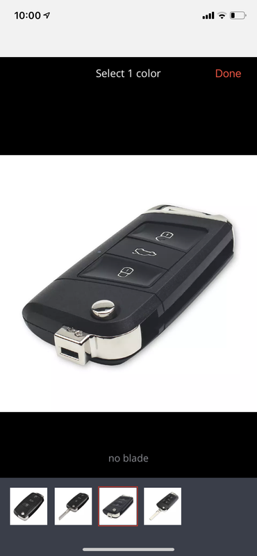

I got this one and ita perfect fit :)
CZK 30.19  15% Off | KEYYOU Modified Flip Remote Key Shell For Volkswagen VW Polo Passat B5 Golf MK5 Beetle 3 Buttons Replacement Car Key Cover
https://a.aliexpress.com/_mtAvSfD

Did you buy it without the blade and then swapped the key blade over or did you get them recut?
Offline Hobca
  • Posts: 9
    • [Top-notch Сasual Dating  Genuine Ladies]
Re: Mk5 to Mk7 key conversion
« Reply #4 on: April 04, 2021, 06:04:03 pm »
Without blade and fitted original one :)

My chip literally dropped off after opening the old key, they didnt come with logo you have to buy it separately. There wasnt any problem except the blade, I had to grind it little bit to get perfect fit. I bought everything from aliexpress :D

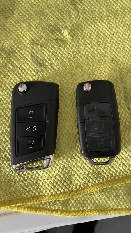

Hi, I did this a while ago a nice and simple upgrade over standard Key fob ,,
B152E51F-1EA8-47CD-9449-DD43DC551061 by DEAN, on Flickr

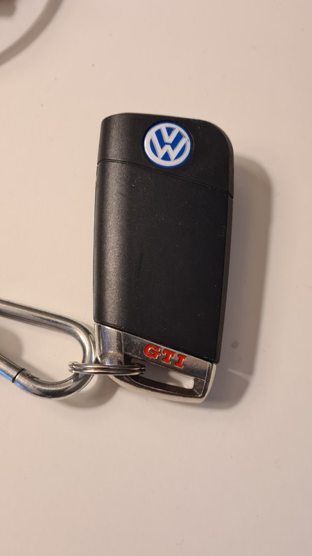

Did this a couple of years ago, but I also bought the genuine GTI loop section (painted the embossed GTI logo red as originally black) and genuine VW badge
