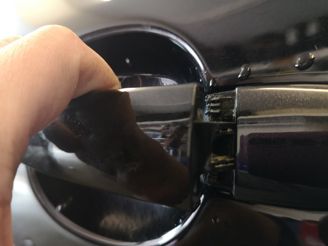

Update. If you pull th handle out a touch then pull with a little more force, not much. It opens every time. I think its a cable issue.

Maybe the end of the cable connector has slipped down the door handle? It's got grooves cut into the end black plastic part and slots into the door handle.

Just looked. I would say you are right mate. Can't even see the tab....

I'd be tempted to take off the door handle and re attach the cable end to the handle groove. Easy job. I recon its slipped down the groves on the hane side end

Yeah will give it a blast tomorrow mate. Looked at the other handles and the tab is definitely viable etc.
