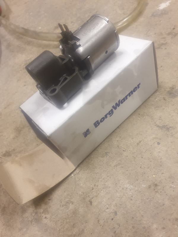

So today I fixed my DSG issue myself.
Fault - FORCE SOLENOID N215 & N216 in the mecatronics.
I Bought genuine borg warner valves after following this guide:
http://www.evosoft.dk/tech.html
My recommendation dont use ecutesting.com for mecatronics diagnosis...they do not test the mecatronics properly!
The guides above will help most issues related to DSG. I also got quoted £1800 ex VAT. from a recommended garage on the forums to do the work. They wanted to change the clutchpack & mecatronics unit.
I fixed this myself for £200.
Hope the helps anyone else on here.  :happy2:
Well done - Im guessing the Golf has been out of action for some time - you must be chuffed!
Where on earth do you get the valves from?
Offline GreigC
  • Posts: 177
Re: DSG Help.
« Reply #21 on: November 11, 2021, 08:32:17 pm »
I was driving it everyday! I am very happy I managed to fix it myself.  :grin:
https://www.ebay.co.uk/itm/GENUINE-SEAT-SKODA-DSG-6-SPEED-AUTO-GEARBOX-VARIABLE-FORCE-SOLENOID-N215-N216-/402560914398?mkcid=16&mkevt=1&_trksid=p2349624.m46890.l6249&mkrid=710-127635-2958-0
You cannot buy the solenoids from TPS or VW so I found them from auto gearbox specialist on ebay. 👍

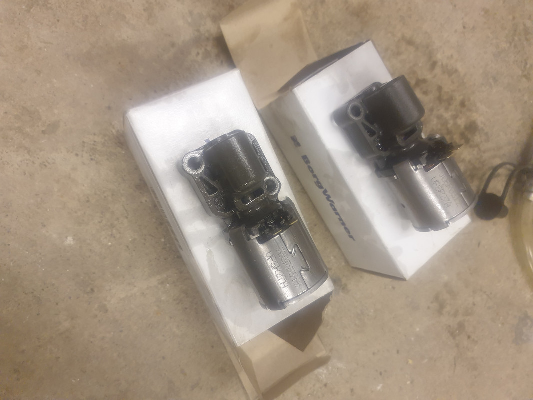

« Reply #22 on: November 11, 2021, 08:33:04 pm »
The failed solenoids removed from mecatronics. Not knowing which one had failed i decided to replace both.
« Last Edit: November 11, 2021, 08:38:44 pm by GreigC »
