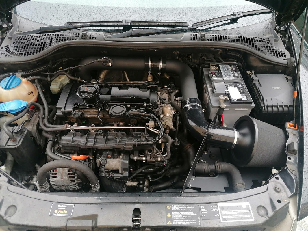

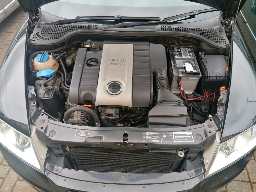

The before:
The after:
I installed the filter with the logo facing away as I wanted it to be less 'in your face'.
As for the sound, it's exactly what I wanted, so thank you for the recommendation @breeze . Lovely sounds from inside the cabin  :smiley:. No check engine lights so far after a short test drive to the petrol station either.
Redline Revs on YouTube cut back the silicone elbow where it joins the filter as it wouldn't fit, but I found with a bit of wiggling I could mine in no problem with ~3mm clearance from the coolant pipe and ~5mm clearance from the body of the car (near the bonnet prop thing). I dunno if cutting it back would increase the air flow significantly but this is something I could do in the future.
'06 Skoda Octavia vRS TFSI

Looks just like mine, glad you like it. :smiley:
Next step is to remove the oil filler spout, the oil cap will fit directly to the cam cover. Please remember to stuff a rag into the spout to avoid things falling inside. Ask me how I know.  :doh:

Looks good  - the big question is will this get you closer to your mates GttD?
Oil funnel removal really make a big difference, best to do it when the engine is warm as it softens the plastic, the result is this:

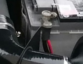

That heat shield looks scarily close to the battery +ve terminal…

It's just the angle of that photo that makes them look like they're touching in my previous post.
