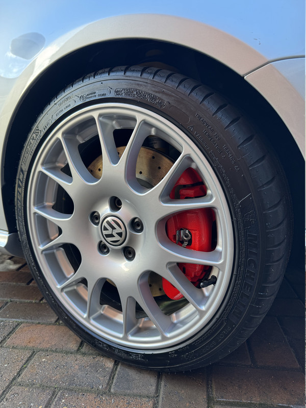

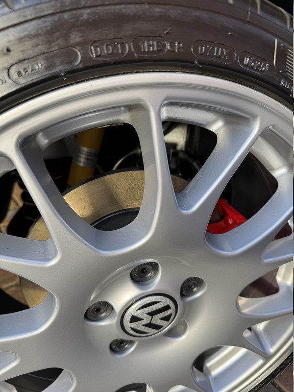

Stripped and cleaned the wheels team also ceramic coated them for future cleaning ease

Nice little before and after of the front:
I had a mare when sorting the rear brakes though, the internal butchers in both rear calipers opted out when i was trying to set the handbrake! So had to strip off, sort and refit/bleed the brakes again - they were a nightmare to get in those clips!

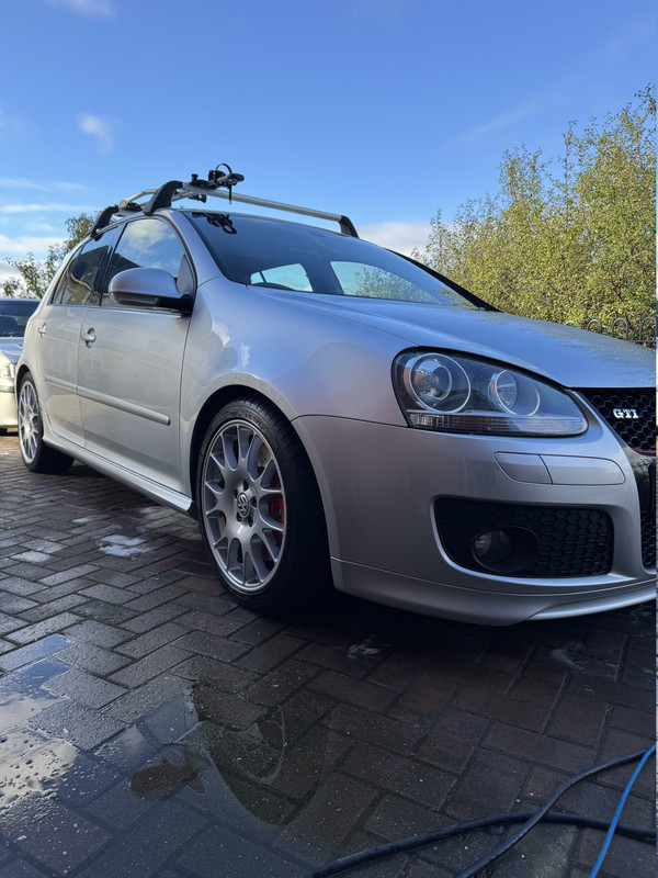

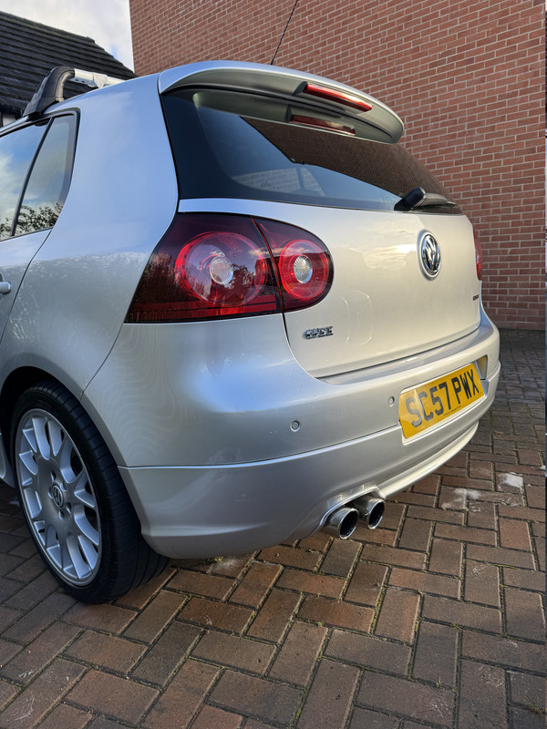

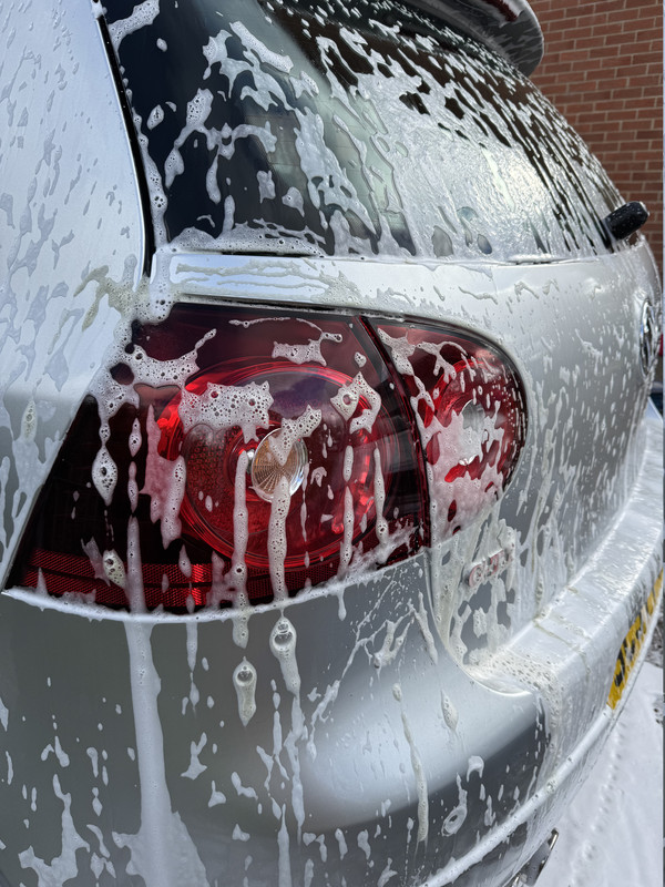

Well, finally the end has come! All that graft of lying on my back on the drive has paid off - the ED30 is now ready for another 20 years on the road.
As always I have gone way further than I thought I would but not so much to the point that I’m afraid to drive it!
Have it a long overdue clean inside and out and took it out for it the MOT retest - ball joint was able to be nipped up with a modified tool to hold the inner shaft without having to remove the driveshaft, also the sidelight……..turns out I was looking at the indicator lamp which is why I couldn’t figure out why it wasn’t working 😂 the sidelight is a sneaky one if you don’t know it’s there haha, oh well we live and learn!
First proper drive was great, felt so good to be back behind the wheel, it feels like a brand new car, very glad I didn’t sell it in the end, this was the right path to choose.

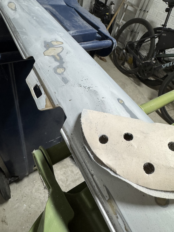

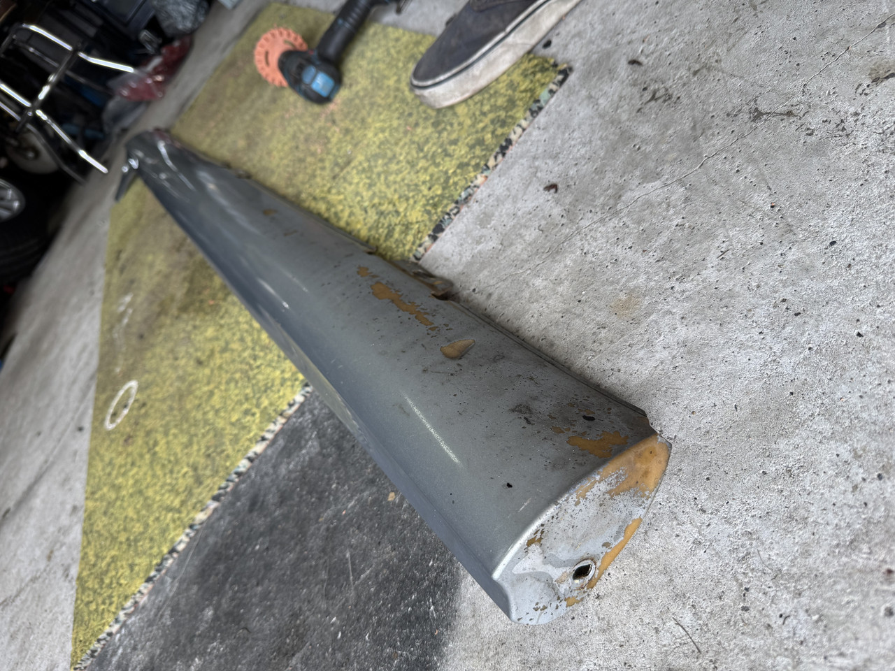

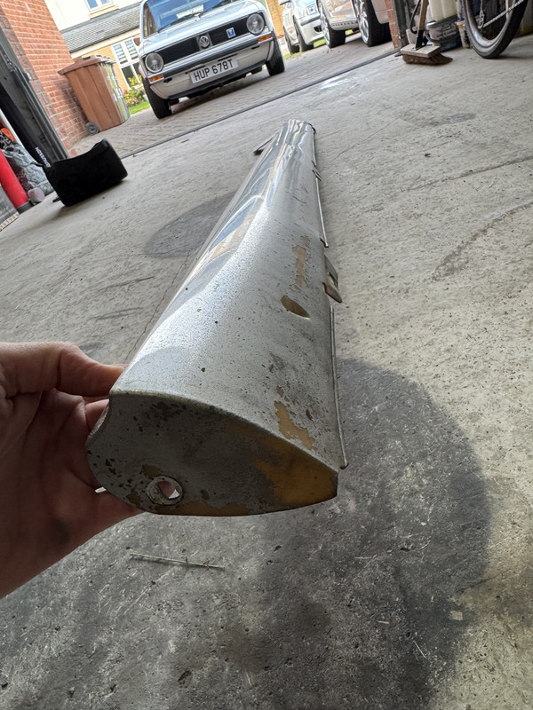

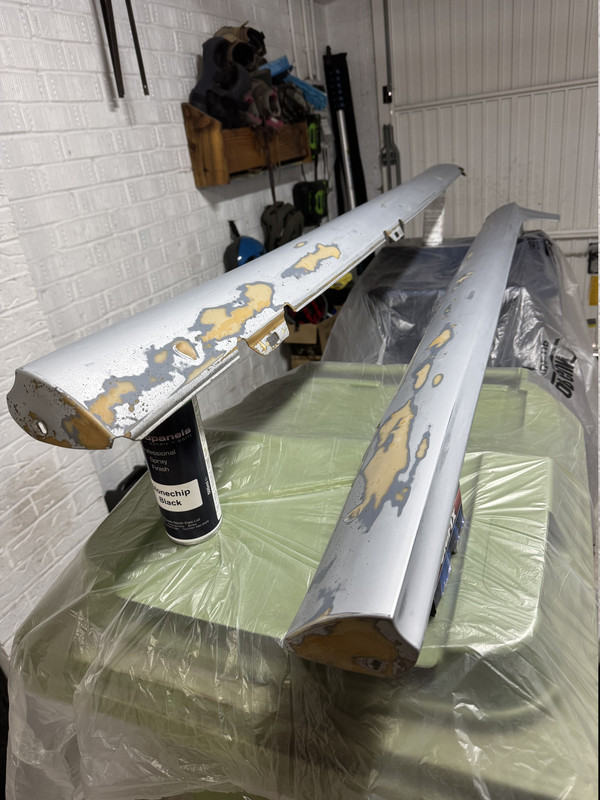

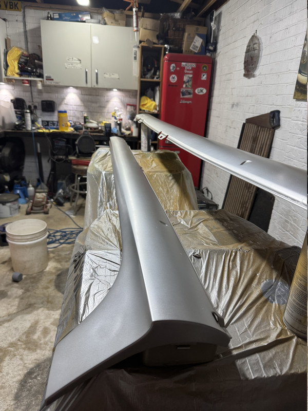

Oh, I forgot to add to the last post, I also stripped and painted the sideskirts as they were battered up from years of roadrash - came out not too bad for a rattle can job like:
