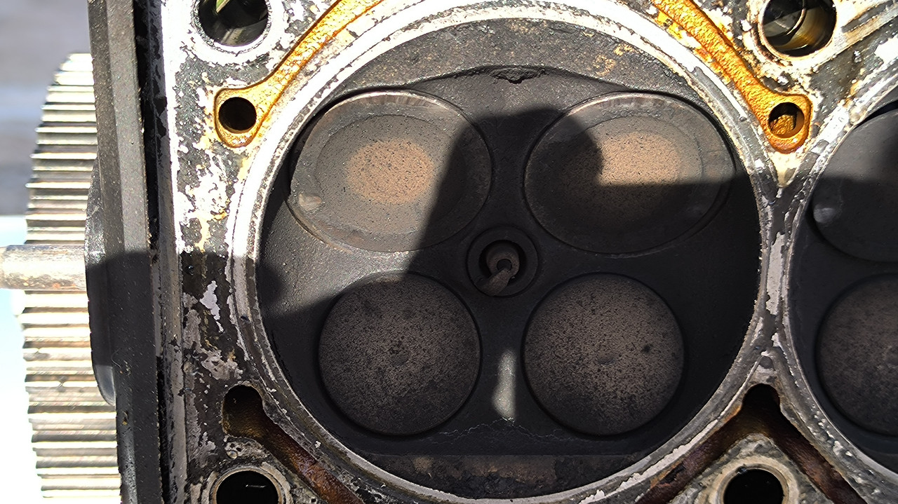

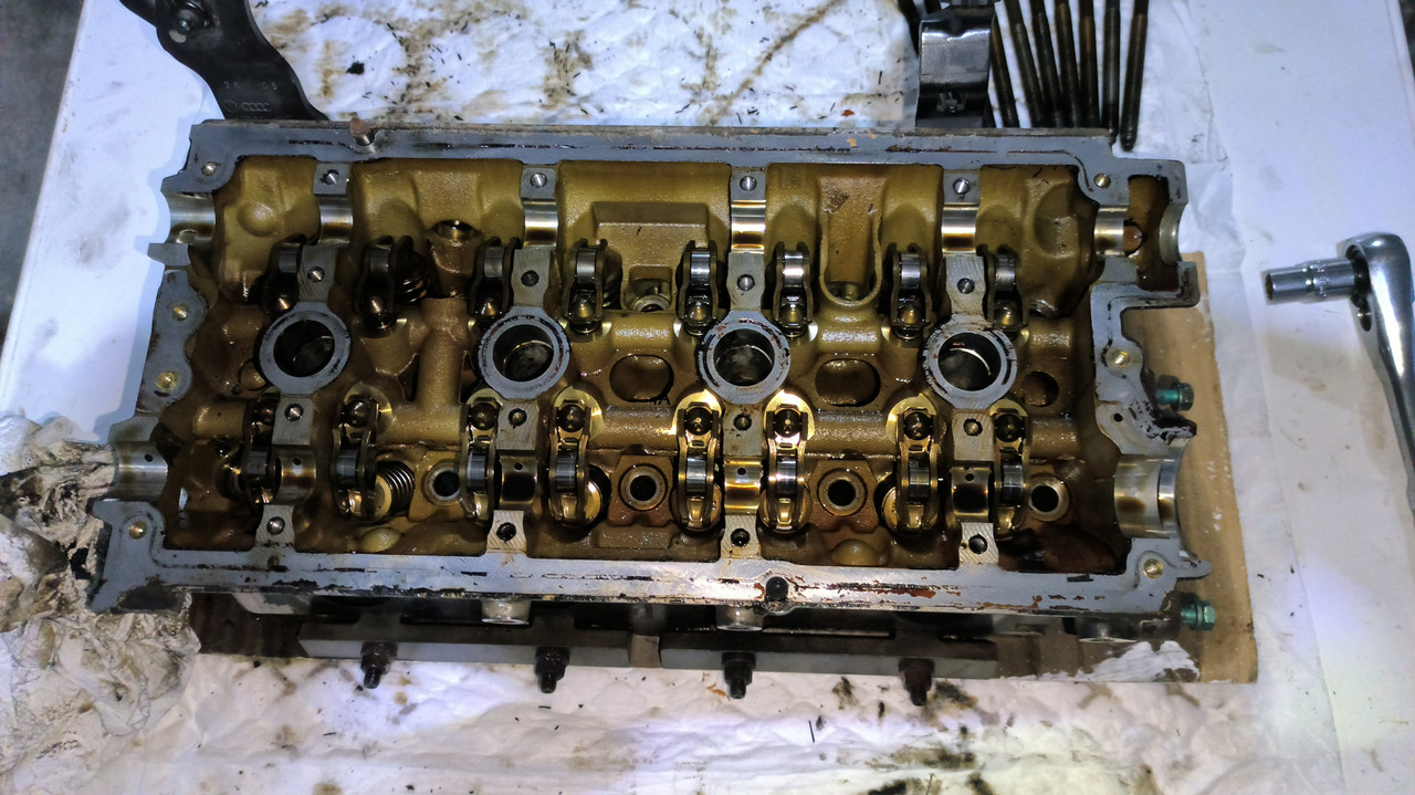

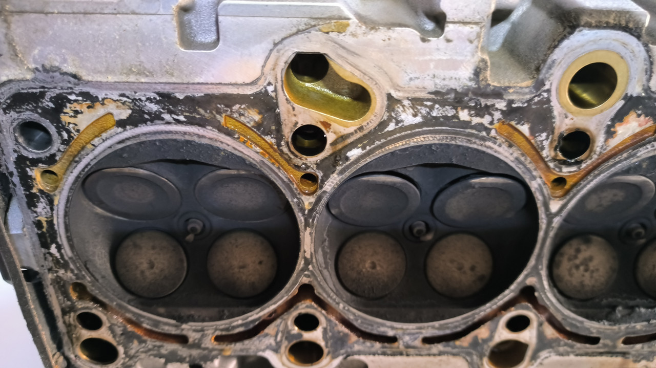

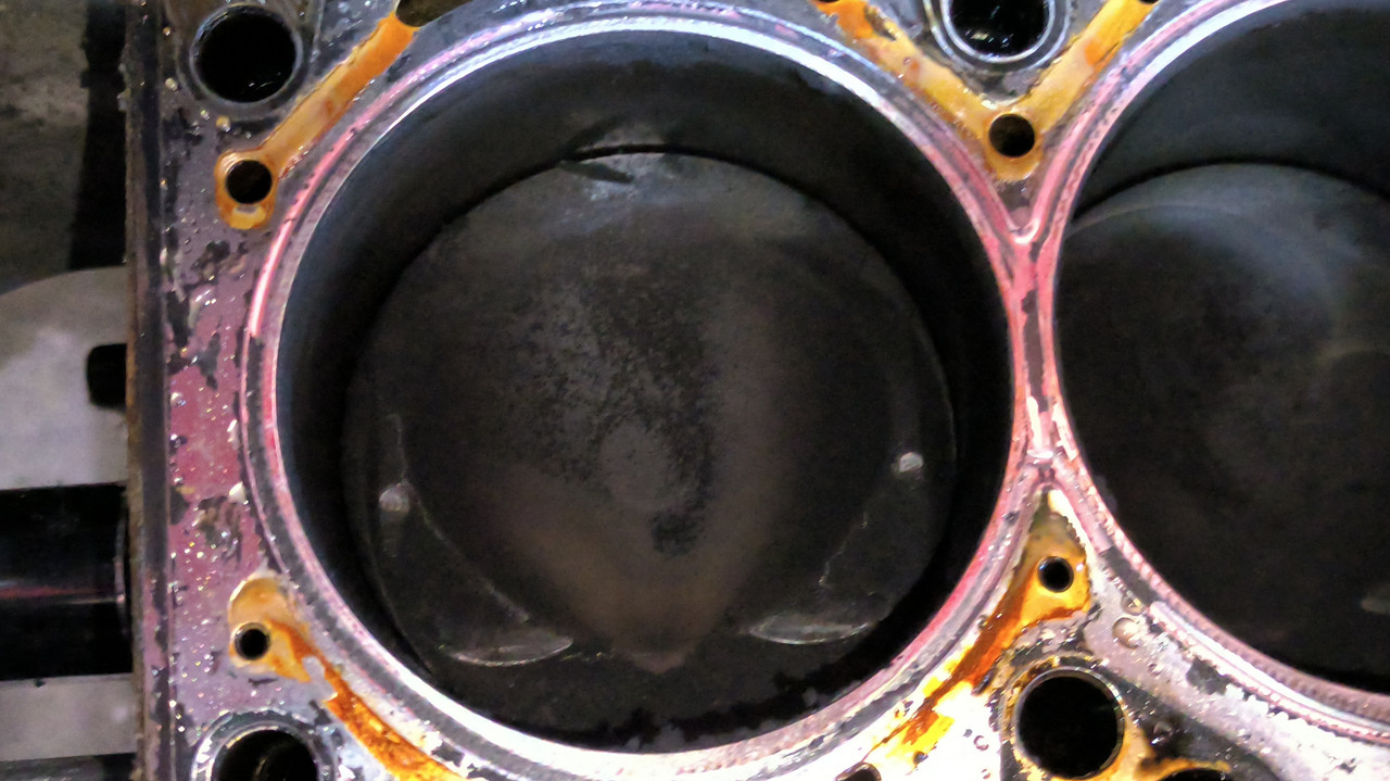

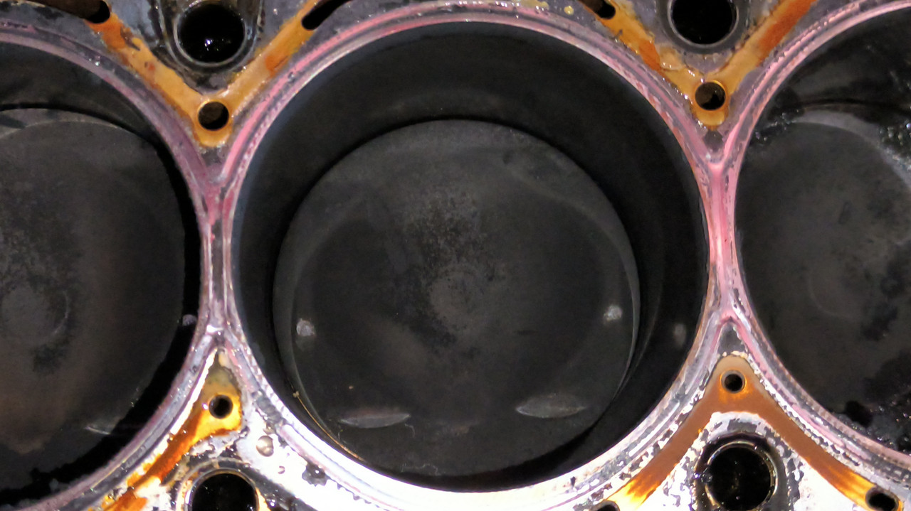

« Reply #34 on: September 10, 2023, 05:39:09 pm »
The head is off. Some pics.

« Reply #35 on: September 10, 2023, 07:42:47 pm »
Can see the valve to piston contact on top of the pistons!

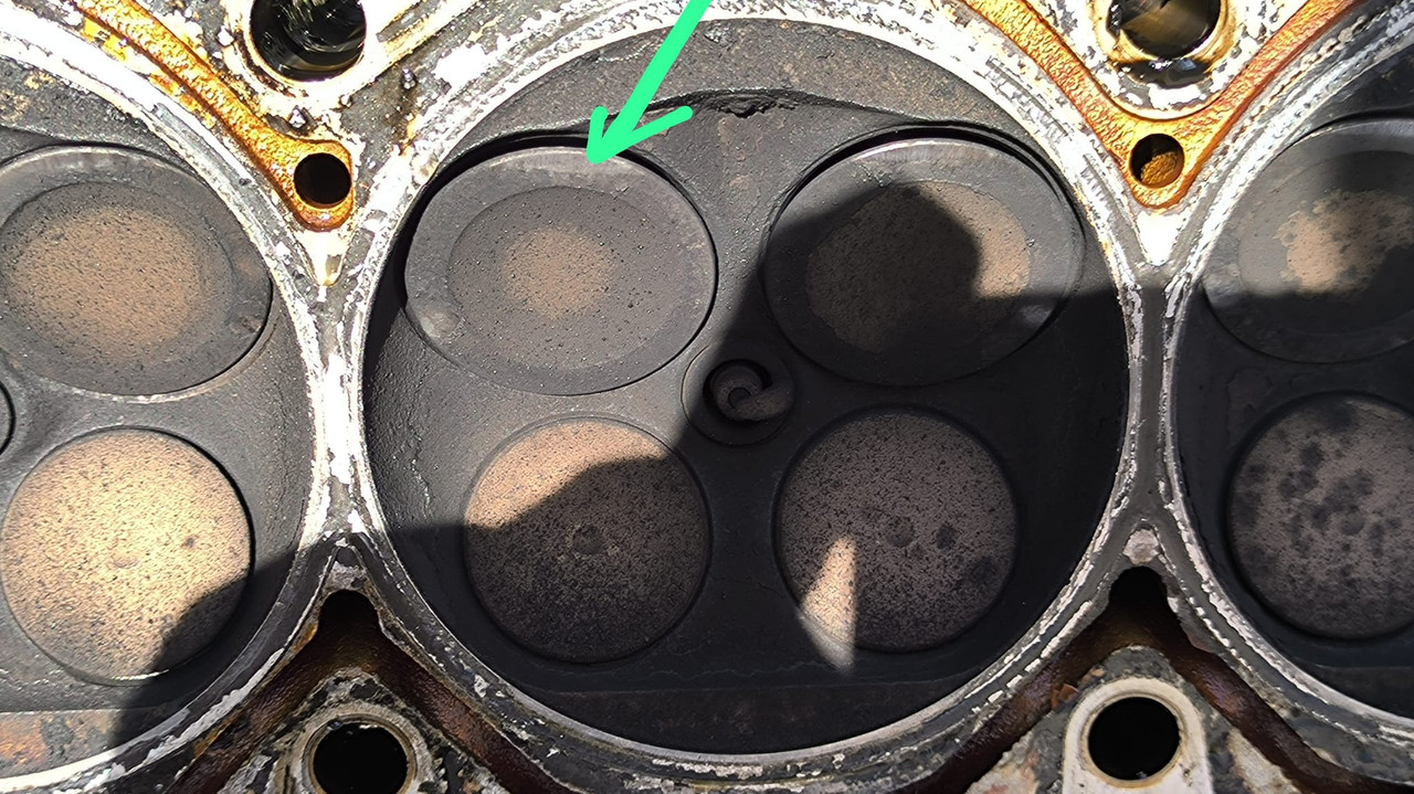

Re: Some Help Broke Down :(
« Reply #36 on: September 10, 2023, 08:34:27 pm »
this?
Also all the intake valves have some skuffed spots.
« Reply #37 on: September 10, 2023, 08:41:30 pm »
Yep - Are the cams out of the head? If so put some petrol around the valves to see which ones leak.
Can see most of the inlet valves are bent from the pics but they all need removing to check properly

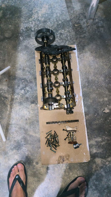

« Reply #40 on: September 12, 2023, 05:40:34 pm »
Not having much luck with this locking tool will not fit
05 | Tornado Red | DSG

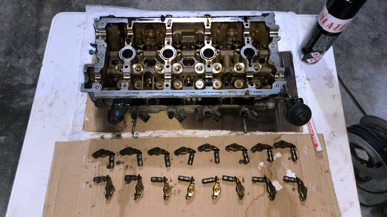

« Reply #41 on: September 12, 2023, 08:31:37 pm »
The cams are out will have to remove the cam adjuster another day.
The lifters look good

« Reply #42 on: September 12, 2023, 10:23:21 pm »
Just the valves to remove now then Dazza! :congrats:
