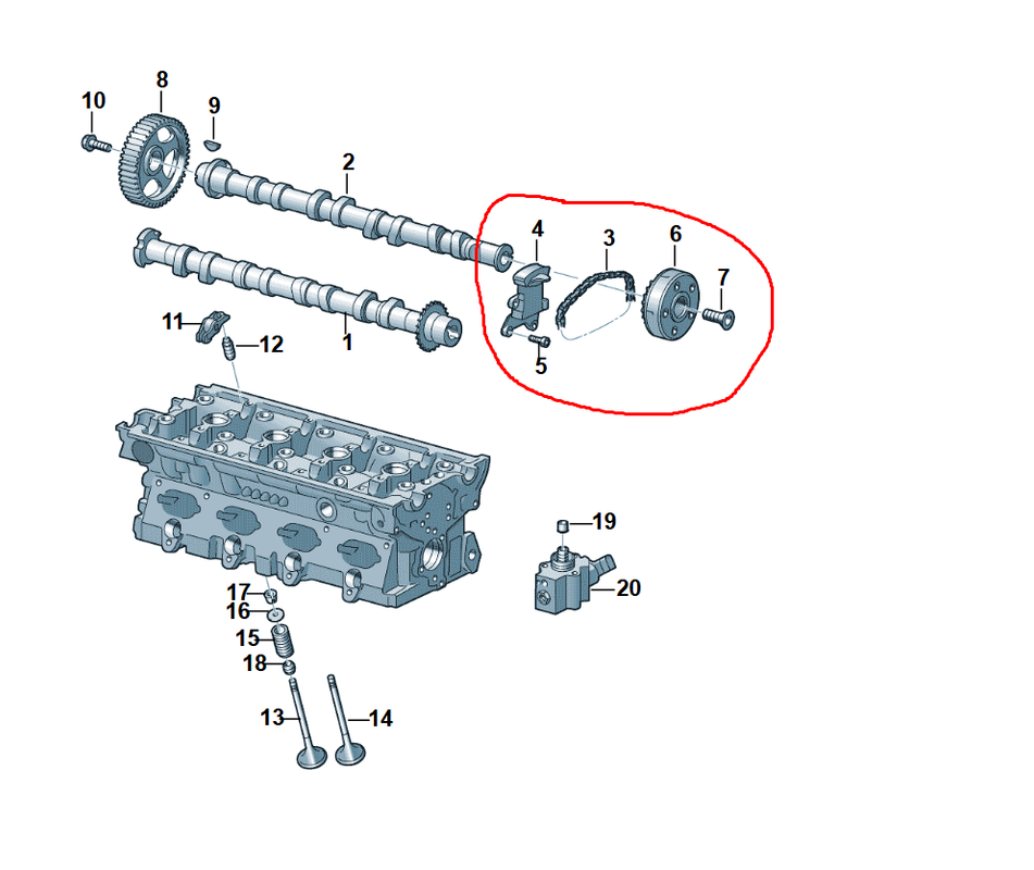

  • 3 - camshaft timing chain - 06D109229B
  • 4 - camshaft chain tensioner - 06F109217A
  • 6 - camshaft adjuster sprocket - 06F109088J
  • 7 - camshaft adjuster bolt - 06D109281D - single use, will strip head upon removal, requires VW Tool T40080 to install/remove

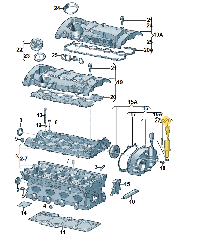

  • 26 - camshaft adjuster regulator/controller - 06F109257C
The way this works: The adjuster, also known as the N205 opens/closes to direct oil flow through itself into the variable sprocket. Using oil pressure, this adjusts the rotation of the intake camshaft (IIRC). Overtime both can get clogged due to the gunk that deposits on them from the oil. This slows down their movement or sometimes seizes them completely. It's usually the variable sprocket that has issues, but I changed both just to be sure.
These generally have a lifetime of 100k km but can last over 150k depending on how you drive the car, what oil you use and how frequently you change it.
By lifetime I mean work properly in their factory parameters. You can still use them until they seize completely or until your car starts throwing a CEL. You'll just have a slower response, rev hang and maybe less power.

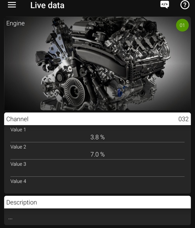

I checked my fuel trim values(see screenshot). MB 32 value 1 is 3.8% and value 2 is 7.0%, with aftermarket intake it seems to be normal to be anywhere between -10% and +10%? Are my values indicative of anthing?

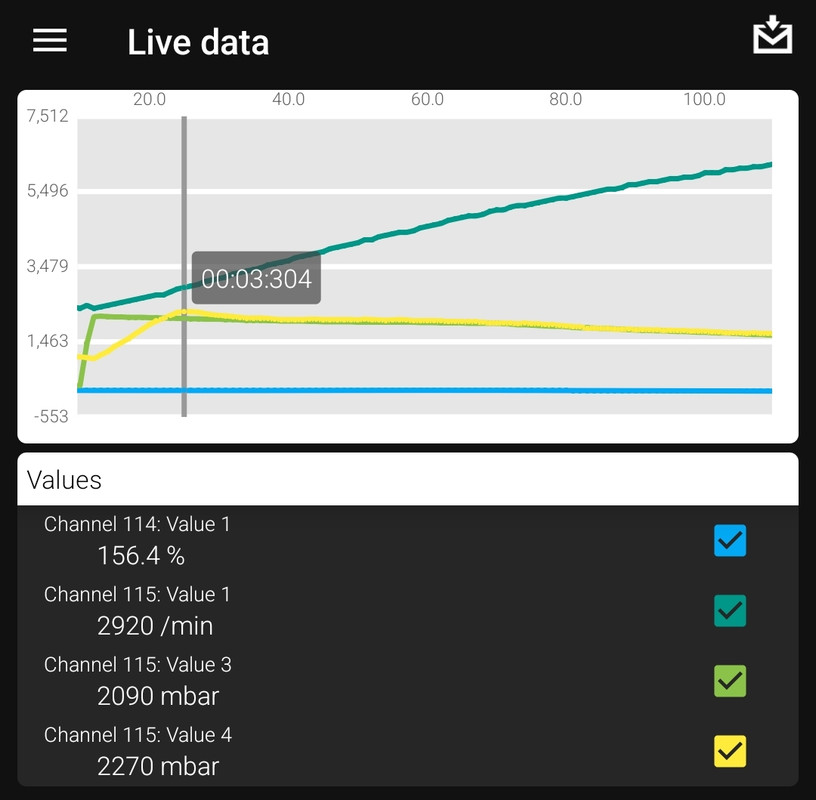

Am i correct in saying i dont need to check anything between Turbo and intake manifold? (see screenshot) At see level(subtract 1000mbar), actual boost is peaking at 2270mbar and then steadily dropping, always staying a smidge above requested boost. This would make it highly unlikely that there is a leak between turbo and intake manifold, or am i incorrect?(coupled with the fact that garage did a smoke test, basicaly testing up to the intake manifold?)

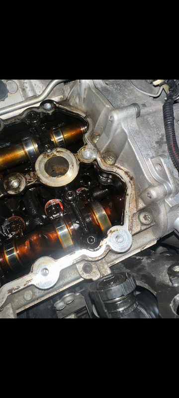

On my weeks of i started with maintenance. Did an oil change and noticed a bunch of metal in my oil. I got it checked out at a specialist and turns out inlet camsheft and the parts around it(rockers etc?) where worn and it needed a revision. Got a quote of 3200k euro for full head revision and 3800 if the camshaft chain and tensioner also needed to be replaced. Thought about it but decided to sell the car for an offer of 2.2k.

Mine is not looking that great either. There's a piece of my inlet cam on cyl 3 missing and it's misfiring on almost every single try on cyl 3 at idle. I'll have to get mine done as well next year for sure.

A refurbished BWA engine starts from 3.5k euro here(netherlands). Im sure you can source engines second hand somewhere but who knows what state that would be in.
Thought id upload a picture of the cam.
