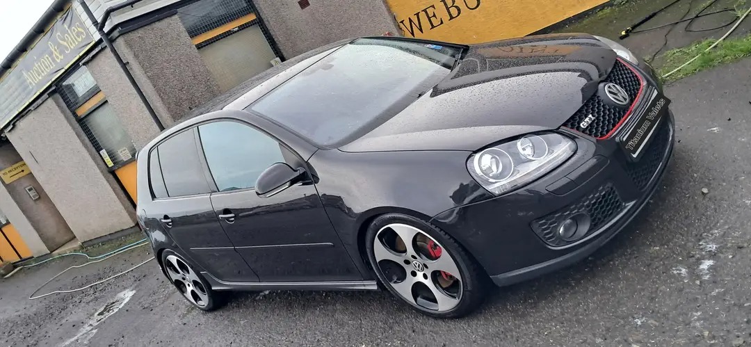

Offline Bassman1974
  • Posts: 13
Re: Known Issues
« Reply #5 on: December 08, 2025, 09:47:25 am »
Thanks guys, much appreciated!
Still on the lookout for the right car, so we shall see when I get a nice one…
I had considered selling mine, but
A: I've spent far, far too much on what should have been a stopgap car
B: It comes up nice after a valet
C: It never gives me any bother
Good luck with the search !
Offline JW
  • Posts: 3
Re: Known Issues
« Reply #6 on: December 08, 2025, 07:01:15 pm »
Looks very nice!
