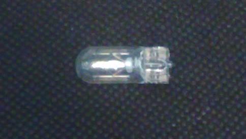

Right then, this is the bulb in my mirror puddle lights
What type is it please?
The housing says 13.5v and 6W on it for the rating i presume, there is writing on the bulb itself but its faded away and become unreadable
Ant

Perfect thanks, that looks like the right thing, from looking at the faded print on the bulb i'd have said it was W6W but W5W looks possible too.
And finally one last question, do they need to be the type that shouldnt give an error or will the bog standard LED ones work?
