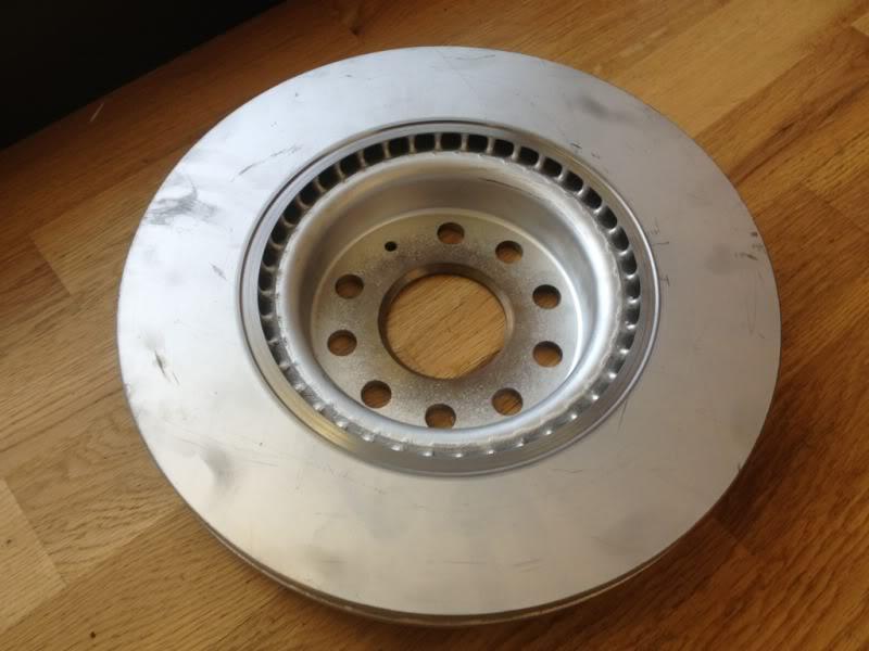

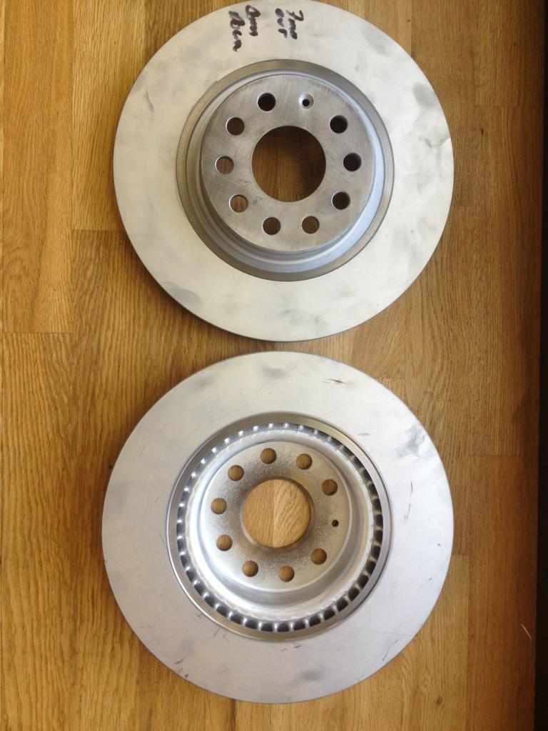

My Calipers are all refurbished and on route to me from Brake Caliper refurbs, pictures to follow.
My new VW discs turned up yesterday so I sent them off to the engineering shop to have the unused bit removed from the inner and outer faces.  On Daves instructions, I have removed 7mm in by 1mm deep on both sides, as can be seen in the pictures.
The next job will be to paint (hammarite) this new metalwork and the disc bell in black, to prevent rusting and just genrally make them look better - I will also remove the rear discs and do the same, as there is signs of rust o these.
I have Ferodo DS2500 pads to go on, which should give me all the braking I should require for fast road.

Cracking Job Oli
Its really not that hard to find somebody local to do small jobs like this. It generally only gets expensive when precision is required, a quick setup and a 7mm swipe cost what Oli? 30-40 Quid??
SO about £120 all told for some consumables
I love it when people get involved like this, this is what the NQSBBK is about cheap quality stoppers with a bit of involvement from the user

Dave, I got it done FOC at my local engineering shop because I spend a few quid with them.  But I suspect no more than £40
