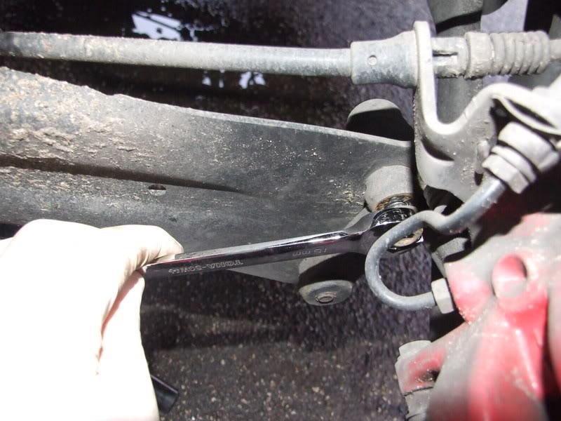

and undo the droplinks on the ard and on the arm

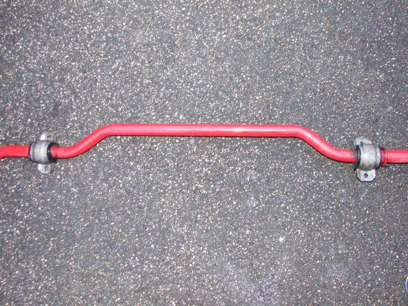

you need to keep the arb clamp bolts and the droplink nuts and change the clamp over to the neuspeed arb and put lots of grease on the new poly bushes
and then put the bar back on
