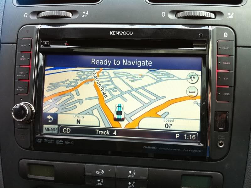

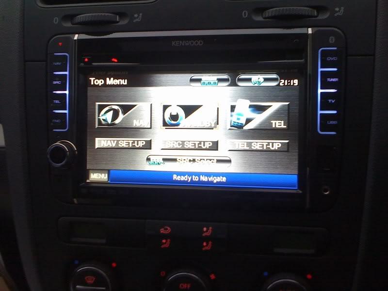

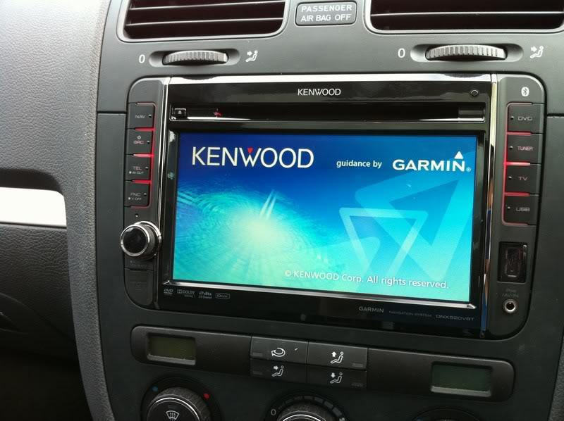

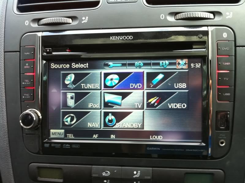

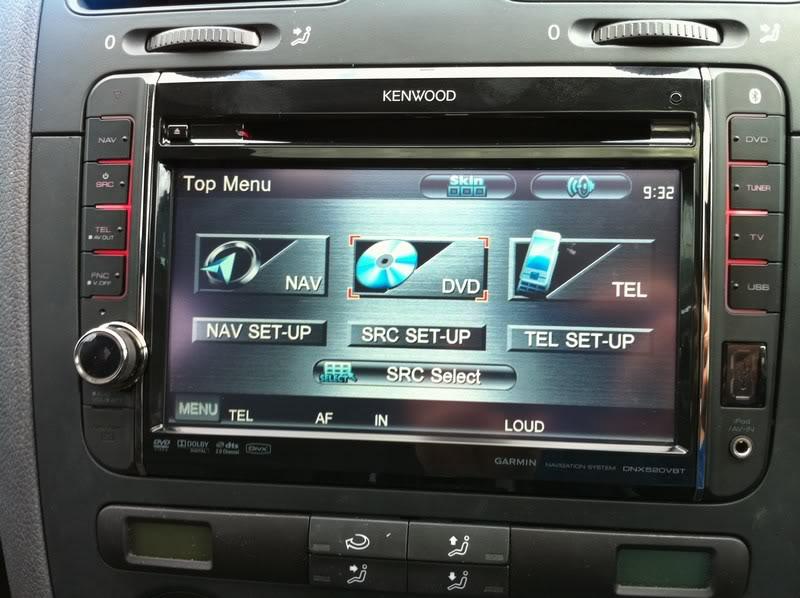

EVENTUALLY got this in and workin as it should, after about a million attempts.
thanks to GTI_MAD and anyone else who tried to guide me in the right direction, I have fitted loads of sound systems, and handsfree kits to other cars I have owned, and never had as much trouble.
Turned out the ignition wire I had ran, had a break in it, if i had a multimeter i could have tested this but being a new wire i couldnt see that being the problem, after loads of different plug swapping etc, i decided to run a new wire and hey presto.
