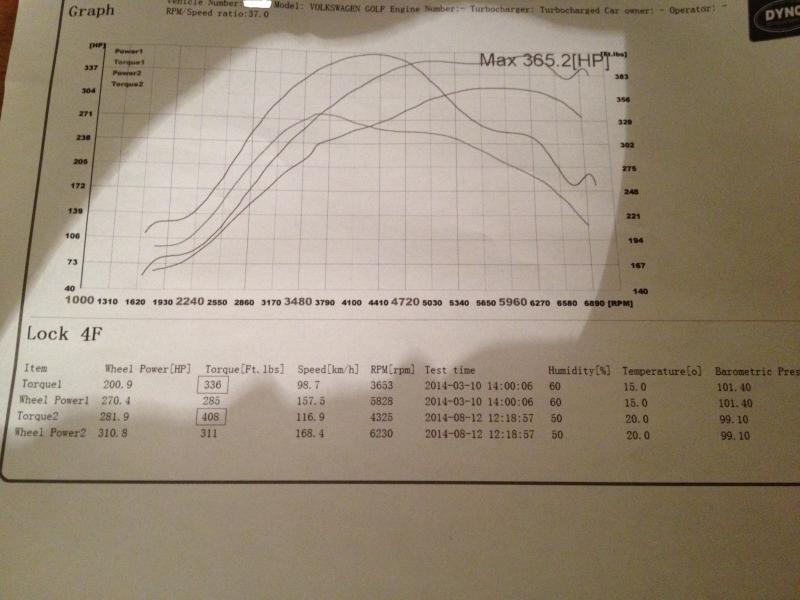

Stage 2+ edition 30 with latest Revo update
Is this a recent revo update to 2+
No idea how recent it is. I was advised to get an update by statllers. When I phoned Revo, they said I had revision 5, they were currently on revision 12 for my car, so he also advised me to get it done.
Graph shows old stage 2+ with 5 week old vpower in the tank. The latest run was same settings, latest revision, and car had just been serviced

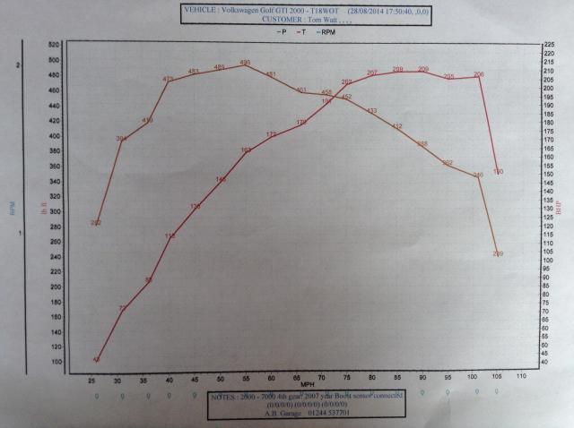

K03 gti
Shark stage 2 remap
Forge twintake
Miltek non res full tbe with 200cell sports cat
Revised dv valve
Not very good at interpreting the results if anyone can help out, I believe this graph is at the wheels which translates to ~250bhp, BUT  he did say the env temp was 26 degrees so add ~ 10% hp to compensate. So we reckon 270 Bhp  :happy2:
Can anyone make sense of the torque for me, doesn't seem right!
Looks like it's calibrated in Nm although it written lb ft on the printout.
490Nm equates to around 361lb ft

Thanks mate, that makes perfect sense! How does the graph look otherwise?
