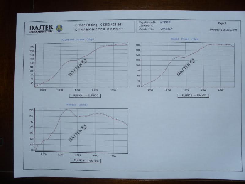

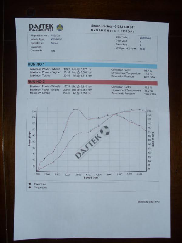

Budget Remap
ITG maxogen induction kit
Slowly progressing. . .

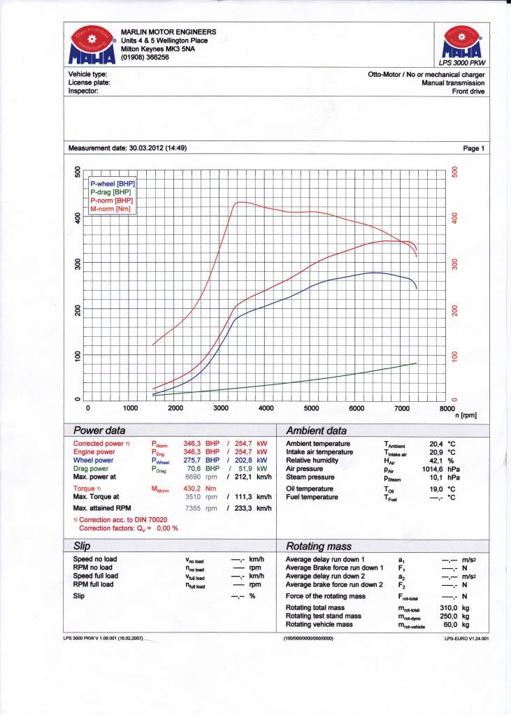

Revo Stage 2 + 363BHP  345LB/FT

Am i correct in reading your torque to be 430nm Mike?  :confused:
You've lost 90nm  :surprised:

hmmm, not sure after being without the car for so long its hard to say if the butt dyno agrees but I wondered if chaanging from 2.75" Miltek to 3" BF w/de-Cat would be enough for such a torque drop

I've had 3" since i went K04, so mine's making the 367bhp and 517nm on 3", do you know precisely what APR has changed?  :smiley:

your comparing two completely different dynos so you have to take it all with a pinch of salt.
For example stage 2+ REVO cars on JKMs DD rollers rarely see over 300lbft.  Take them to another dyno and they'll see 380lbft!!!
