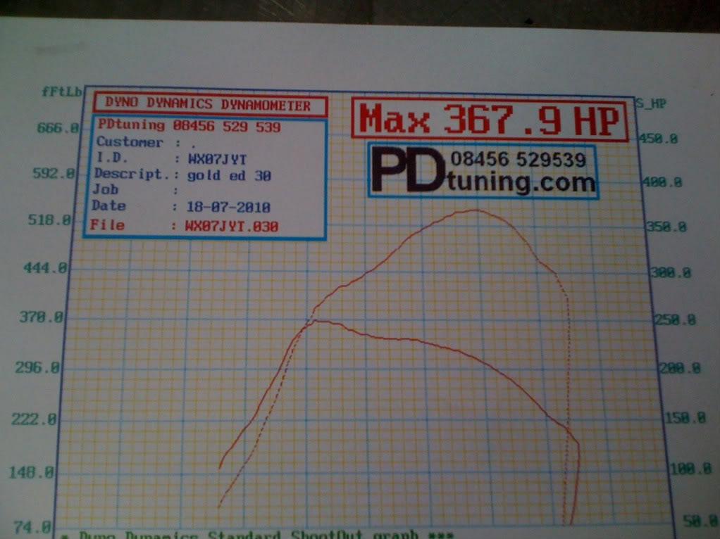

On sunday I finally got a chance to finish setting up the ED30 with some road datalogging and dyno testing we ended up with:
Boost:8
Timing:8
Fuel:5
Mods are:
Milltek full turboback 3" decat resonated system
Dbilas/pipercross DIY intake
Autotech fuel pump
DSG stage 2 REVO
Forge Twintercooler
REVO stage 2+ software
(photo missed the dyno calculations at the bottom which were: Intake temp: 37 ambient temp 23 Barometric pressure 1013 humidity 45)
The addition of the twintercooler allowed us to take timing from 5 to 8 which took the car from 357bhp to the figure you see above, however torque has dropped from 380 ft/lb as we had to lower boost from 9 to 8

awesome figures for DD rollers. How come the curves are so condensed, is it possible to spread them over the complete width of the graph, its better to compare the curves with others then.
the new dyno graph thread here as well :happy2:
http://www.mk5golfgti.co.uk/forum/index.php/topic,16977.0.html
would look better if you could get the torque an power figures on each side of the graph the same

Timing 8 OMG, were you on normal 99 ron or race fuel?
Did you get any logs done?
Good result on the run :happy2:

I can adjust the scale of the graph but this is how we set up the screen for all dyno tests.
Hurdy, this was using 'normal' 99 octane fuel, the twintercooler really helps keep intake temps really low, we saw a timing pull figure of 4 degress after a few 4th gear pulls but intake temps were still at just 34 degrees.  On the dyno this raised to 5 degrees of pull and an intake temp of 43 degrees after 3 dyno pulls at WOT.
:happy2: :happy2:
throw it in the new dyno thread :happy2:

The rpm scale is not shown so could you state @what rpm do you see your max hp at.

gaz, post your graph up in that thread, and then if PDT can change the scales on his graph we could make a good comparison between the two.  iirc yours was similar at the last RR day??
