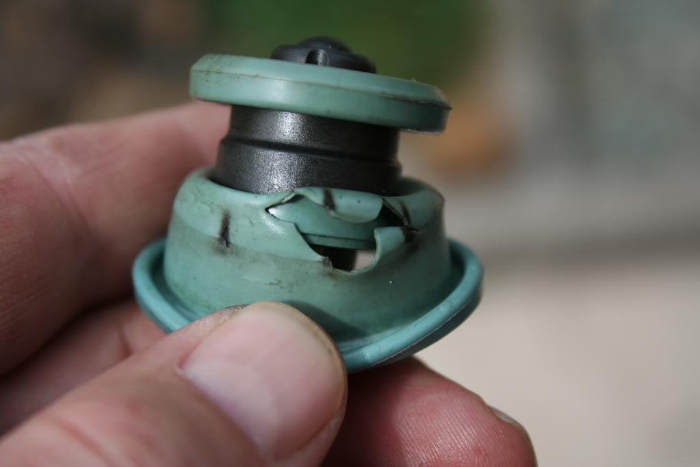

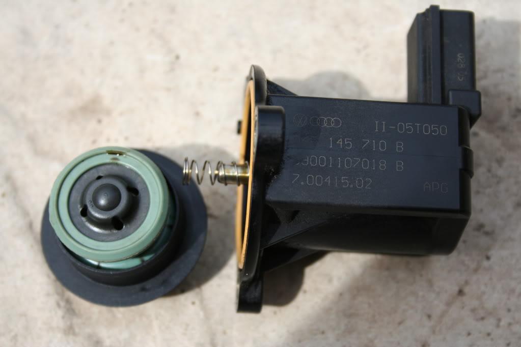

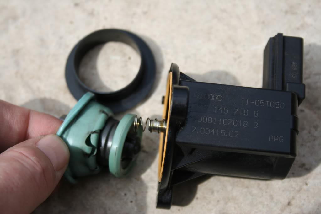

Hi All, after reading all the info on this site regarding DV Valves i decided to change mine to the OEM version D, as i own an 05 GTI, and it is recommended that on models this early it be replaced,
I am very pleased i decided to change mine as my car now feels a whole lot better and is alot faster, and would recommend anyone with an early MK5 GTI to replace their DV valve for the latest version,
Reason for my post is that i have uploaded some pics of my DV Valve and it shows just what condition yours could be in too.

that is fubbared
I took one out of my mates 56plate GTI the other day and that was in a sorry state as well, not quite that bad though :laugh:

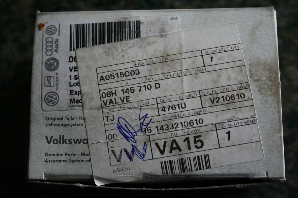

Hi there, yes i noticed the car was off so to speak, it was very slugglish, and the turbo seemed to kick in very late, there ws also this hissing sound when putting you foot down, after changing the DV the car is now alot faster, accleration is alot more solid, and the turbo kicks in alot earlier.
the last pic shows the box and part number of the replacement Version D valve

I take it the pic of the part box is the correct part number ?. :happy2:
