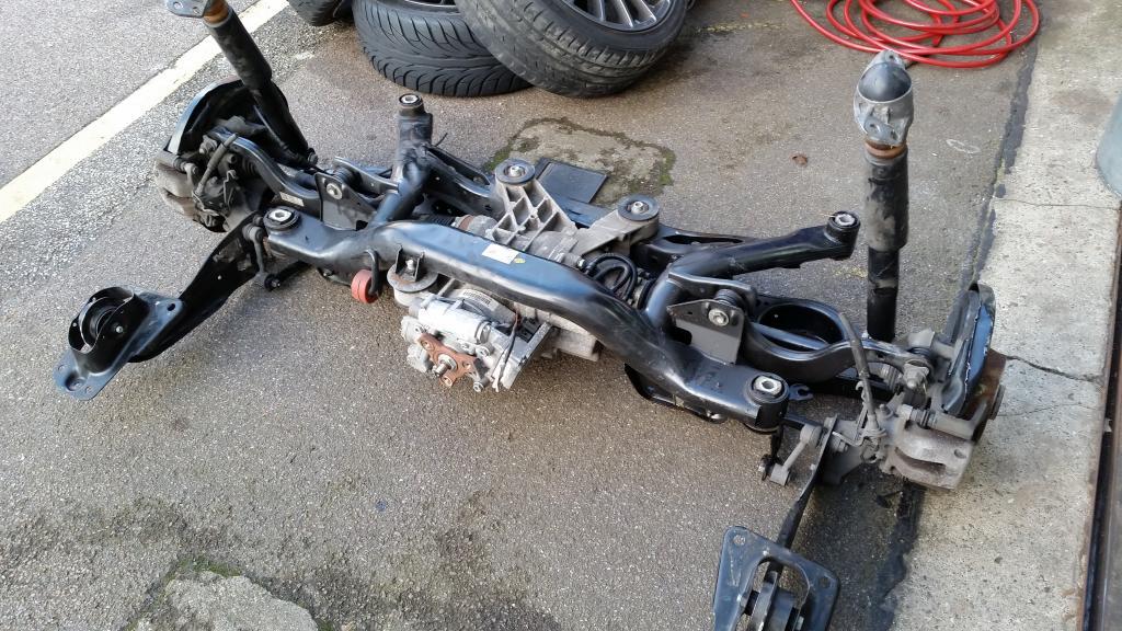

« Reply #692 on: October 12, 2014, 07:11:04 am »
The rear of an A3 r32 :)
Over the top mod list ;o)
Offline vRSAlex
  • -Receive: 253
  • Posts: 2761
Re: vRSAlex's Octavia vRS Estate - New Mods On
« Reply #693 on: October 12, 2014, 08:17:10 am »
2012 TT rear.  Which means the hubs are alloy and the right offset for a 4 pot and separate handbrake conversion.   :evilgrin:
Nice, i assumed that due to the unpainted rear calipers it was of an A3, what about clearance with the extra track width, are there room for it on the Skoda?  :smiley:

« Reply #697 on: October 14, 2014, 07:39:42 am »
I'm already running the wider TT rear hubs from a front wheel drive TT. Clearance is 'just'!

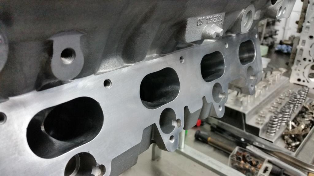

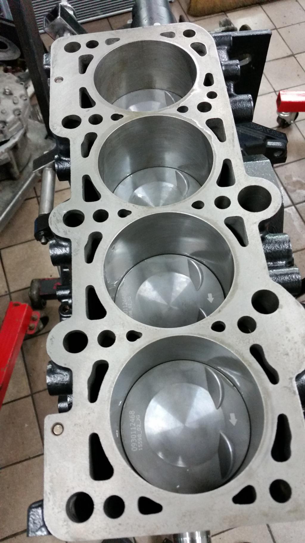

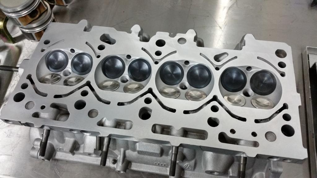

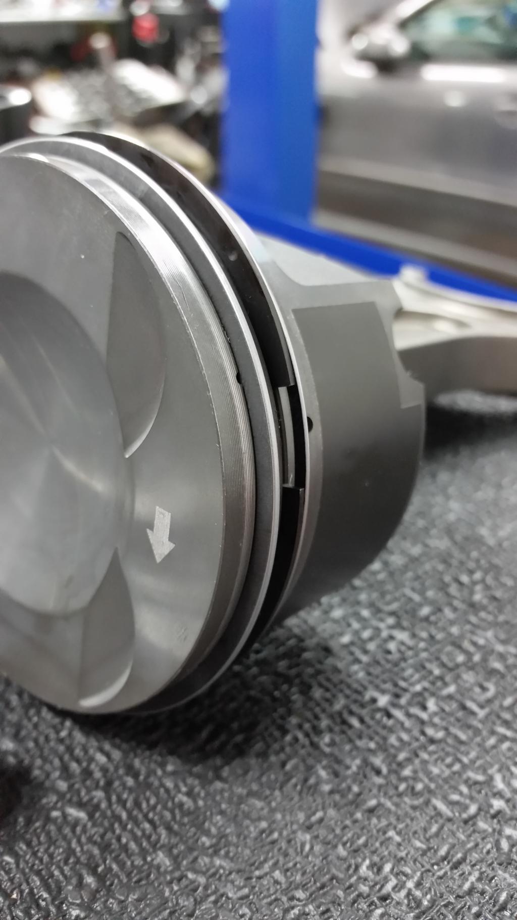

« Reply #699 on: January 05, 2015, 06:57:14 pm »

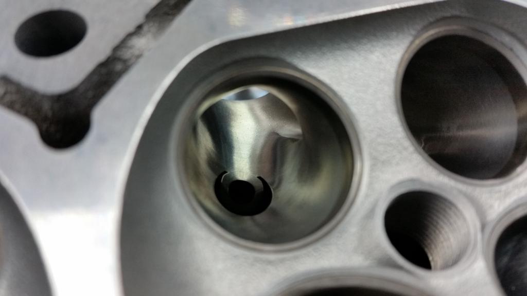

Engine build is coming along nicely:
Now the head is something a little special.  Runner guides are all welded up.  Ports are enlarged.  Valves are Supertech +1mm versions with uprated springs:
Follow AKS tuning on Facebook
Offline Bignod00
  • Posts: 872
  • Ginsters are sh*tE!!
« Reply #700 on: January 05, 2015, 06:58:42 pm »
Wow, looking amazing. Can't wait to have a perve over this at the end of the week! :happy2:
