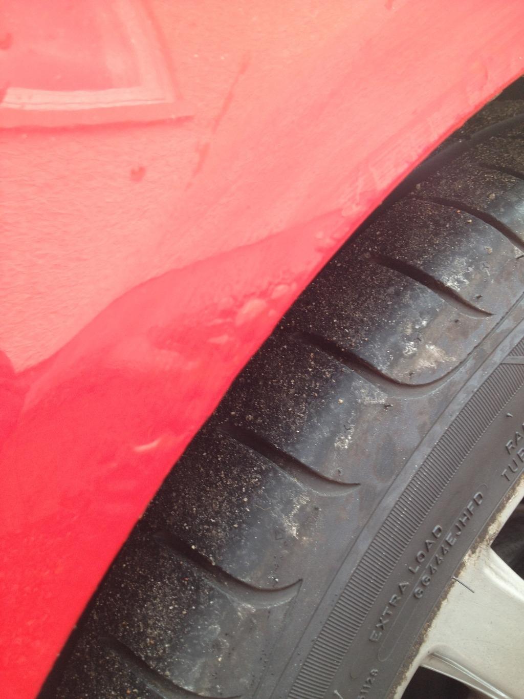

Hey folks... New to Gti ownership, just picked up a mk5 tornado red 05 plate.  It has bubbling on one of the front wings, pretty bad, almost the whole arch.  I'm wondering how to go about approaching my VW dealership, it'll be specialist cars VW Aberdeen.  I believe there is a pdf that helps back up the 12 year anti-corrosion warranty?  Anyone able to email this to me?
I would like to arm myself with the correct info before speaking to them.
Many thanks..
Ps I'll get a picture of the area up on here to show you what I'm talking about!
« Last Edit: March 24, 2016, 10:19:42 am by Gmac »

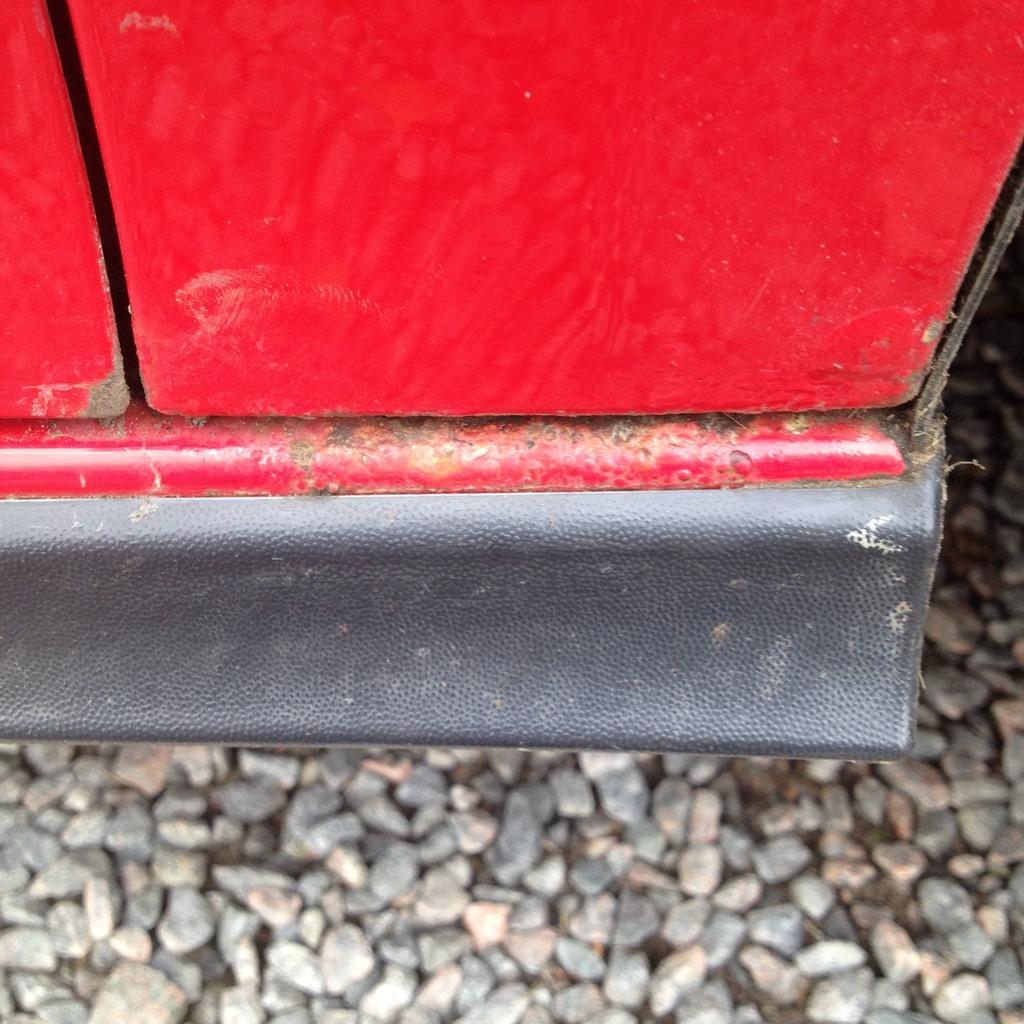

Have you had your done recently then?  Did they ask about full service history?  The sills at the bottom of the front wings are both rusted! Are these something that can also be sorted?
Offline Ditto
  • Posts: 155
Re: *** VW - RUST & WARRANTY *** RESULT!!!!
« Reply #574 on: March 24, 2016, 01:08:46 pm »
@Gmac make sure you check the sills (put a bright light to the gap or take a picture with your phone to see inside). If they need doing it'll be much easier for them to cost having them done at the same time.

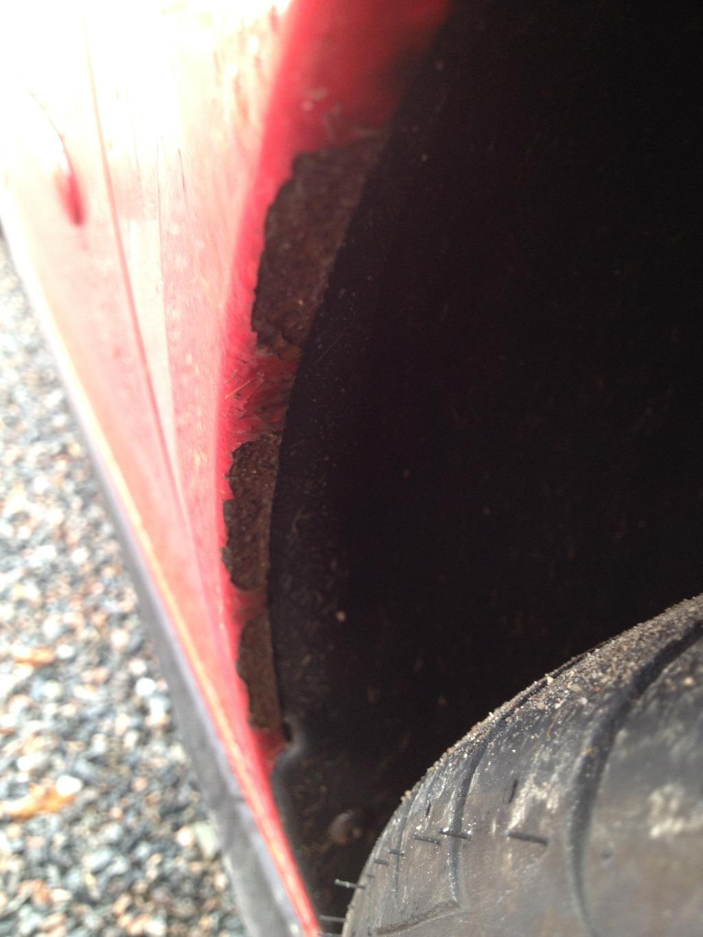

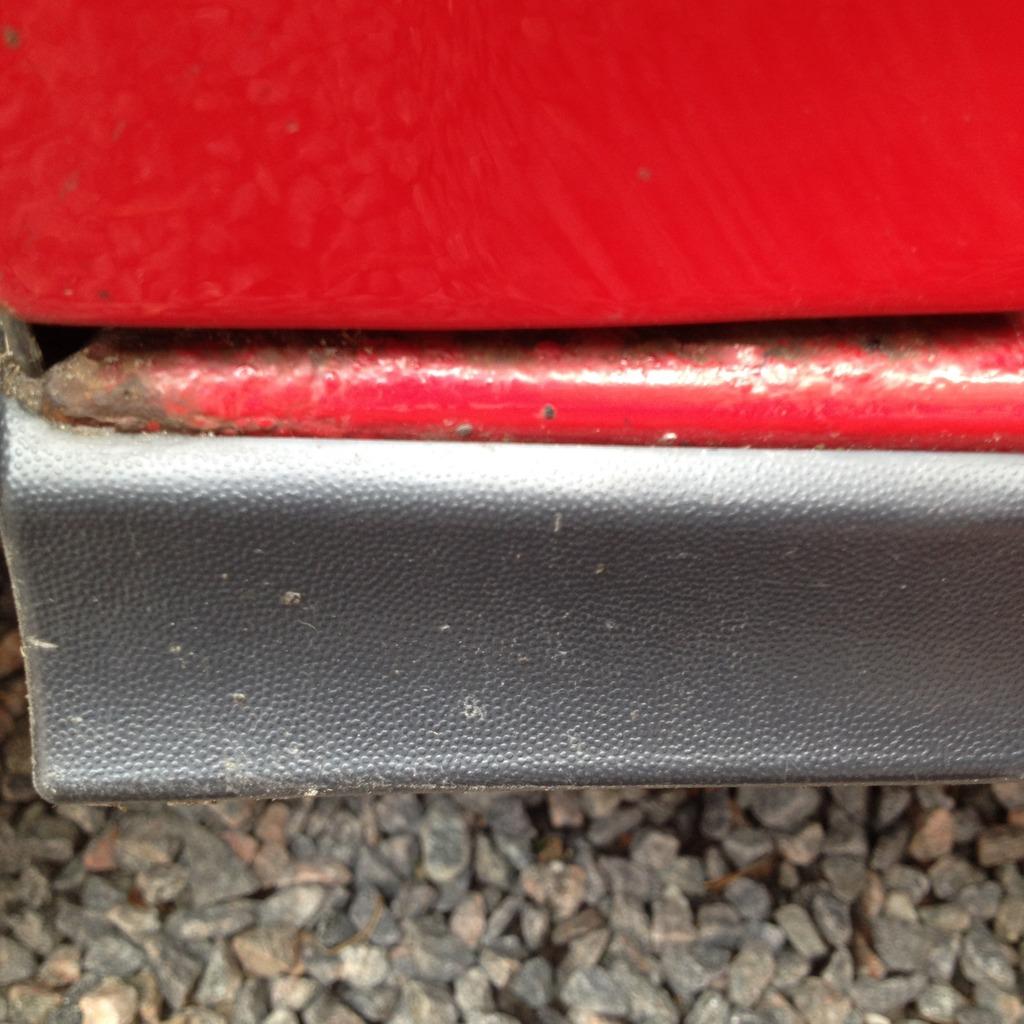

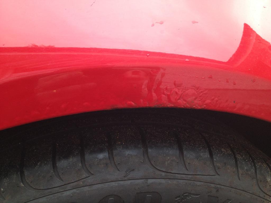

Offline Gmac
  • -Given: 30
  • Posts: 213
« Reply #576 on: March 24, 2016, 03:14:35 pm »
pics of where the wing meets the sills... passenger side first..

Did you not get a piccie of my new baby?
Mine are being done next week .......sills are a nightmare as they are classed as cut and fold and has a diff warranty and a get out clause!!!  :scared: They did ask about FSH but as mine has that it wasn't an issue and technically the car doesn't need it  :smiley:

You will struggle trying to get the sills done by Vw foc.....
German tartan= jazzy Gti trim
 Matching colors = tornado red Gti plus misano red rs4 :)
I am fine busy with work though leaves me little time for much else :(
Offline Ditto
  • Posts: 155
« Reply #582 on: March 28, 2016, 10:15:26 pm »
As said, you can get the sills done FOC. Don't accept anything else...
A 12 year corrosion guarantee is what it says it is... So long as it's not been modified or repaired beforehand it "should" be covered. Most dealers acknowledge this as a common defect too! The VW bodyshop I went to said they had 10 Mk5s in that week for wings, most of them having the sills done too!
