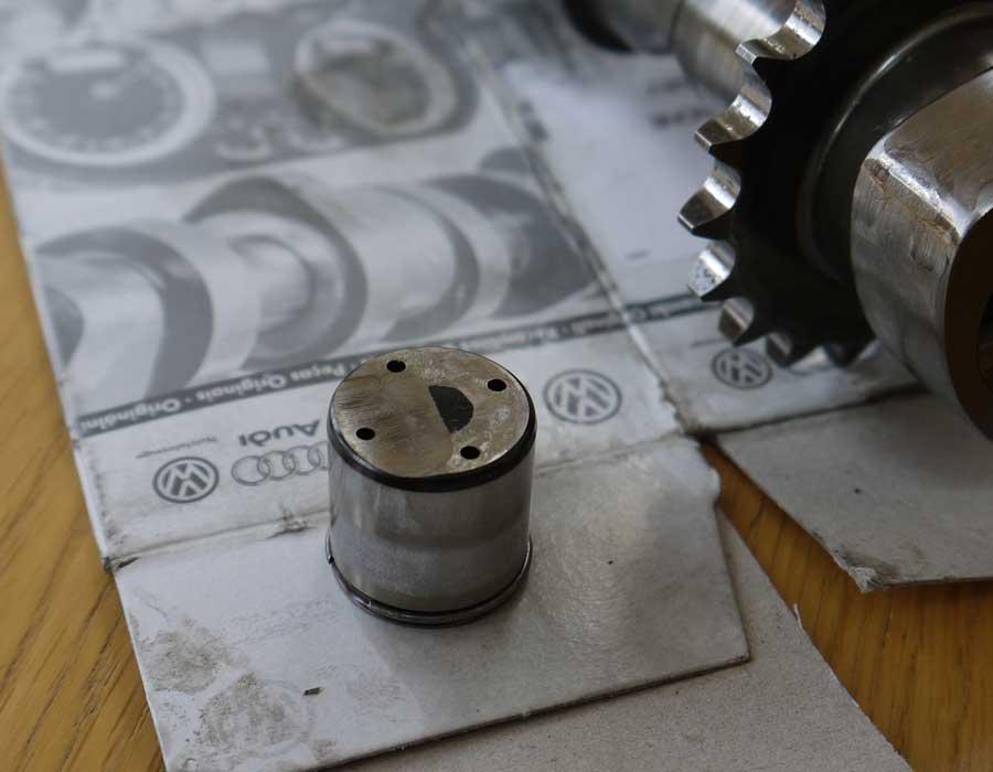

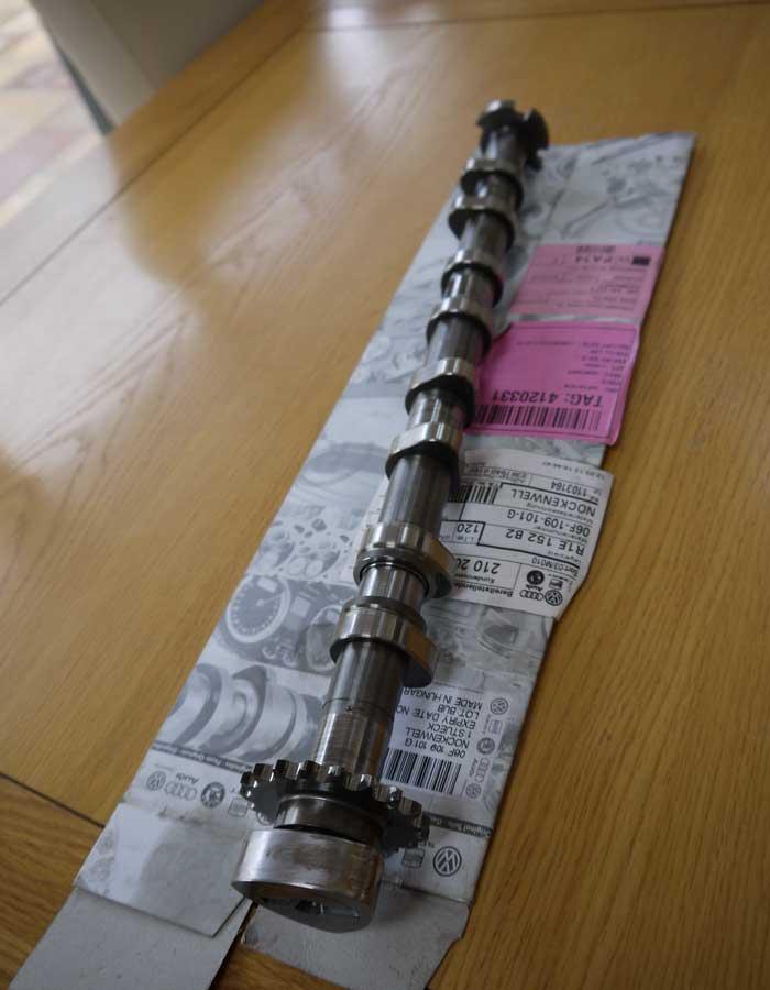

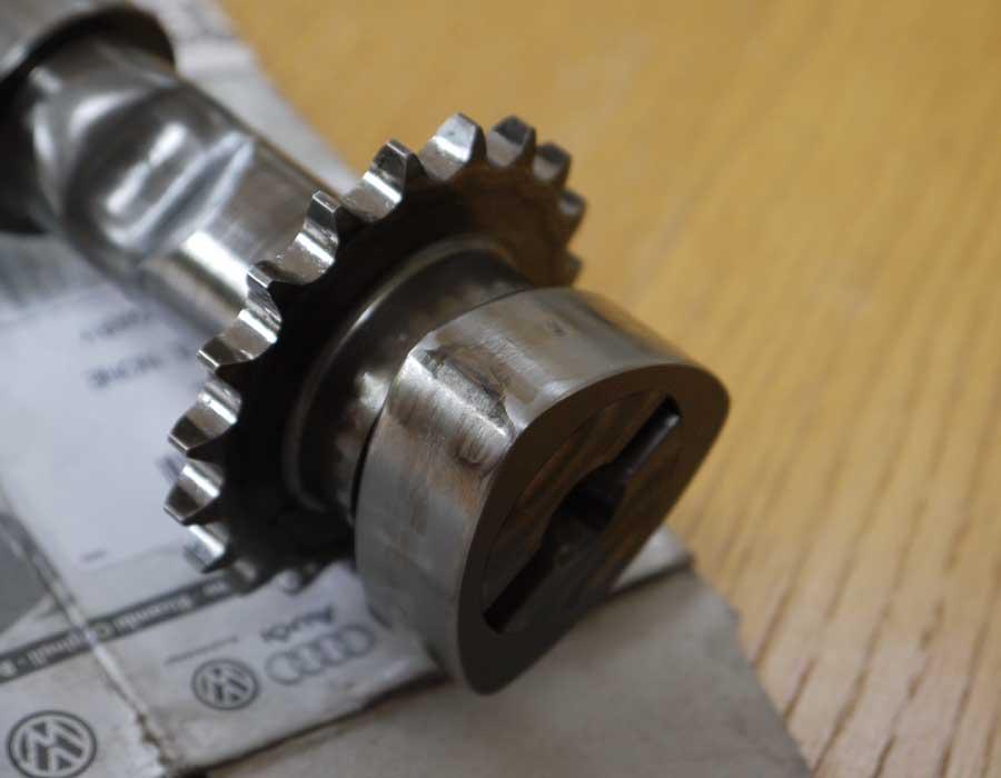

Few Updates
New CamShaft
65k miles and 2 Cam Followers later, thought it would be a good idea to have a new CamShaft after seeing the state of my CF after just one track day and about 1000 miles.
You can see the damage on the end lobe caused when CF disintegrated previously and hpfp came into contact.  Should have changed it the first time but the Shaft looked OK then, cost  £255 + 3hrs, gaskets , sealant,  @ AMD.

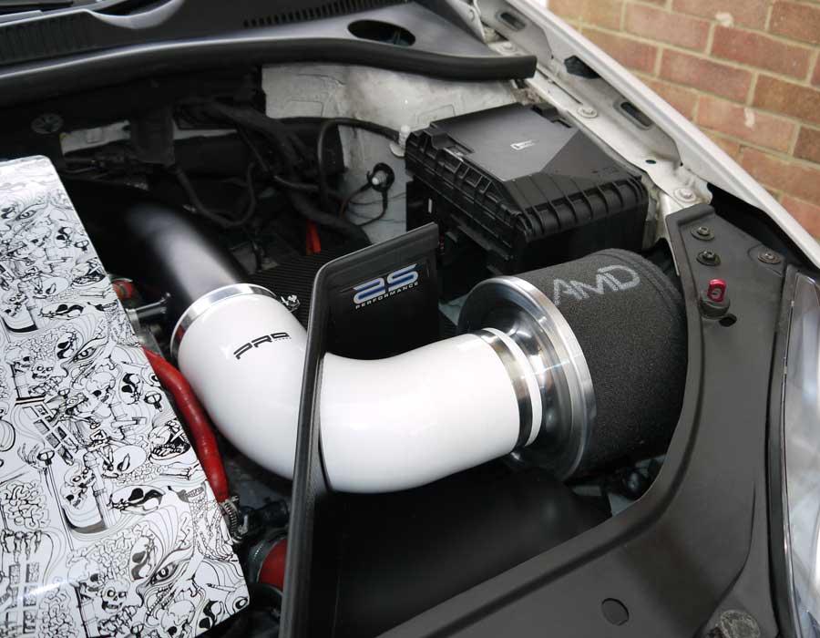

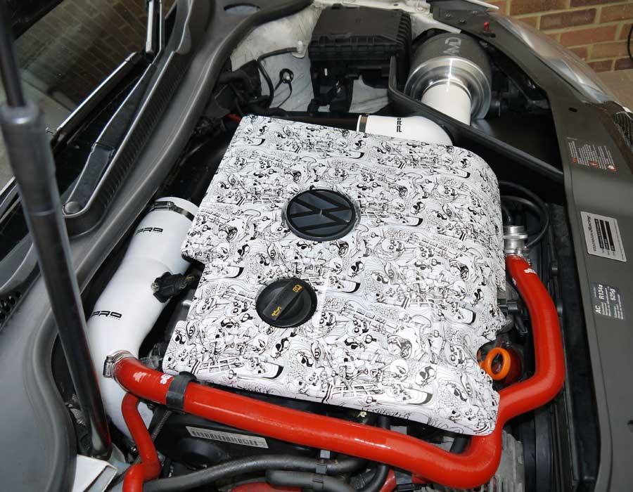

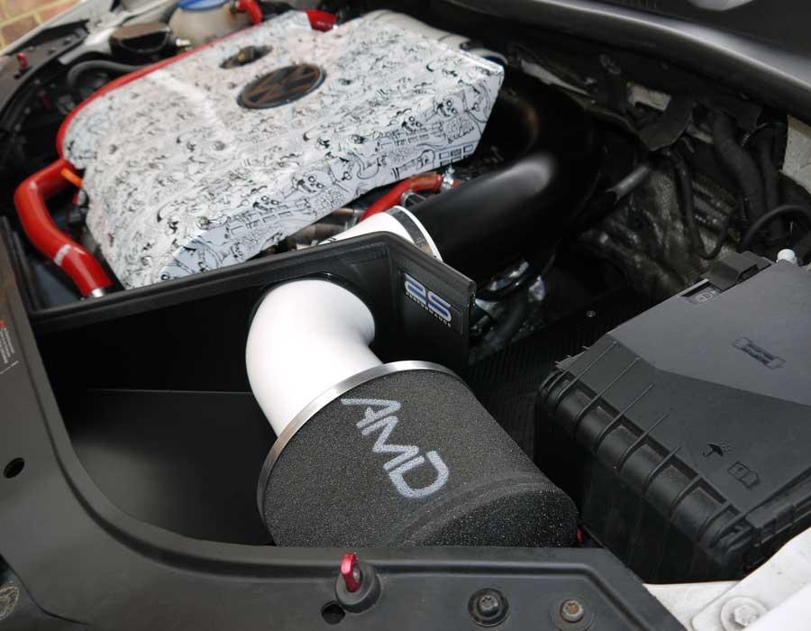

AMD/AS Induction kit with Heat shield
AMD and AS Performance have produced this Induction Kit, looks well thought out, proper heat shield that works well to channel the air through the front grille.
90mm pipe work, 10 colours of Silicone Hose available, with nice smooth flow.
I’ll get some GoPro footage from Goodwood Trackday soon and compare it to the Forge TwinTake I had on before.
