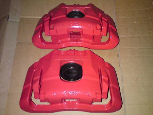

Where are you based? I refurbed my own R32 calipers they are pretty easy to do.  Split them in half by removing the 4 bolts, you can clean the aluminium block and piston by hand and with mild cleaners.
I had a friend shot blast the blue section with fine blast, i then cleaned with alcohol based panel wipe and handed them over to the powder coaters, the colour looked almost day glow pink but once baked they turned out a lovely signal red.  Most powder coaters will also shot blast and the total job wont cost the earth if you do the prep work i.e splitting them.
Rebuilding is slightly harder, you need a vice and something to prevent marking i.e softwood block, the trick is to secure the painted section and bolt the alu caliper back on, a good pinch with a breaker bar is enough torque to hold them together, you dont want to strip the threads.
dont forget new stretch bolts for mounting them to the car.  simples  :happy2:

Not wanting to burst any bubbles but that pic just looks like the whole caliper has been painted, the pad gallerys in the carriers should be blasted and etch primed and masked off to give good operation without corrosion.
I would say if you are going to split your own calipers then ANY machined surface needs masking up - just like OEM.
I would be also suspicious of any piston housing thats been sat at 180-200 degrees in the powder coaters oven for 20-30 mins.
Thats a dry prolonged heat, on a fairly skinny rubber seal thats designed to get hot but whilst immersed in oil, indeed prior to fitting the seals should be immersed in a wetting agent prior to fitting and then reassembled with lithium grease.
You cant really say "well it should be ok" when it comes to brakes....
