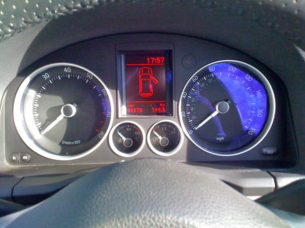

Hi all, have a 2004 GT TDI.......that all i know. lol I have the standard clocks, but want to replace them for the one pictured below.....
How do I tell if these will work in my car?

AS a rule of thumb you normally that your cluster part number which for a mid line will finsih 96x with your car I think x will be 1 or 2 you then find clocks that end 97x which is the highline version.  It is obviously a bit different when moving from a TDI to GTI clocks so Im not sure if this logic will follow.
But the pic of the clocks youve shown are already fitted in a TDI and an early one like yours I believe so it should be fine, but you will need somone with vag commander to do the coding switch.  Also worth checking where the current owner had the clocks coded and what age they are as the immobiliser were changed in 2006 to a harder encryption type.

Those clocks have already been retrofitted into an early TDI so should be the early immo type. Just check with Ollie to be sure. As long as the part number ends in 970,971 or 972 then your fine. Although I don't think R32 clusters where older than 972.
All you will need is someone with VAG K+CAN Commander to do the swap. Darren (Morty),EddieNL and I have all got it , just depends on where you are.
The swap is easy and takes 5 mins  :happy2:

Yeh if thats ollies set of clocks then he actually has a 1.6 petrol and I fitted the clocks for him so know they will go straight into an early car :happy2:
