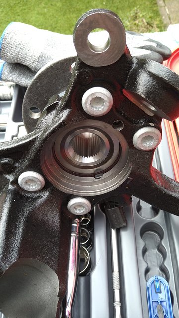

« Reply #12331 on: April 09, 2022, 04:32:50 pm »
Did 2 of these.
  • -Receive: 801
  • Posts: 13443
  • My Ride: https://www.mk5golfgti.co.uk/forum/index.php?PHPSESSID=a9nkqglvdeom16r4ojbreeaodq&/topic,19740.0.html
« Reply #12332 on: April 09, 2022, 05:18:14 pm »
Did 2 of these.
What brand are those hubs?
Offline terrier
  • -Receive: 37
  • Posts: 389
  • My Ride: GTI now gone
« Reply #12333 on: April 09, 2022, 06:58:12 pm »
RIDEX £100/pr
  • -Receive: 801
  • Posts: 13443
« Reply #12334 on: April 09, 2022, 08:34:57 pm »
RIDEX £100/pr
Seem decent quality? I need to change my rears.
Offline terrier
  • -Receive: 37
  • Posts: 389
« Reply #12335 on: April 09, 2022, 09:04:25 pm »
RIDEX £100/pr
Quality is good considering the price No nasty casting marks but thin paint

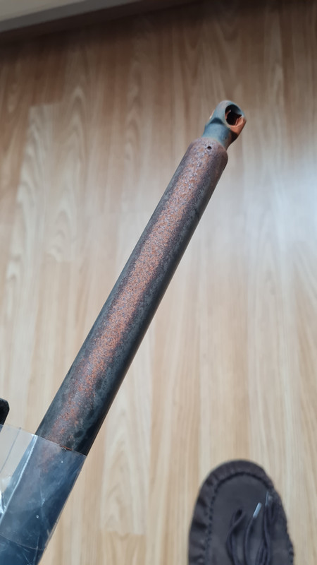

Fitted 2 new gas struts to the tailgate. £20 a pair and worked great. No need to pay oem dealer rip off prices. As you can see, mine have passed there best.

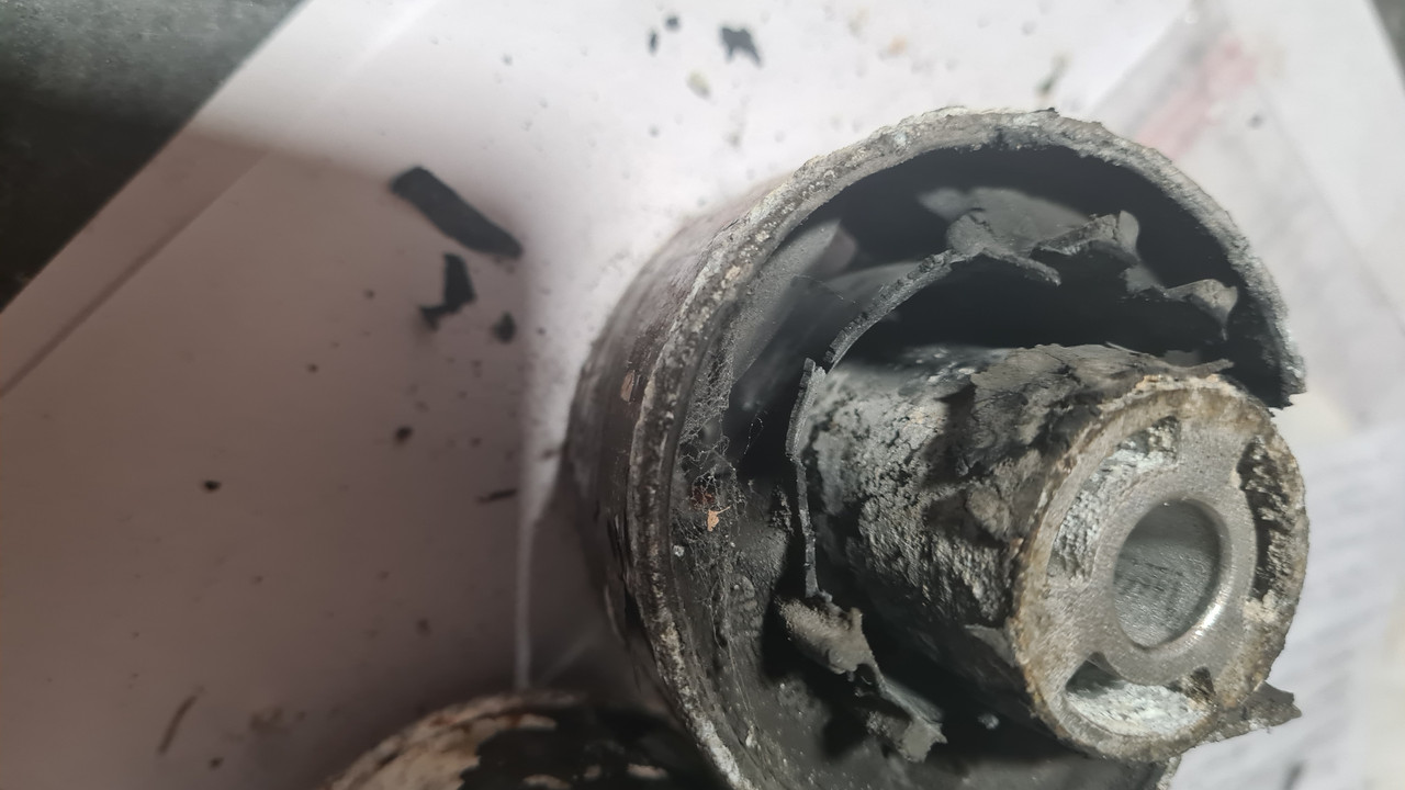

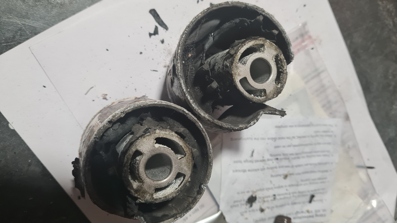

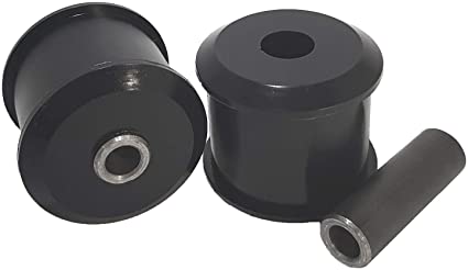

Been noticing that the GTI has been a little twitchy over bumps and motorway driving at times.
The only thing left to do on mine was the rear trailing arms, so bought some PSB poly bushings and new bolts from TPS and attacked them at the weekend. Quite an easy task thankfully with a hack saw through the void to cut the outer collar carefully for removal
Glad I did them as both bushes were shot with the rubber not attached to the central bolt tube on either of them......both sides removed and changed in three hours, with the car driving much better now.
No more issues and recommend people look at theirs.
Are the Moccassins pattern as well?
Yeah mine are like that as well.  It's amazing how much a rotten rear end can affect the steering feel.
Offline mjmallia
  • -Receive: 47
  • Posts: 533
« Reply #12343 on: May 04, 2022, 09:02:08 am »
It is.............I lost confidence in bends due to the twitchiness..........all gone now

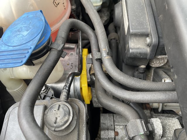

« Reply #12344 on: May 07, 2022, 06:40:32 pm »
Fitted new engine mounts (lemforder) with powerflex inserts. No vibration so far and car feels 100x better, as was running original mounts from 16 years ago. Already had the 034 dogbone upper and lower inserts fitted. Will upgrade the actual dog bone next to the new OEM one
