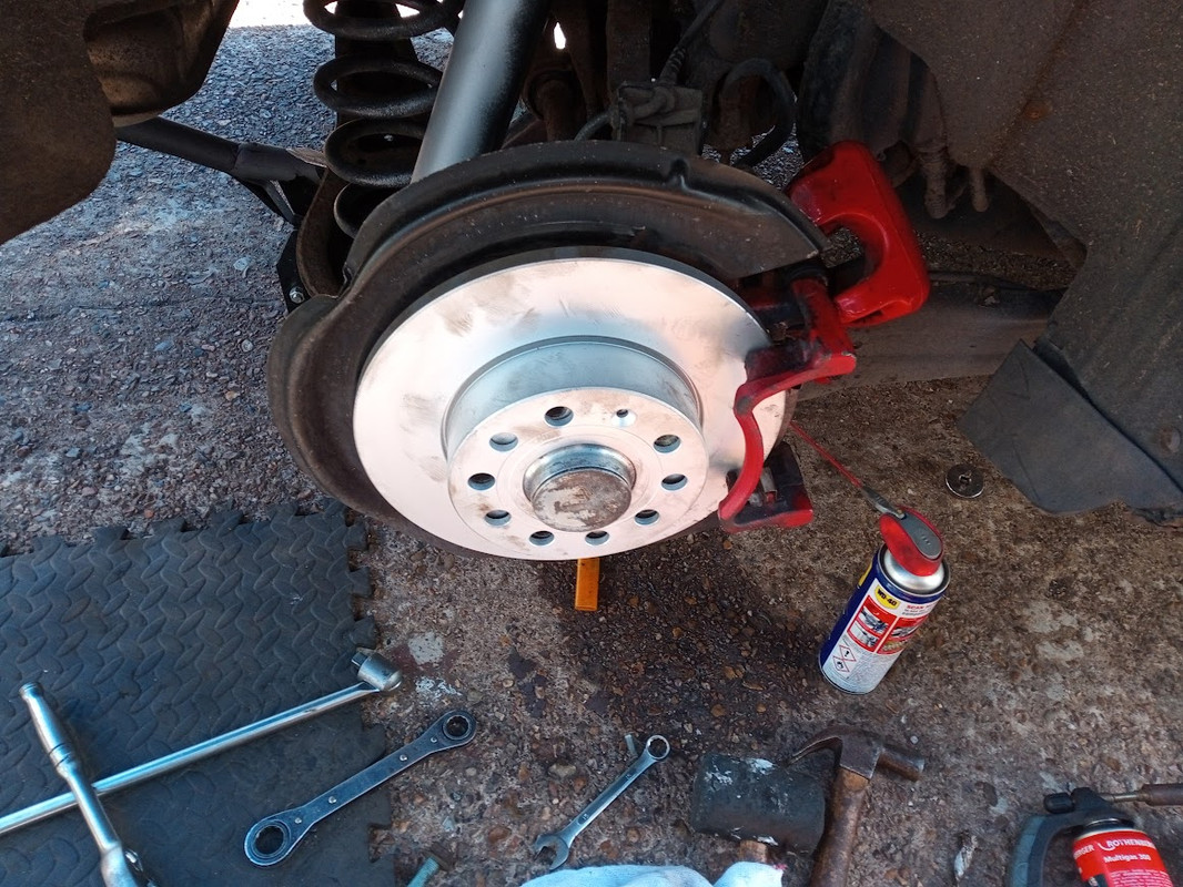

I removed the drivers side rear brake disc but had to use the blowtorch on the outer part of the splined bolts holding in the caliper in place which took about an hour in total to remove the top bolt.  I couldn't remove the bottom one but was able to loosen the bottom enough to adjust the caliper and remove the disc.  I fitted the new one, replaced the bolt only to realise the disc was the wrong size, it was way too small.
I had to heat it up again to remove the bolt and go through the whole process again, but this time it was harder as the splines in the bolt were rounding off but I did it eventually.  I then replaced the disc with the old one and put the top bolt back in but didn't tighten it too much. In total, about 5 hours wasted, well not entirely as I removed, cleaned and greased the slider pins on the caliper and as the bottom one was very stiff.
Went online to return the wrongly labelled Mintex discs, ordered two new caliper bolts and a caliper repair kit as both rubbers were torn and.  Gutted really as 5 hours in the hot sun and achieved very little.  Lesson learned, check ***ing parts before removal.

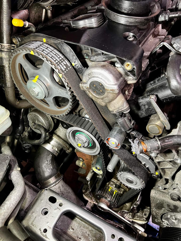

Hit the five year mark and had the cambelt/pump done by a specialist and also a mate.
I swear the car feels more responsive now, or I had got used to the crap Honda Jazz courtesy car  :grin:
All genuine bits on, so have peace of mind again

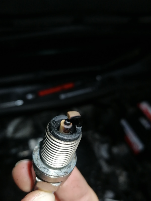

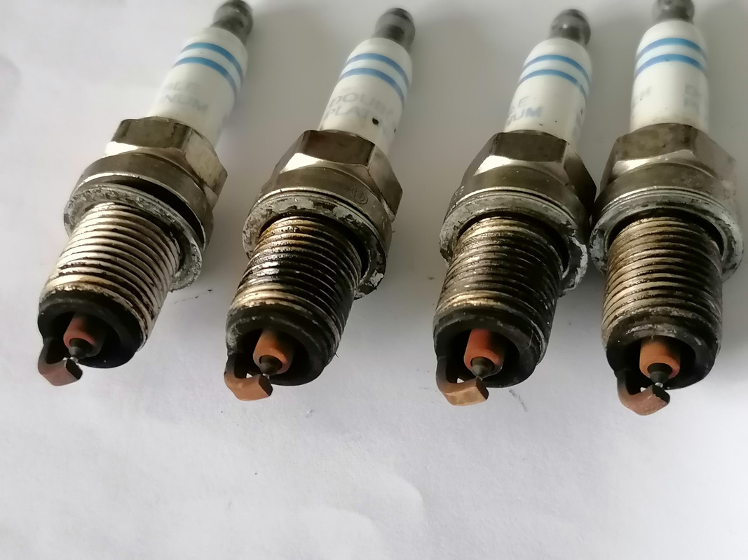

Replaced my Spark Plugs this morning, which according to the service book have 29,000 miles (46,670km) on them.
50 Shades of Orange  :grin:
For reference though I have been running octane booster for the last 5000km, as there's nothing above 95 octane in the Rep. of Ireland, so that's probably why they've turned to orange from yellow since I last checked them. Interestingly though there's none of that sticky carbon on them that was there last time I checked them, as seen in this photo:
Replaced with some NGK BKR7EIX, engine feels calmer and sounds less angry now, dunno if it's placebo :smiley:
