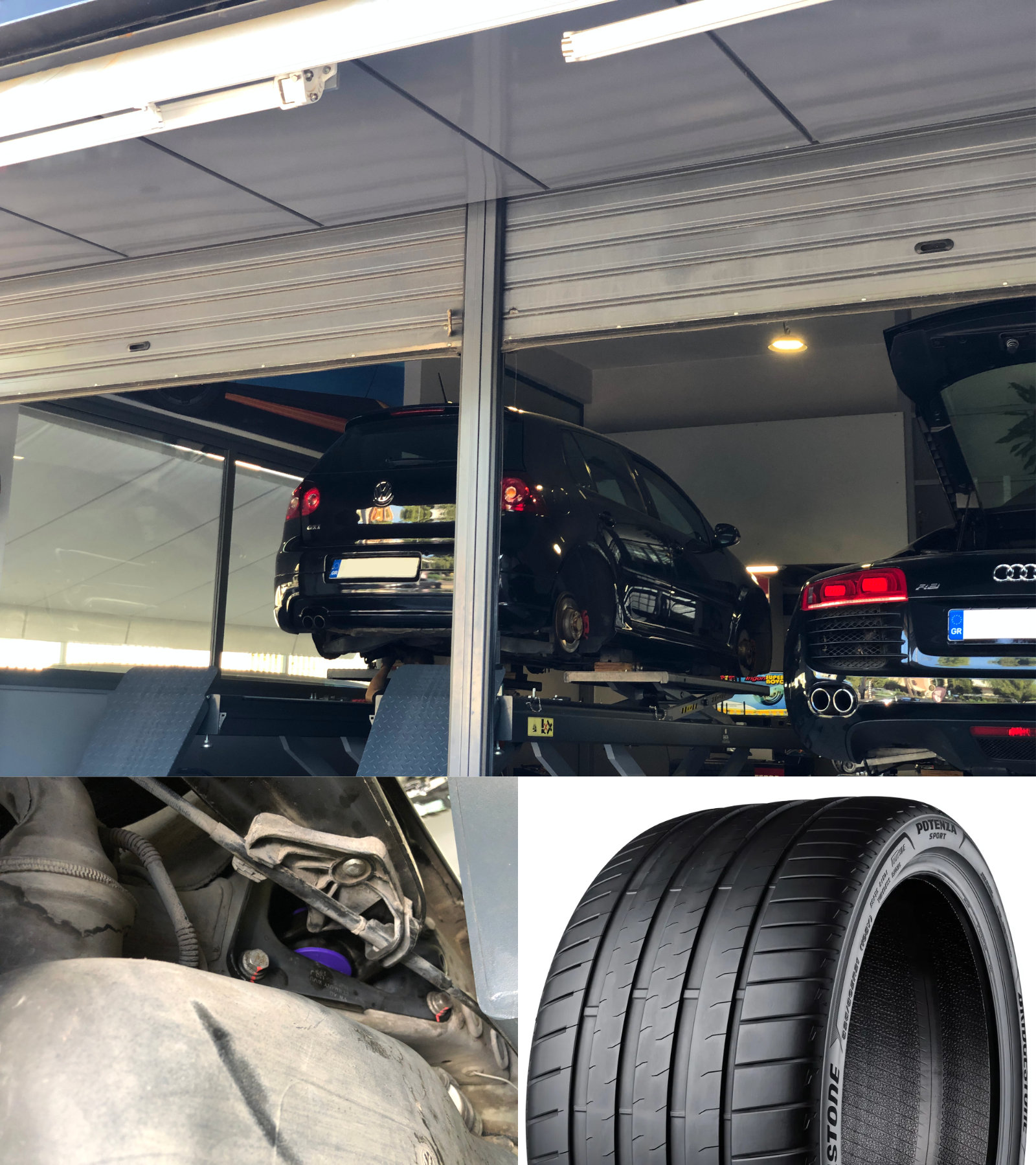

- installed new rear powerflex trailing arm bushes
- installed new front s3 oem control arm bushes
- fitted bridgestone potenza sport tyres
- full alignment

what difference can you feel with the trailing arm bushes?

I could sometimes feel some lateral movement in the rear, more pronounced in higher speed turns or direction changes.
The rear feels more planted now; helps with confidence feeling.
The car has 260k km, first time im changing them.
hope that helps.

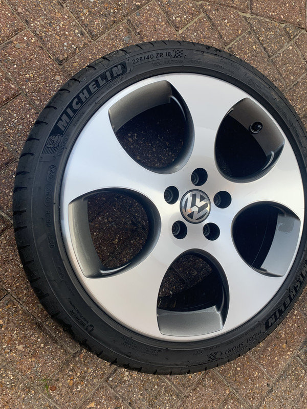

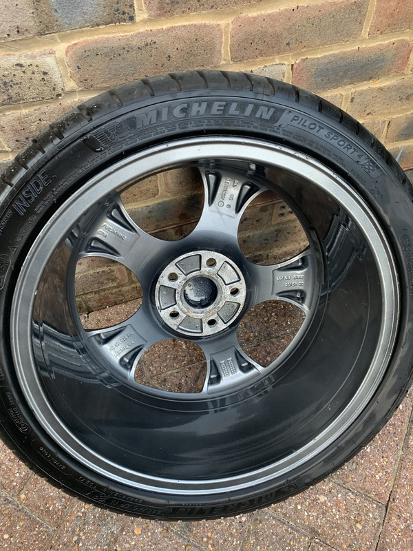

Took the front arch liners off today and cleared out some debris, amazing what accumulates in there and no surprise it rusts. Fortunately I found someone had already been there, removed the foam and had sprayed some wax. No rust so very happy and still on original wings. Also cleaned the wheels and sealed them ready for winter.

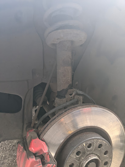

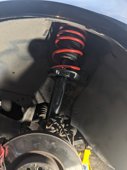

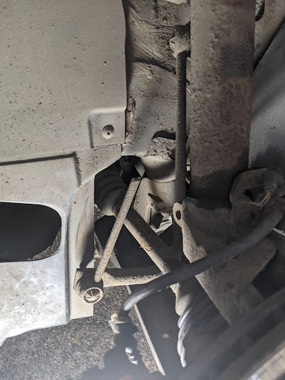

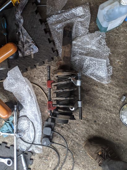

Changed the gear shift linkage to an adjustable short shift, swapped out the rear springs for Mk6 slightly lowered rears and the rear shocks replaced with Drexler G-Force as I wanted a basic Gas shock. I've fitted B8s, coilovers, H&R springs, Eibach combinations over the years and have felt let down the ride being too harsh or firm for me.
Also built up Drexler G-Force Front Shocks with Mk6 lowering springs and new top mounts with cleaned and regreased bearings.
Hopefully will fit over the weekend.
Changed passenger side wishbone bushes for PSB poly ones, with the anti roll bar bushes and others to be swapped out.

Replaced offside front shock with Mk6 Spring and Drexer G-Force Shock, hopefully fit the drivers side tomorrow.
