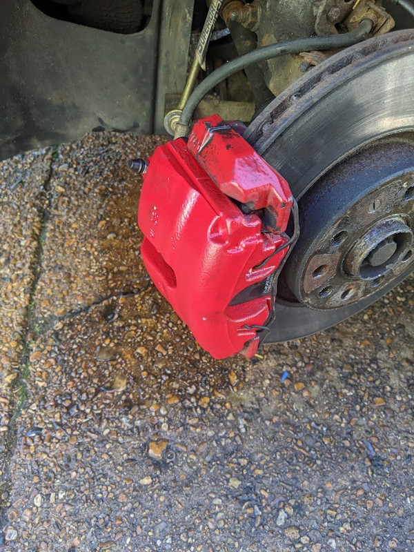

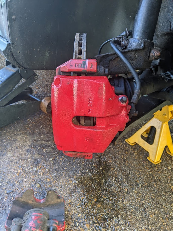

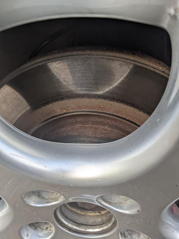

Changed the front brake calipers last weekend as I snapped the bleed nipple on the drivers side as it was rusted in.  I noticed that when I changed the pads and discs before there was a rust line where the pad wasn't making a firm contact to the disc, but these refurb ones sorted the issue and improved braking feel and stopping.
Since I'm not tracking it and tend to drive more sedately these day, I saw no need to upgrade them.  I will order some brake hoses though as the ones I ordered has the wrong fitting.

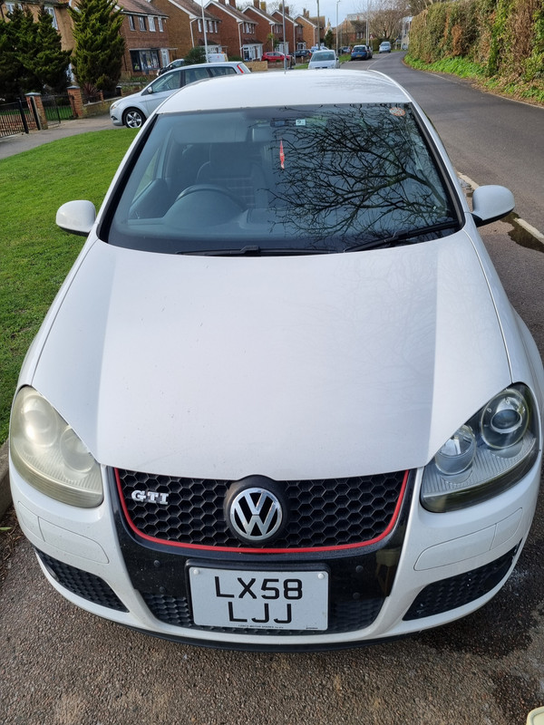

Re headlights above, last time I tried a restoration kit the results weren't great, hence advisory. I was going to use a local guy who has excellent reviews. His website said prices from £45 per headlight but when he came out to look at the car yesterday he quoted £75 per headlight which I decided was too much for me at the moment.
So I've had another go with a holts restoration kit from euro car parts £15.99. Only done one side so far but I'm quite happy with the result this time. There are still lots of little scratches but from a distance it looks pretty good.

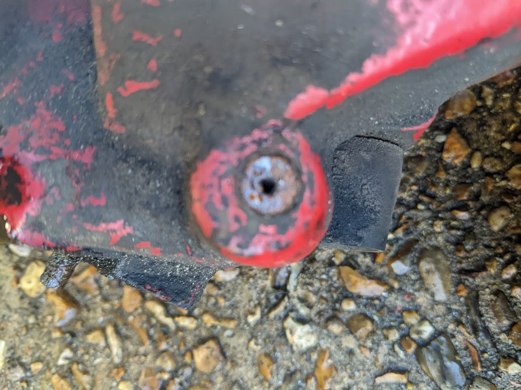

dreaded STOP warning this morning. Brake fluid level dropped enough to trigger the warning
 reservoir very low so topped up and bled both front calipers  Nipples in a shocking state
 Replacement titanium nipples ordered x4

 Replacement nipples
