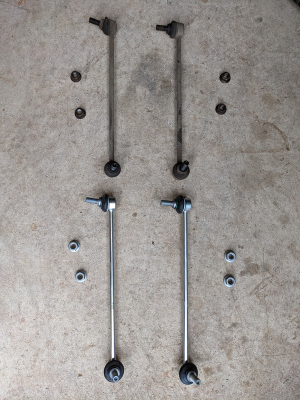

Replaced the front drop links today.
The fronts were easier to take off than the rears. I had to cut one of the rear drop links off, but I was able to get all of the nuts off the bolts for the fronts. There was one tricky nut, but some WD-40 and a 380mm breaker bar got the job done eventually.
Getting the new ones on wasn't hard either. I jacked up both sides of the car at the same time, as I heard it takes the stress out of the anti-roll bar and helps with getting the new drop links in to position.
It was fairly straightforward overall. I think I'm getting better at dealing with rusty bolts though, so that's helping a lot.

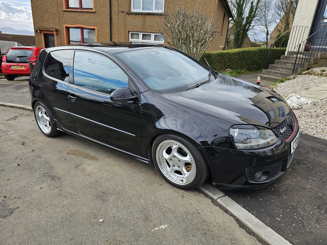

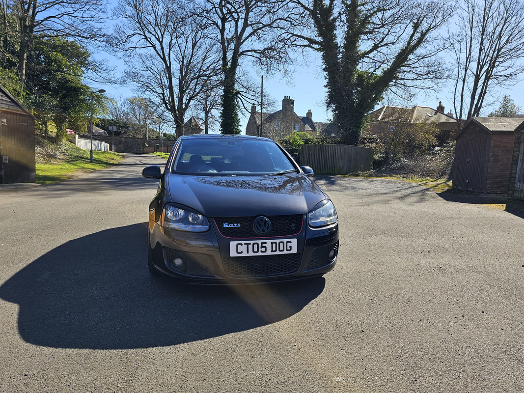

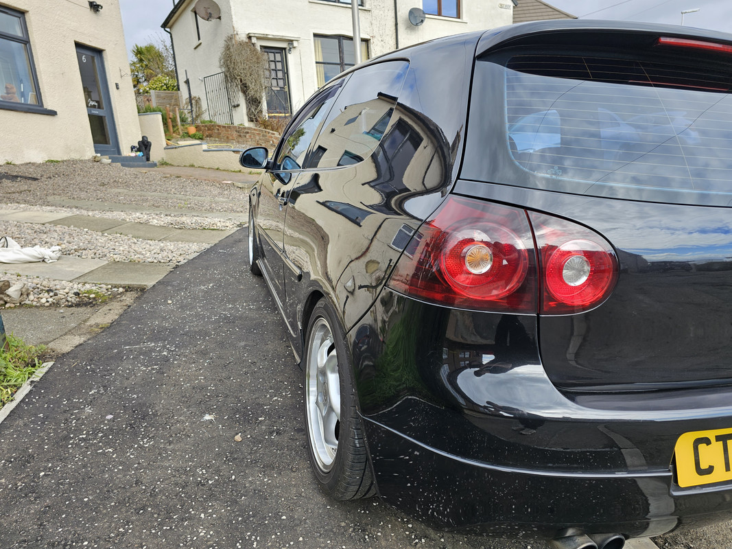

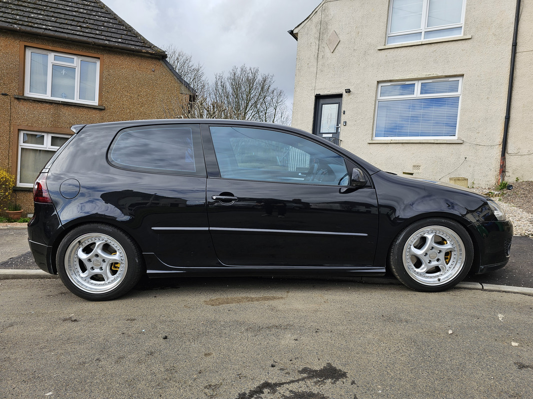

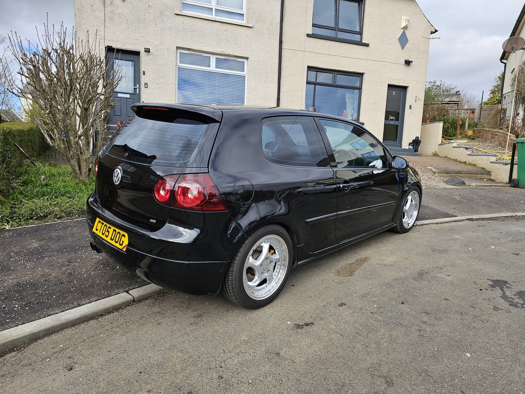

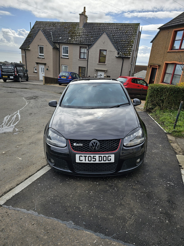

Quick machine polish today

Looks stunning  :congrats:.
One day I'll get round to doing mine.

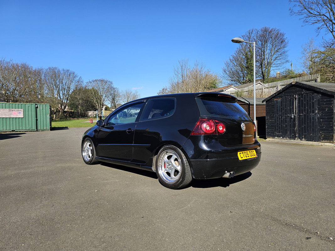

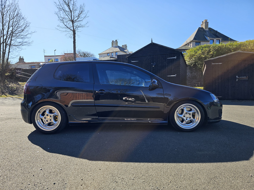

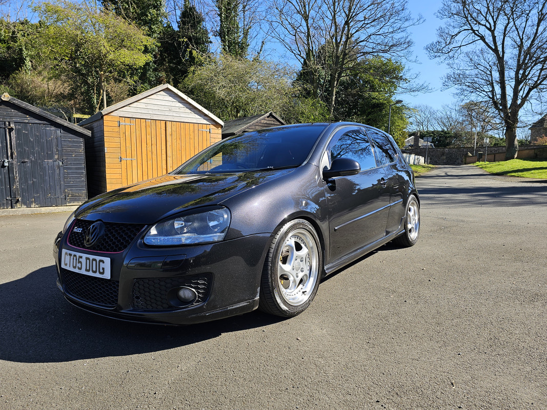

Yeah Not bad :smiley:  Do like the wheels

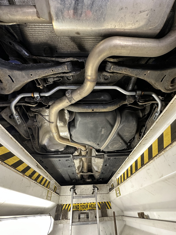

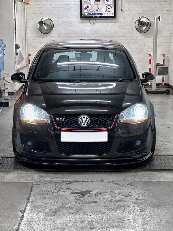

Gave the old girl a wash and fitted a TRC front splitter and rear Whiteline ARB and links. Was a productive day and looking forward to a bit less body roll.

Gorgeous mate loving the front lip been debating to get one myself think I will now after seeing this. I wanted the side skirt extensions but I can't see them anywhere

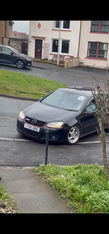

Scary stuff lol
