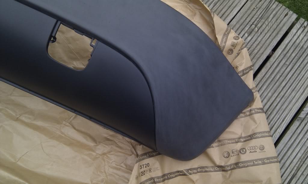

So I picked up an OE GTi rear lower valance today from my local TPS.  On my way home I stopped in at a body shop I have used in the past, for a quote on painting.  After having to give my entire life history to the rude, arrogant and obnoxious receptionist she sent for the estimator.  Well to say I was shocked by the prices quoted is an understatement.  :stupid:
Quote #1: Prepare the textured surface with high build plastic primer then paint - £128 +VAT (he did say that it would probably flake off though).
Quote #2: DA the surface to remove the textured finish then build the surface back up with filler/primer then paint - £240 +VAT!  :surprised:
Question here is do they think I'm a mug or is that the sort of price I will have to pay?  Also is there any way I can prepare the bumper by sanding it etc?

Quick update:
The guy at the bodyshop advised me NOT to try and sand the bumper myself as when you sand the plastic it creates fibres that will ruin the finsh.
Despite this I thought I would have a bash at prepping a small part of the valance so I hit the section hidden behind the number plate with my random orbital sander with 120 grit paper, then a quick finish with some wet 'n' dry!  And the result, perfect finish ready for primer/paint.......I defo think they were trying it on.

All it needs is a red scotchbrite to key the surface of the black textured part, some plastic adhesive primer sprayed on, and then two pak primed to fill the texture. Once baked off wet flat with 800 and grey scotch. Viola! All ready for paint. I did this to my sideskirts and it won't ever peel off. Not if it is prepped properly...
I think 128+vat isn't a bad price considering the time needed to do the job. Your looking at about 3 hours work + paint and materials so if you work it out at 30 - 35 per hour your not far off. If you could get the top bit don aswell that would be a touch...as all it needs is a quick key up (providing it has no damage/deepescratches) and blown over at the same time as painting the lower bit...
He is right about the DAing of plastic. It goes fluffy so it is quicker to scotch it up.

The guy mentioned red scotchbrite today.
The original quote was not for all that process, it was a straight forward spray so the finish would have been textured!  :sick:
I have hit the entire top part with 120 grit on a random orbital, then 500 grit wet n dry.......no fluff, no fibres, just a perfect surface ready for prime/paint, imo.  Once its fitted I will post some pictures.  :happy2:
