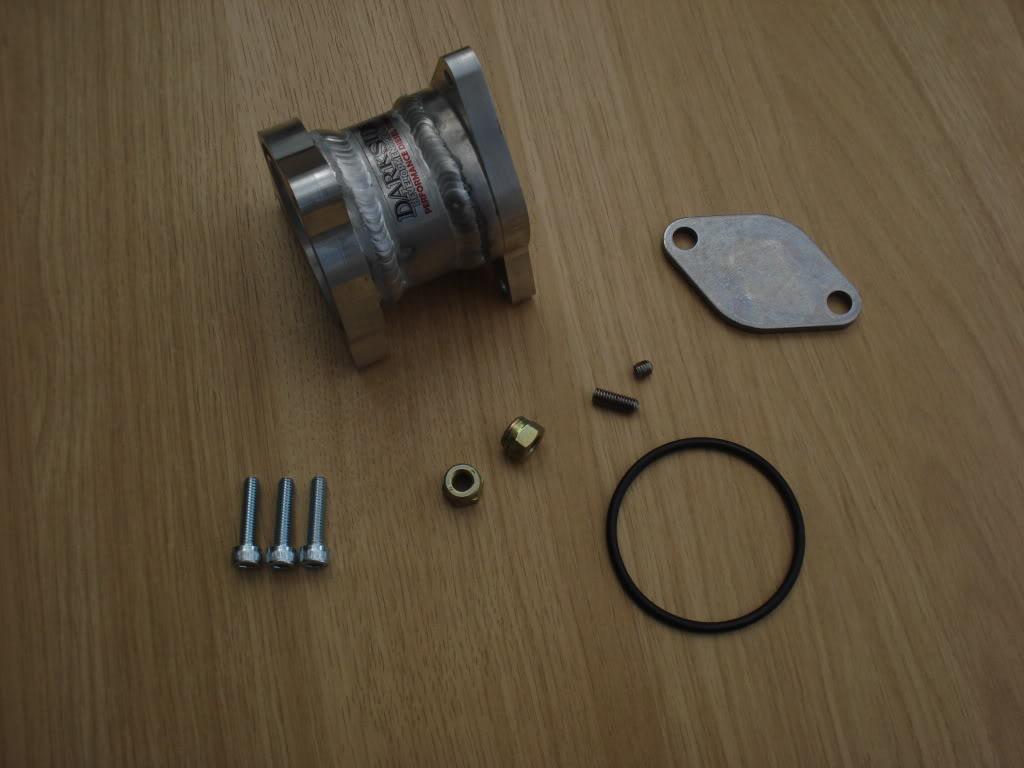

Darkside Developments EGR delete kit arrived Saturday -
Had a spare couple of hours last night so I had a crack at fitting it.  Not as easy as it looks, especially when trying to undo the bolt at the back of the unit, space is extremely limited.  But after a lot of patience, success -
I OE valve was a bit crusty but not as bad as some I've seen -
First impressions, the car doesn't feel as sluggish when pulling away and no CEL.........yet.

« Reply #57 on: August 30, 2011, 08:42:13 pm »
Hiya mate
Why have you done this??
I've seen a few people do this but unsure why, is yours a 140/170 mines a 170.
My is only the PD140.
During the first 20-30k the EGR will perform efficently, but when they get clogged up with crud (like mine) it can affect performance and economy due mainly to restricted air flow.  You could remove your EGR and soak it in petrol or carb cleaner, then refit it.   But it will get caked again, with the delete pipe in place you get a smoother air flow which will stop the nastiness.......

Pagey there is a little rubber pipe that goes in the side of the EGR valve, what do you do with it once the delete pipe is in place?
Darren :happy2:
Offline vRS_Pagey
  • -Receive: 59
  • Posts: 1577
Re: Golf GT TDi
« Reply #59 on: August 31, 2011, 08:02:37 am »
Darren :happy2:
That's a the vacuum hose which is no longer required when the delete pipe is installed so it just gets blanked with one of the spare bolts.   :happy2:
