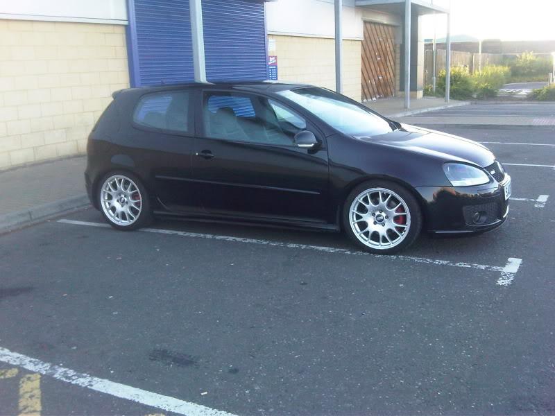

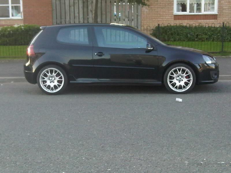

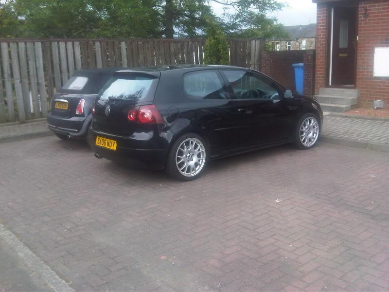

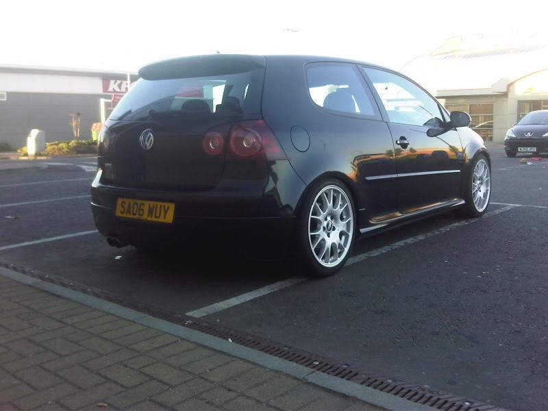

finally got the coilovers fitted! thinking they may possibly be to low, when i go hard into a corner i get a bit of rubbing :( anyway to cure this without raising the height? heres a few pics...
before.....
after......

Looks good. Rubbing solution may be to add arb's. I used to have the same problem with rubbing mostly at the rear tires, but it went away with just a rear arb.

ARB's are good and help a lot.
Is the rubbing coming from the front or rear?
If it is from the front, have you done the arch screw delete mod?

Yes do Arch screw delete mod, but also what tyres are you running? Any spacers? Shouldn;t rub with standard wheels on... or are they not ed30 wheels?

Is it just the wheels that are rubbing? when I was on coilovers wound down all the way I found that the subframe would catch on full lock before the wheels.

Looks good but you may wanna block out your reg on those pictures  :laugh:

thanks for the comments...not got a clue what brand they are i bought them in the for sale section on this site off another member.
im running standard 225/40/18 tyres.
they are not standard ed30 wheels they are BBS CH rims.
the rubbing is coming from the front when i am turning and hit a bump or turning hard into a corner. i really dont want to raise it up anymore because i like the stance as it is.
i will try looking for the arch screw removal on this and try that  :happy2:
why does everyone blank out the regi on pictures? never quite understood this because people see your reg when u drive past them so is it not quite the same???

lots more scammers on the internet i guess than out on the streets?  :signLOL:
there's quite a bit of info you can get about someone from their reg plate, best to cover it up to be on the safe side.
